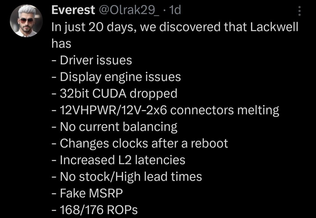

    I saw that. Also the defective cards hit customers issue, something to do with a small percentage of cards being faulty.
    What's funny is most nVidia fans won't even blink at writing this all off as nothing, where if these were AMD cards those same folks would be screaming for AMD to be shutdown and offer full refunds lol. Just look at the list nVidia has racked up in 20 days with the 50 series:

    Oh wow, haven't heard about the clock thing on restarts
    Lackwell, I dig it :rofl:

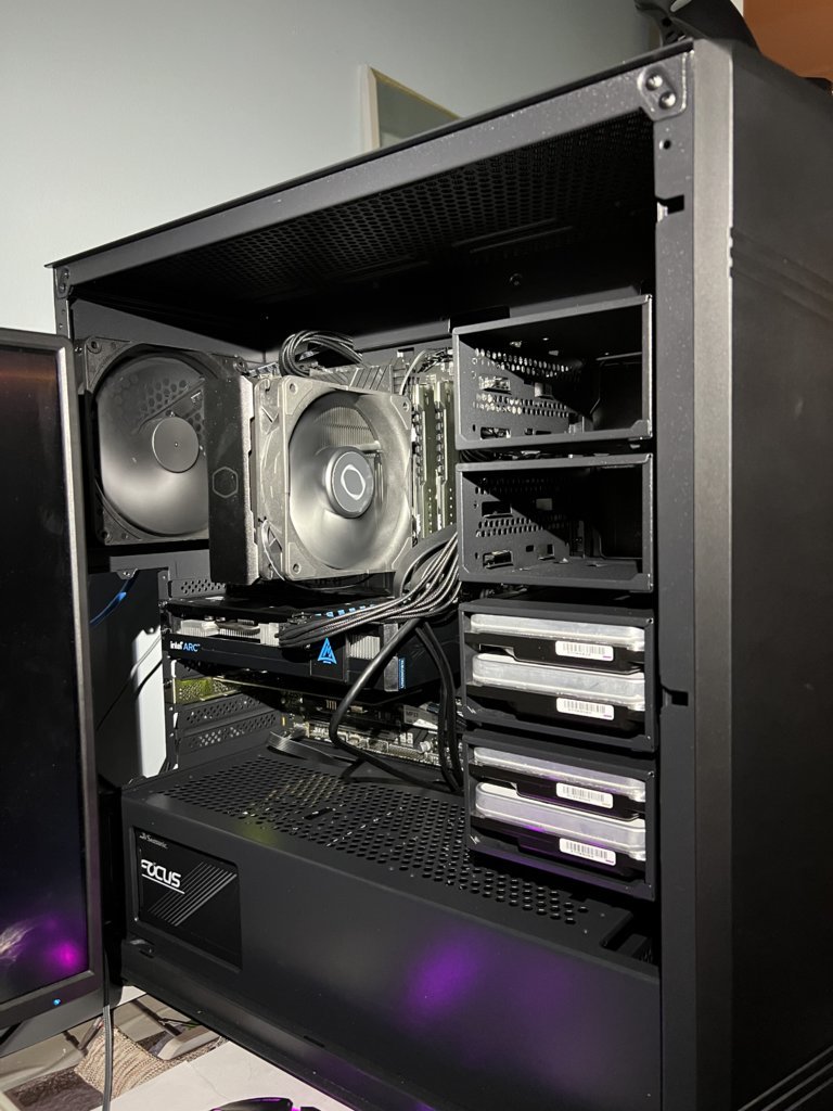

    Had some time this evening to get truenas scale on the new server, but my HDD storage wasn’t being seen when I tried to create a storage pool, I made sure the HBA was being seen, made sure it was flashed to IT firmware, even went so far as to plug a SATA cable directly into the MoBo and no luck. I ended up checking one of the HDD’s in an external enclosure with my main PC and it spun right up. It seems that my PSU isn’t outputting the power the Exos 16 HDD needs to power up.
    I’m using the SeaSonic FOCUS GX ATX 3 (2024) GX-750 PSU so the I5-12400 and A380 should leave plenty of headroom for peripherals.
    Any thoughts? I’ve tried both SATA cables that came with the PSU and I’ve tried both of the ports.

    I think it's more likely the HBA isn't telling them to turn on? (bad connection, faulty cable, etc)

    I fooled with it after work, I used another power supply to power the drives, they spun up, but didn’t show in the disk section of truenas.
    I’m going to try to re-flash the HBA card, I noticed that the HBA card lights are non-functional, so either the reflash will fix it or the card may be bad :notsure:
