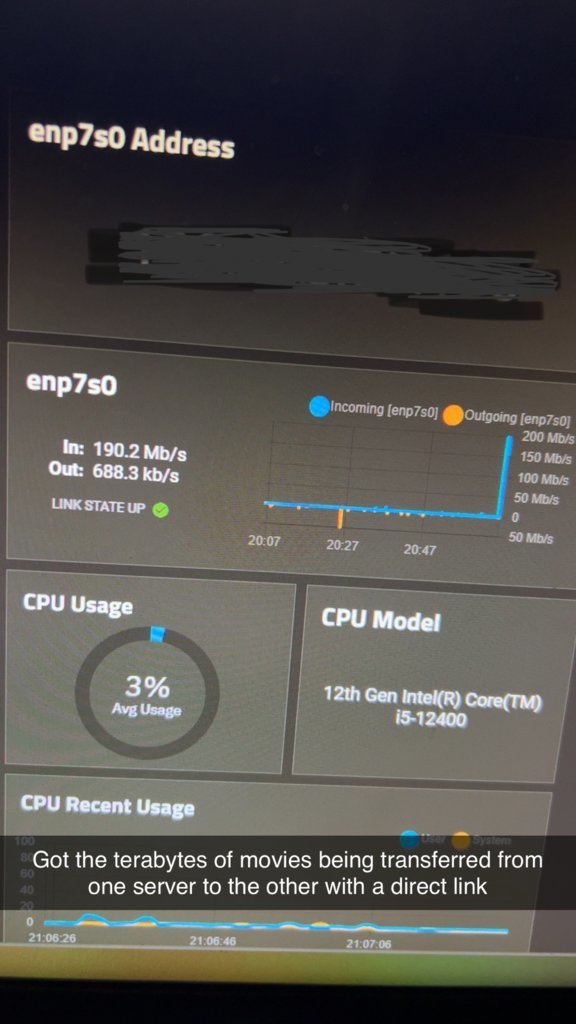

    Got all my apps setup, got my storage setup, started transferring the movies from one to the other, seeing 180-200Mbps on a direct link between the 2 servers so maybe Sunday afternoon the transfer will be done.

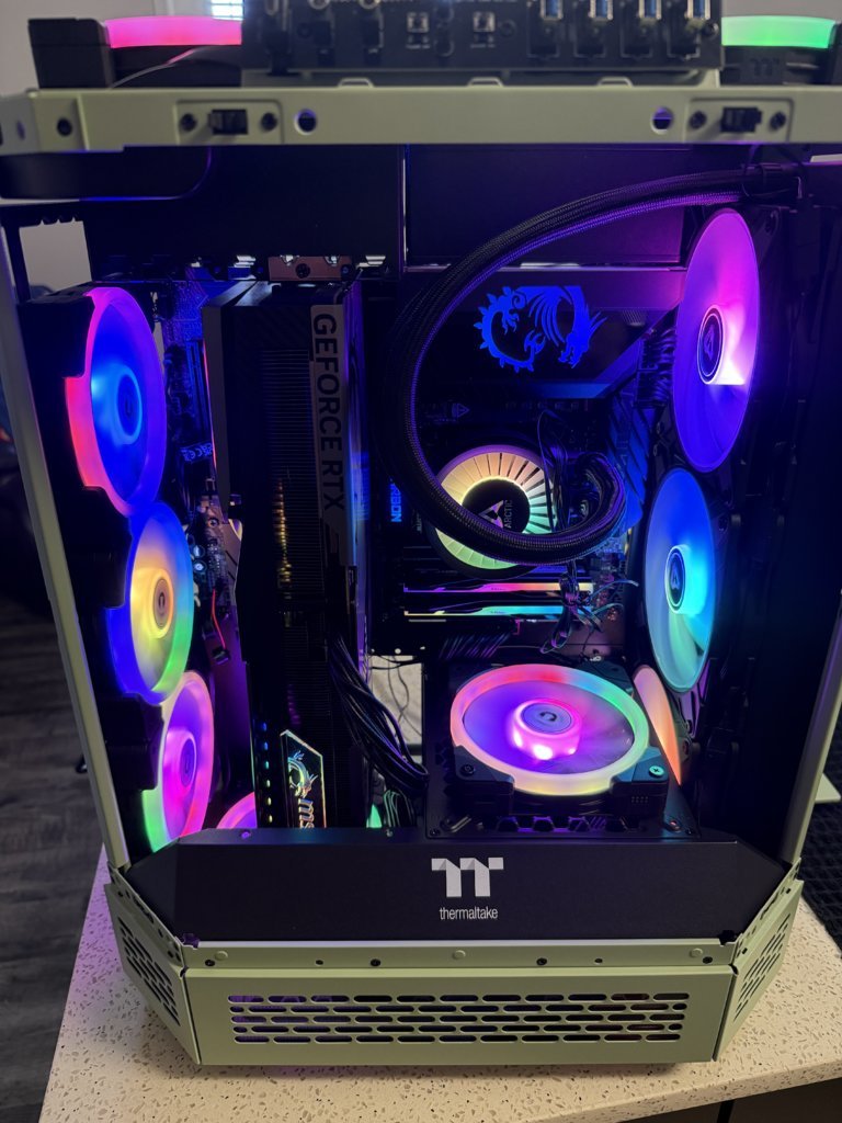

    :cookiemonster: The argb splitter works.
    Also, I miscounted fan headers. They're all in use, so I can't add anymore to the back of the case without a fan hub or splitter. I think 11 is plenty though. :plane:

    Yeah.
    Wow that's a lot of rainbow going on :jpow:

    I'll fix the skittles after I get everything installed and updated.

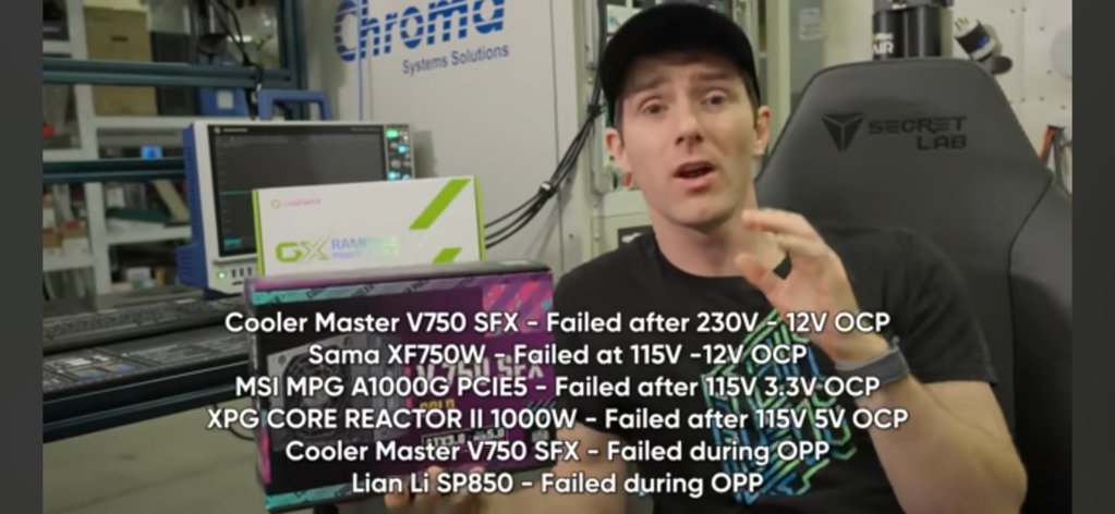

    I'm catching up on some LTT and I caught something. Be a little wary of that PSU. Linus was able to get two of them to go boom while delivering in spec power to them. Now, the MSI only went boom after loading up the 3.3 volt rail, which is used now mostly by your audio chip, M.2 SSDs, and SATA SSDs and HDDs. If you don't run multiple drives, it's probably fine, but that might explain why it was in the bundle deal.

    Rainbow puke is the best puke.

    I'm sure it'll be fine.

    Check out the reviews of Corsair's rm1000x on Newegg. That was a runner up pick for me as it has more pcie and sata ports, but many said it arrived doa or failed within months. I don't think brand choice matters so much these days.

    It's not brand as much as it is source. Most manufacturers are using third party manufacturers for their products and have been for a long time. I'm glad to see LTT commit to testing PSUs even though it won't make them any money.
    I will say I feel like Seasonic is still the best manufacturer of PSUs out there, but their pricing reflects that.

    Cybernetics doesn't test beyond the mandatory ATX 3.1 specifications. Surge load testing is only a recommended test, so they don't run it. Ultimately their goal is to set a better standard than 80 Plus, which they do well. There goal is not to test PSUs for potential realistic failure scenarios.
    Not saying MSI is garbage, but LTT did get two of that specific model to do the magic smoke while staying within the recommended guidelines.
    Something bought and paid for is worth running. I wouldn't return it. I'd run it. I wouldn't throw a bunch of M.2 drives or HDDs in my system though knowing the 3.3 volt rail is a potential failure point.
