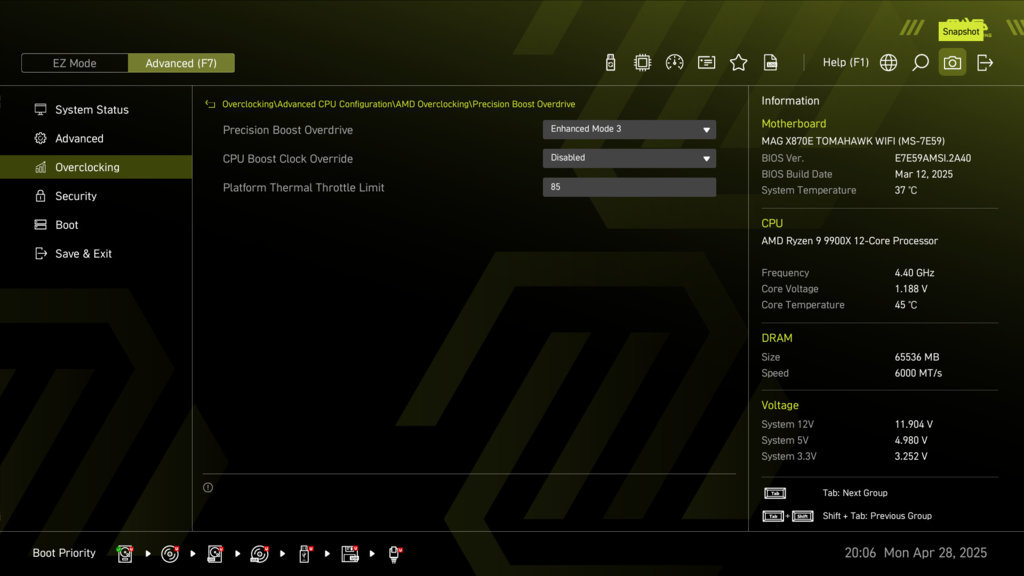

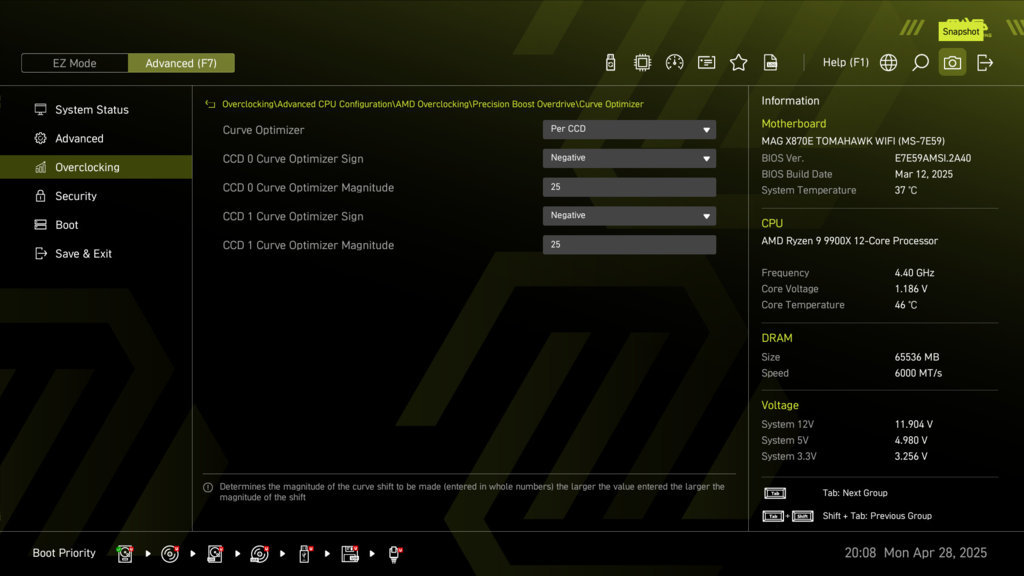

    #6656
    replica9000
    replica9000 Das ist no bueno
    Apr 6, 2008
    #5782
    16,441
    Lake Chargoggagoggmanchauggagoggchaubunagungamaugg
    2019 T4R ORP
    Told myself I was going to stay out of this Menu, but I couldn't resist. Not sure what tweaks the enhanced modes apply, but even with the 85C thermal limit set, the CPU will boost to nearly 5.5Ghz on all cores.
    Undervolting is also tempting. I can still reach about 5.2GHz on all cores with -30 per CCD, temps sit at less than 75C without a thermal limit.
    This is with a Noctua NH-D15 and case fans set to low.
