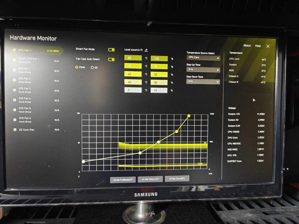

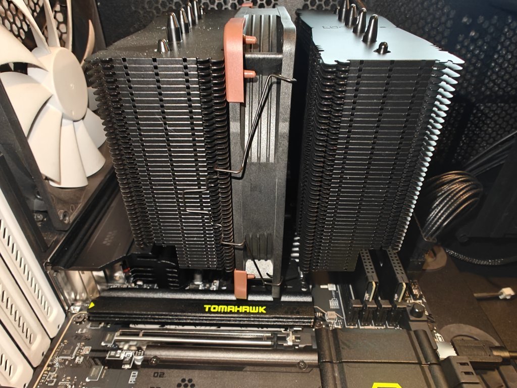

    The Noctua NF-A14 iPPC-3000 PWM
    fan is installed. I was worried the wire brackets wouldn't work with the new fan, but they work and without forcefully bending them out of shape.
    I'm glad I was able to test the RPMs vs Noise in the BIOS realtime to adjust the fan curves.
    On the stock CPU fans, with a load such as Prime 95, the temps would instantly jump to about 92°C and creep up to 95°C before the CPU throttles. With this single fan, temps jump to about 80°C and settle around 83°C. Realistic loads such as AV1 encoding were about 81°C before, and about 73°C now. This is with PBO on auto for the 9900X with the above fan curve.
    These are the approximate fan speeds according the the BIOS. The case is using the stock three Fractal 140mm fans with the case fan controller.
    5% = 350 RPMs
    10% = 870
    20% = 1100 - Slightly louder than case fans at 5v
    30% = 1280 - Slightly louder than case fans at 7v
    40% = 1500 - Slightly louder than case fans at 12v
    50% = 1705
    60% = 1930
    70% = 2200
    80% = 2415
    90% = 2600
    100% = 2800
    I would say that above 50%, you wouldn't want this fan in a living space. I might also replace the stock Fractal case fans with the Noctua fans.

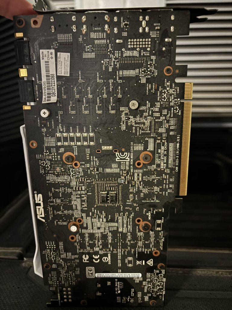

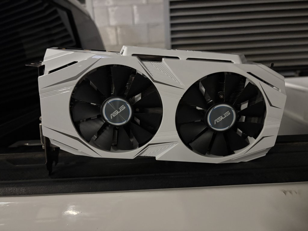

    Anyone want my old ASUS OC 1070 graphics card? Worked perfect when I pulled from my pc and upgraded. Moving now and cleaning stuff out IMG_7940.jpg

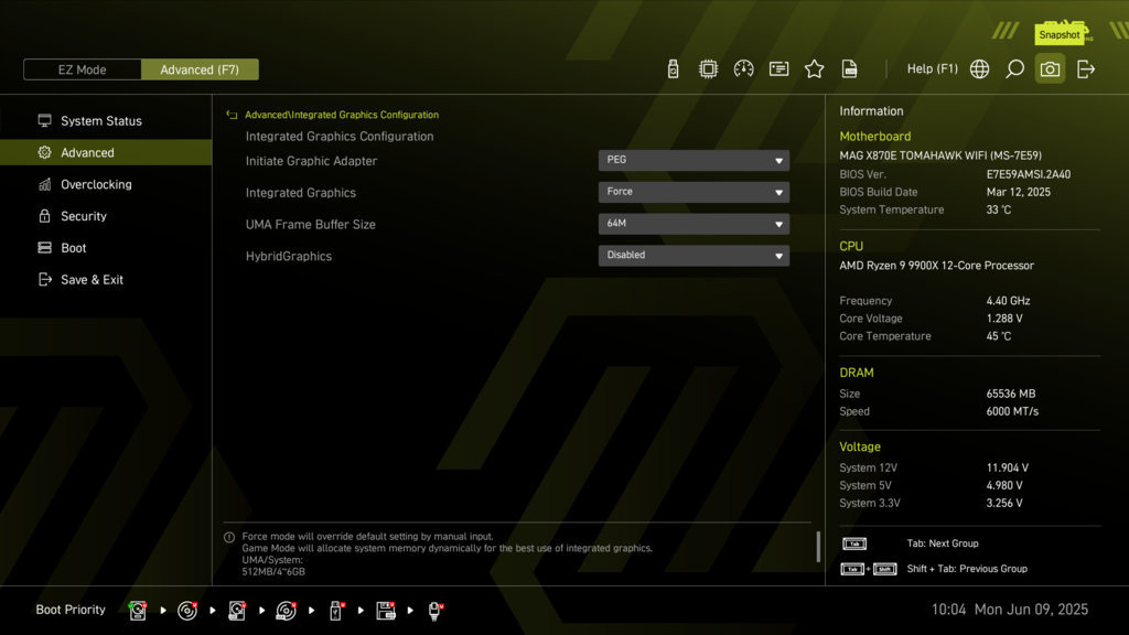

    Since I'm only using my system as a server, I only need the display for the occasional command line stuff. So I set the UMA frame buffer to 64M. After I boot the system, only 63788M of RAM is available out of 65536M, which is a lot more than 64M missing. Maybe there's another setting I'm missing?

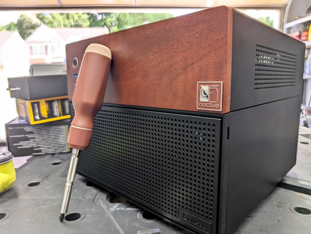

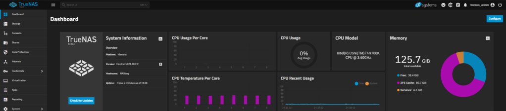

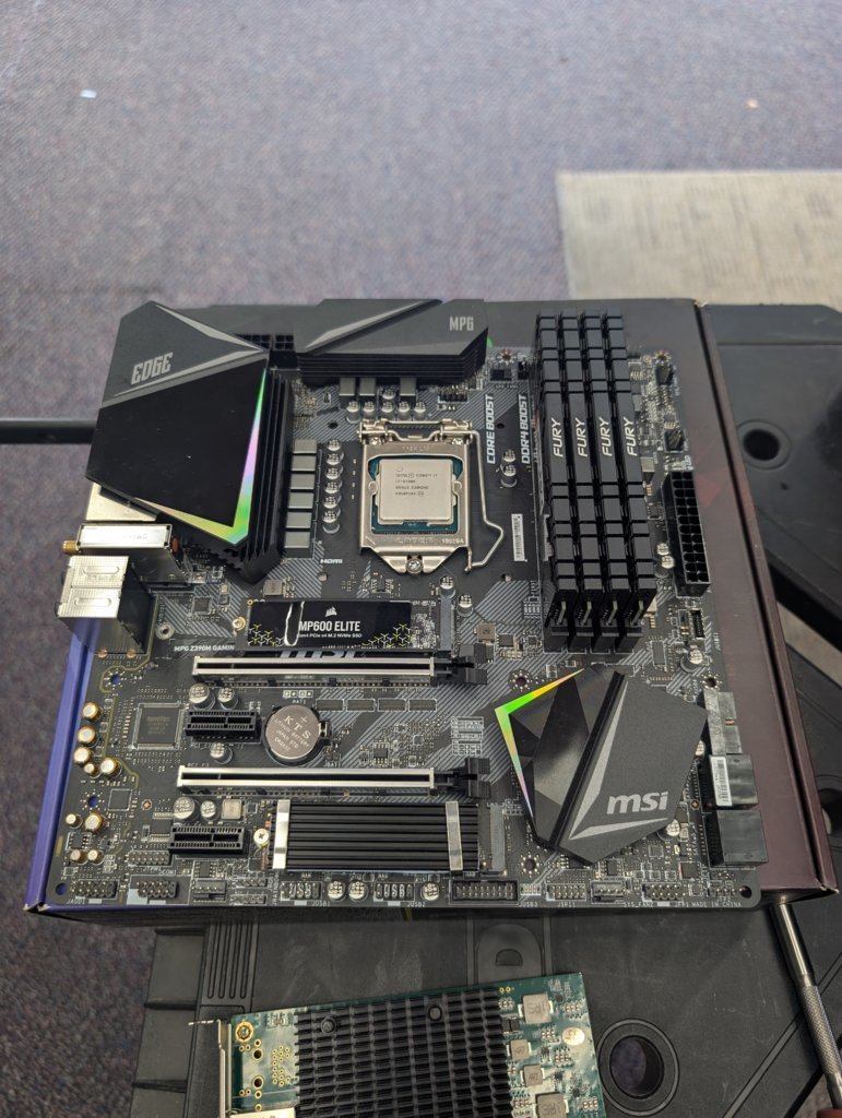

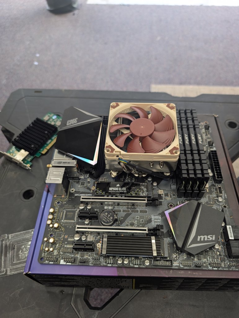

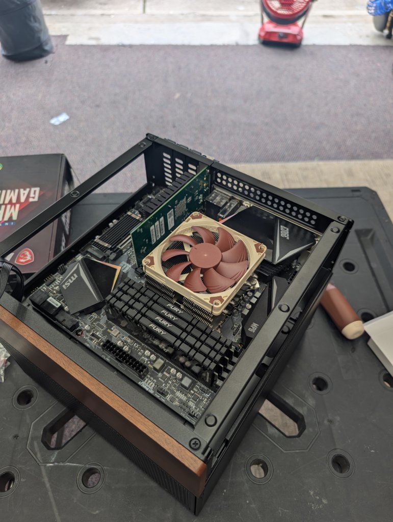

    Finished updating home network to 10gig and got around to building a new 10gig nas from my old PC. Got a used mini mobo and case off of marketplace for ~$120 all together all other parts I pulled from old PC.
    Still waiting on new 20tb hard drives to come but system is up and running with a few old 3tb I threw in to test on.

    That case is sick :thumbsup:
