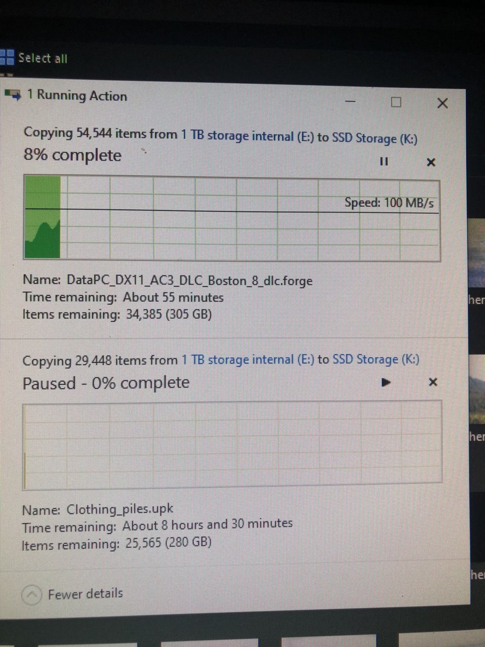

    I started moving my steam library to SSD tonight.

    those the 2.5" samsung 860 evo?

    The target drive is, source drive is either a seagate or WD mechanical.

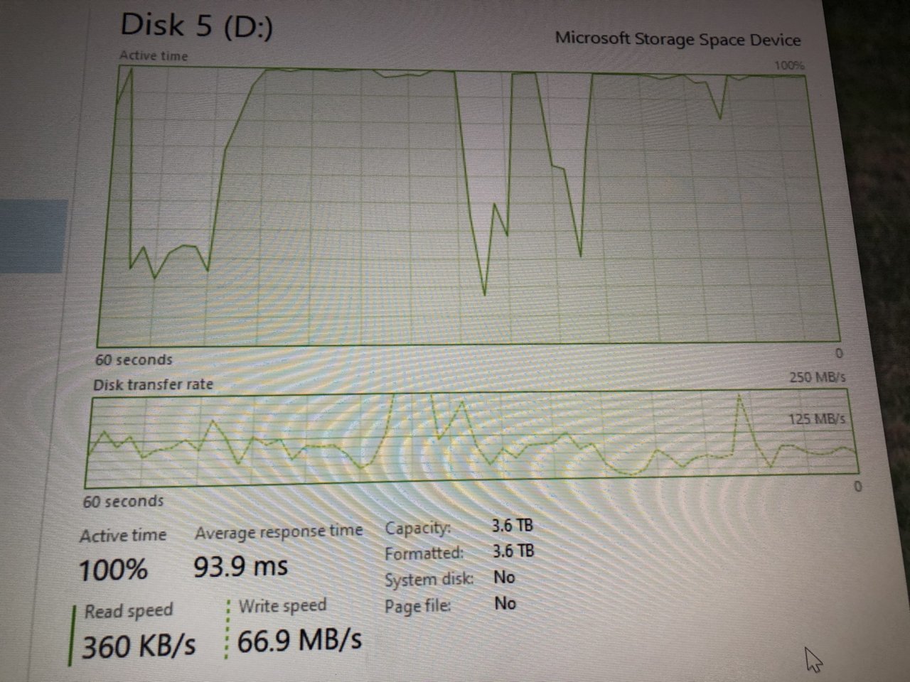

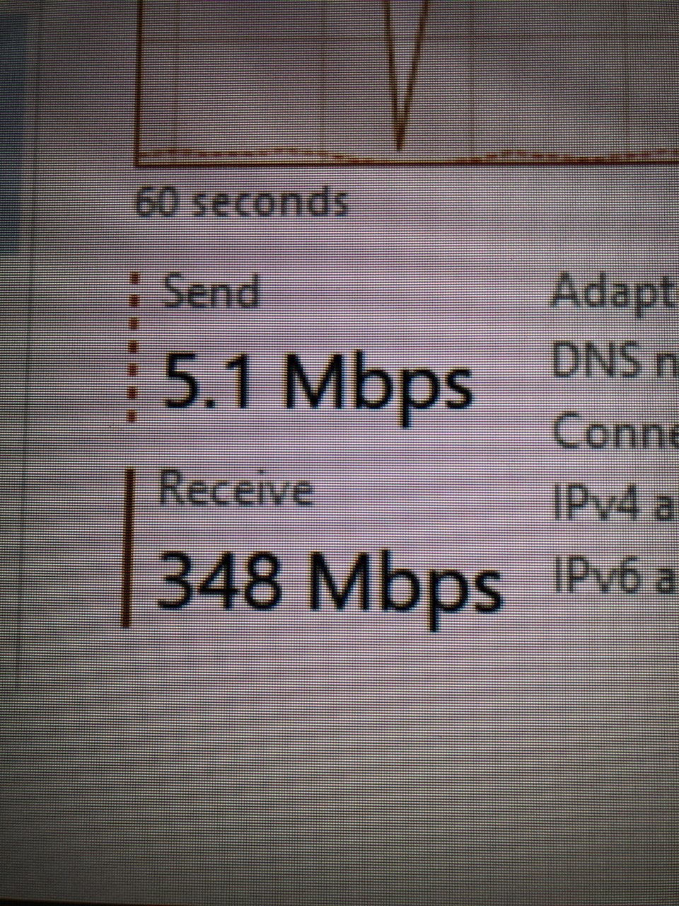

    This is very interesting, I have to reload a few of my steam games and my network connection is a steady 300-350 Mbps down but the disk write speed is 40-45 MB/s with occasional spikes to 100+ MB/s.
    I don’t understand the variance in what is coming in vs what is being written to the drive, my RAM usage has stayed pretty much the same so it’s not going there.

    I see a pretty big valley in network speed
    there. What can happen is the PC will download at high speed to fill the drive write cache, then slow down momentarily while the cache is written, and repeat. Whatever data comes in when there is no available cache is either paged directly on the drive or silently dropped. It's like filling a bucket of water with a hole in it faster than the hole can empty the bucket. The water either exits the hole (your HDD platters) or runs off the top (dropped packets). Whatever is dropped is quickly reaccessed and resumed, so fast you'll never notice it.

    Also your write speed is highly variable, as is your download speed, so imagine the hose filling the bucket is surging and you wiggle something in the hole of the bucket to keep it flowing out fast lol.

    This is also why I've never regretted moving off to the fastest reasonable SSDs available (PCI-E 4.0 NVMe). My drive can easily out write my connection leading to short download times.

    348 Mbps is about 43.5 megabytes per second. Seems about right to me.

    Good catch, I didn't even notice the unit change lol. Good ole windows making zero sense.

    :facepalm: I forgot about the conversion.....

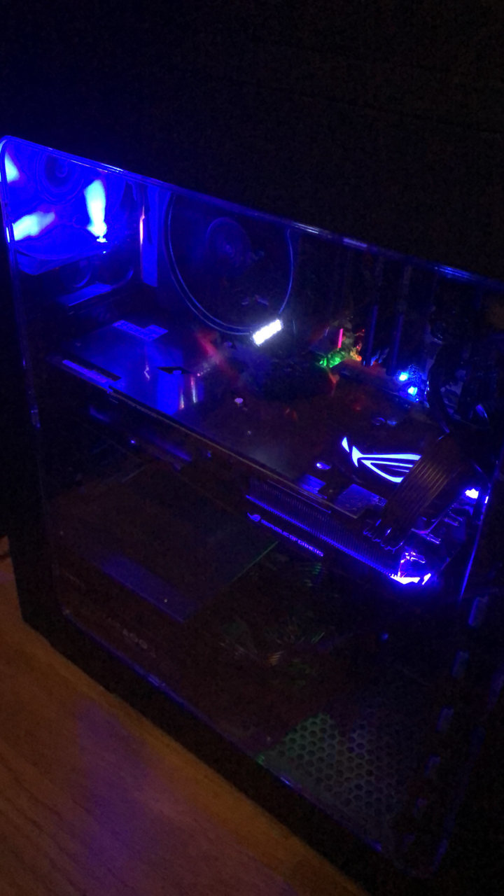

    GPU came in today, it looks pretty good!
    I have to say I’m very happy with my system now, just next year I’d like to upgrade some of the peripherals, my keyboard is still ps/2 and my monitors are all 60 hz and one of my 3 screens is 1360x768 and the other 2 are 1080P.
