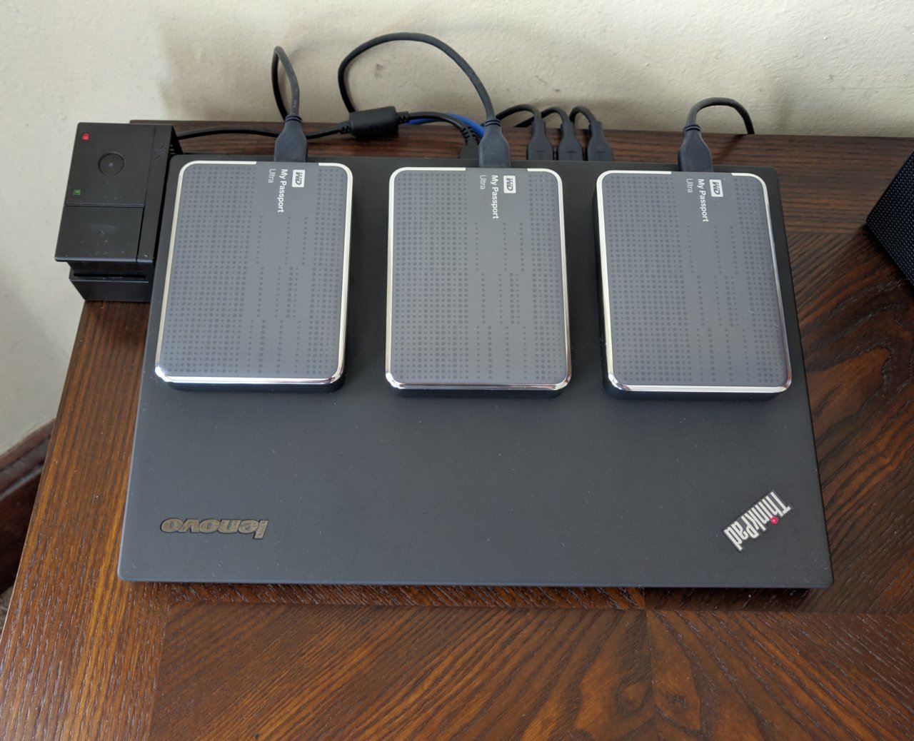

    Not really a PC build, but redoing my file server.
    Small footprint, quiet, built in battery, easy access to drives. The drives are 2TB each. Probably going to convert the filesystem to ZFS today. (And yes, I have a couple regular backups)
