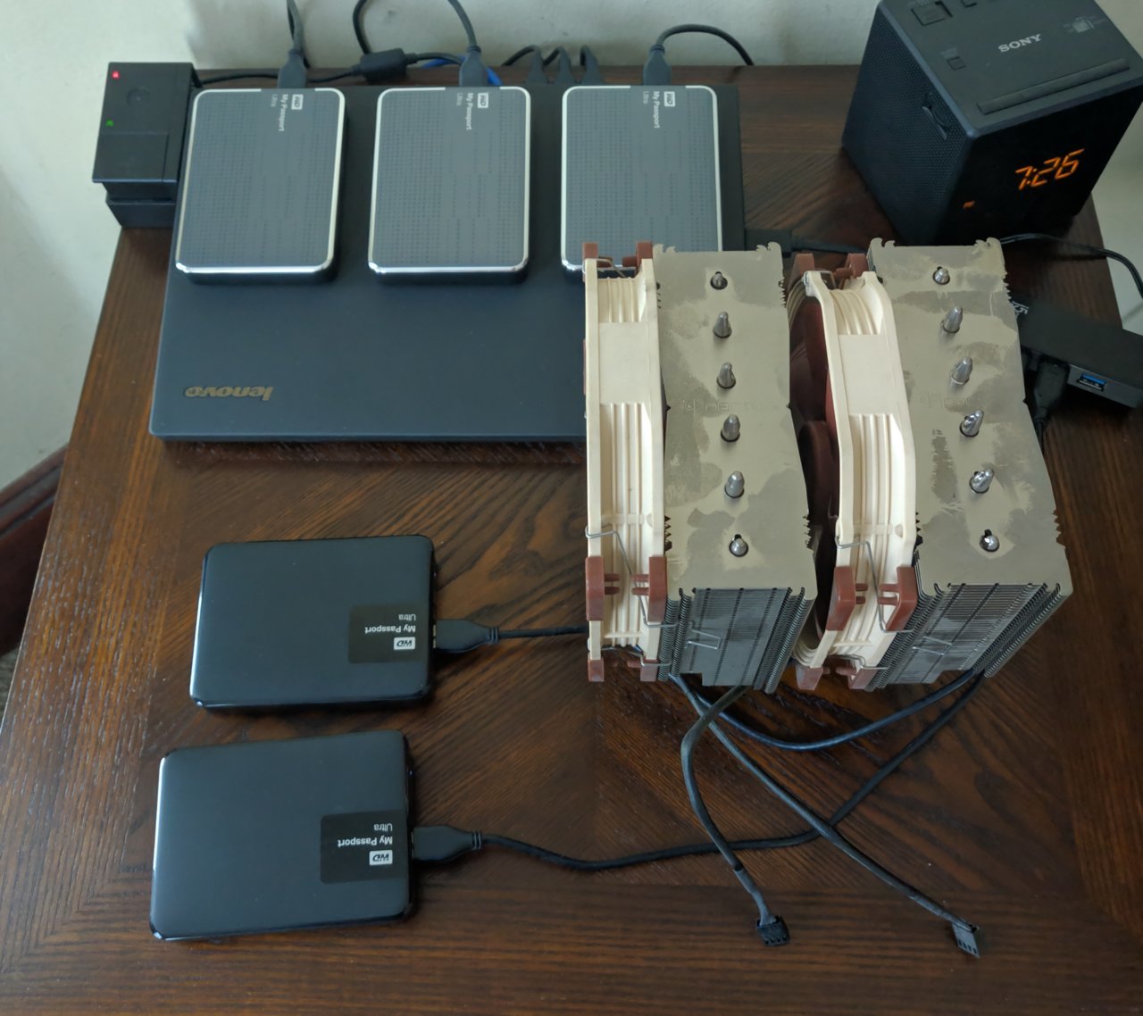

    Speaking of Noctua, I removed the NH-D15 from my case. Looks massive outside of the case.

    Because it is massive. I remember when people would have to wait for board reviews to make sure the board could hold the weight of the most massive tower coolers.
