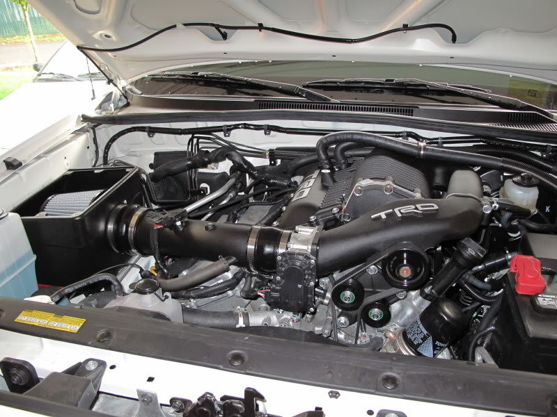

    No problems at all for me. I have the S/C with the aFe stage 2 with the pro dry filter.
    Here is the one I have (I found it online for under $300)
