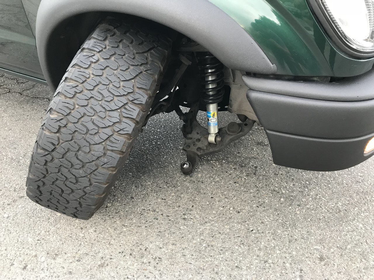

    any recommendations on upper and lower ball joints ?
    Mine just broke off this morning while driving !
    Thanks !

    Toyota oem is the best to go with. I used moogs once before for about 20000 miles. Within the 20k they developed play. The oem toyotas lasted just past 250k

    Looks like you avoided body damage. That's the good news. I'd also use OEM if possible, although there are good aftermarket alternatives.

    Was there any warning that the ball joint was going bad? Clunking, loose steering? It's scary to think this could happen without warning.
  11. Nov 7, 2017 at 12:24 PM
    vtframer
    vtframer Well-Known Member
    Feb 21, 2017
    #211209
    136
    Vermont
    2001 Tacoma SR5 Extended Cab, 4x4 Manual Trans.
    Exactly - any warning signs at all?
  12. Nov 7, 2017 at 12:27 PM
    Miguel_prerunner7
    Miguel_prerunner7 [OP] Well-Known Member
    Oct 27, 2017
    #234273
    283
    Miguel
    Downey Ca
    Sold 2001 tacoma prerunner 4x4 conversation 09 taco
    Snorkel
    Correct I felt like a loose steering and vibration didn’t really pay attention to it till it broke loose good thing i was only going 5 mph after a stop sign :/

    No i have never replaced them , I was recently going to replace them due to the fact that Im was going to covert my prerunner to a 4x4.
    Current mileage 230xxx

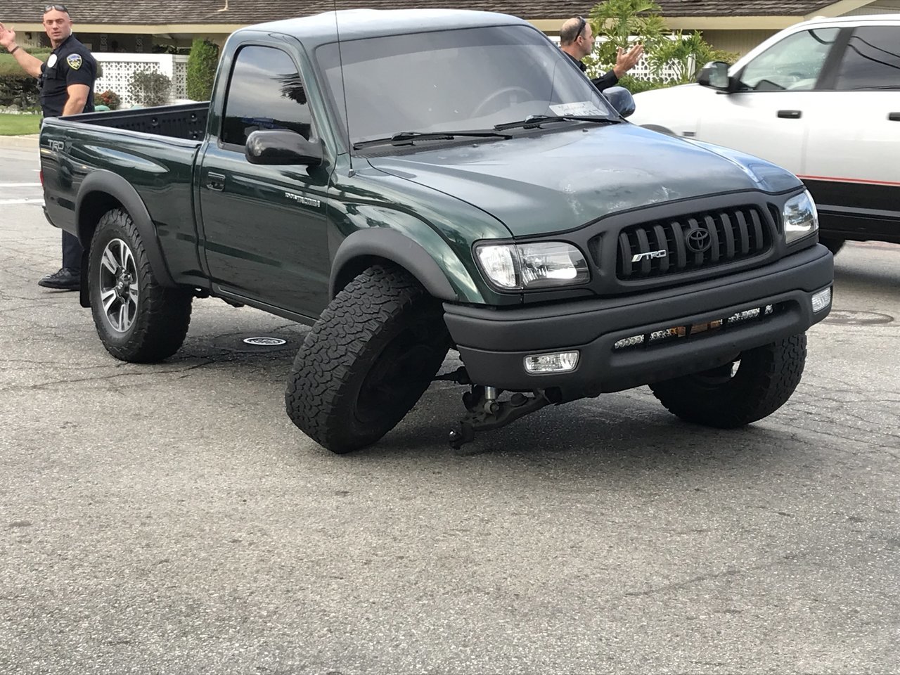

    I cringe every time I see one of these, even though I just replaced mine <1k miles ago. I got OEM from gunny, right around $110 each. Such a clean first gen, and regular cab, too! Hope to see you back on the road soon!

    That hurts seeing a Tacoma in that condition, particularly because it is preventable. I'm partial to OEM front suspension parts, and would go that route myself. After all, sounds like your truck went over 200K on OEMs.
    Please pay more attention to anything odd in your steering or suspension. When it loosens up, it means something is wearing out. You should also check out the inner/outer tie rod ends.
