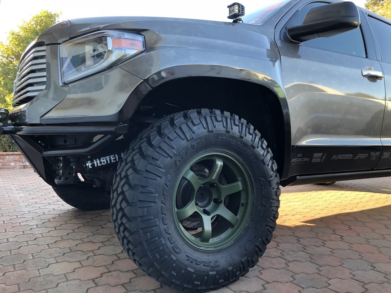

    4FCD2F6D-F885-42EC-B9B9-3E7021C0F98F.jpg EFC6EC2F-2F03-427D-B099-C12CAEA80C36.jpg
    Went from a couple taco LT to MT to tundras with this LT above to mid travel as well. Now back to tacos as they’re better for what I plan for my next project.
