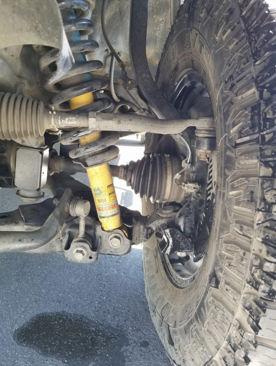

    Don’t do ome with 5100’s they’re too stiff. Hit the right pothole, rock or speed bump you’re going to stuff the lower shock mount into the the shock body. Go eibach, or swift springs which is what king and fox run. Find the correct spring rate and lift you want.
    note the pic below is a OME spring used on a 5100. Look and tell me what’s wrong with the pic…

    Isn’t that a stock TRD OR shock?

    the bottom of the shock is hitting the mount.

    Yes. Toyota used 5100’s on some tundras and Tacos and still do by contract. They also use 4600’s and Hitachi shocks depending on the model.
    The 5100 I used as an example up there got it’s lower 3” of post shoved into the shock body due to the OME spring being too stiff so the weakest point of the shock became the bump stop..
    edit: yeah I didn’t mention the pros, not the point right now.

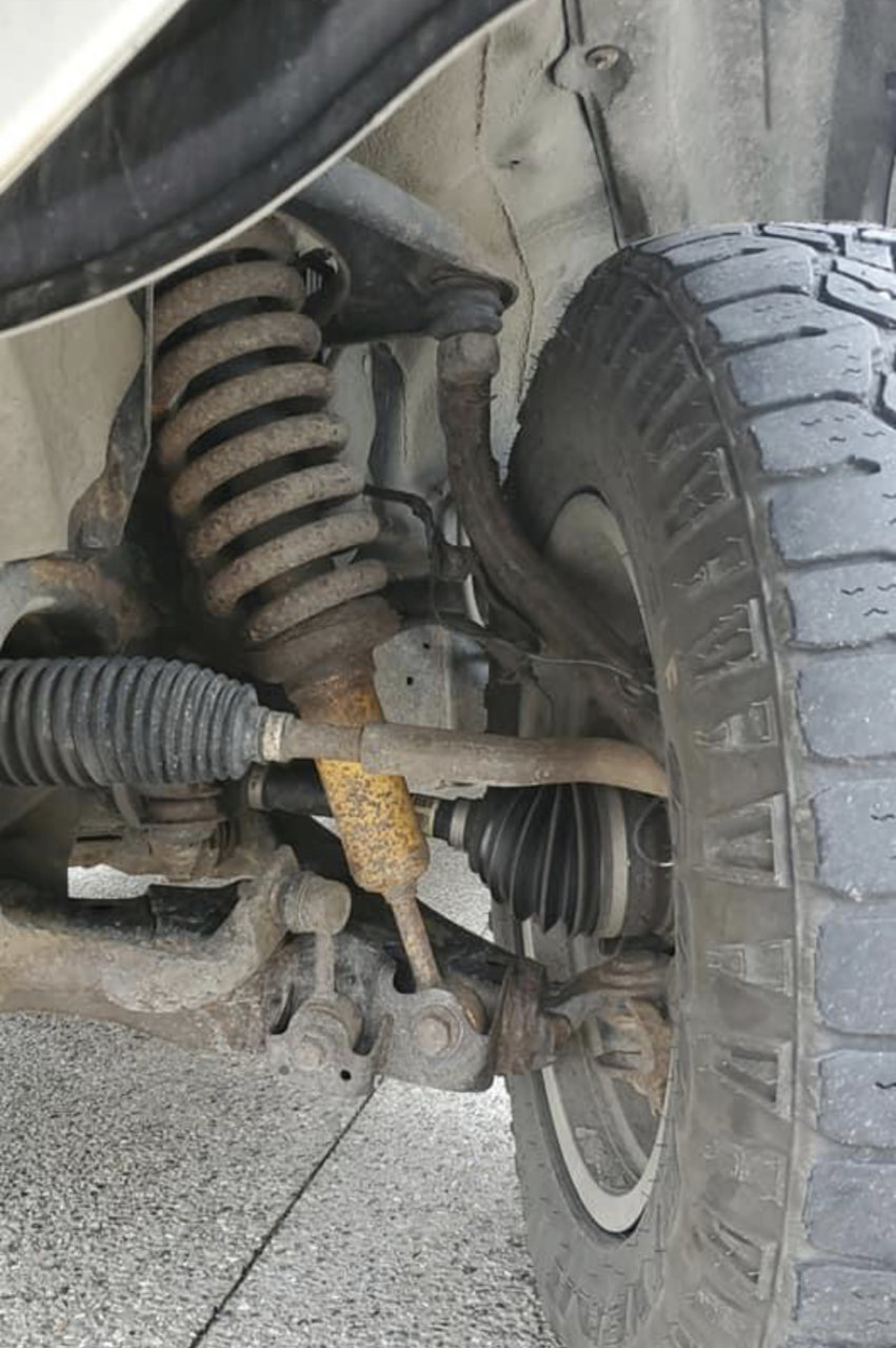

    Yes and no. The lower mounting post is inside the shock body as the ome spring was too stiff not allowing the shock to cycle on a pot hole, the weakest point of the shock became the bump stop
    Here’s a pic of how the shock is supposed to look. Yes different truck but also with an ome spring

    Oh shit I see it now that’s crazy
