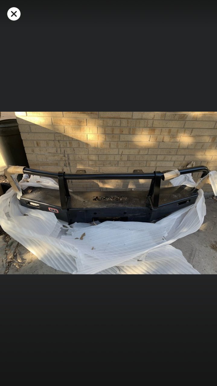

    I just picked up a new ARB bumper for my first GEN Tacoma but it’s not brand new in the box and doesn’t have any hardware with it.
    what do I need to mount this to my truck?

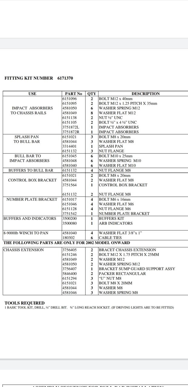

    Just a heads-up, the post of mine you quoted is referencing part #s for the 2nd Gen ARB bumper (3423030).
    Here's a screenshot of all the hardware/part #s of what included in their fit kit.
    I also attached the installation PDF for this bumper (3423020) at the bottom.
    Here's another helpful thread.
    https://www.tacomaworld.com/threads/help-with-installing-used-arb-bumper.494760/
    Note, there are different mounts used on 2002+ models, as noted on the install guide. There is a complete hardware kit you can purchase from ARB (6171370) but it is expensive. They may have updated that hardware kit to include the '02+ hardware as well. The newer kit is 6173276S.
    Hope that helps, but you can always call ARB directly. They've been pretty helpful every time I've reached out.
