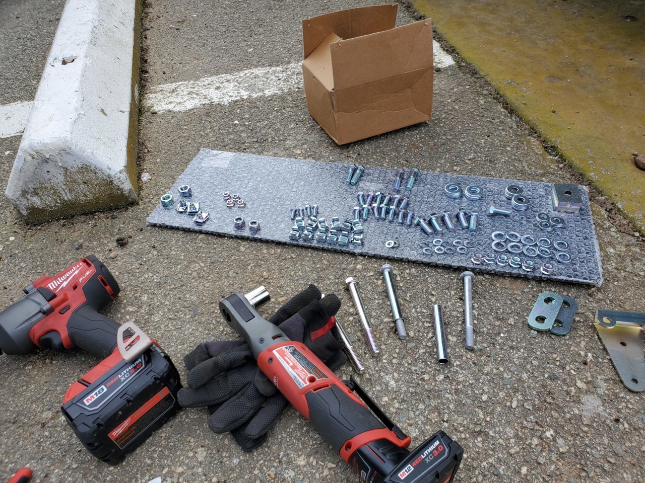

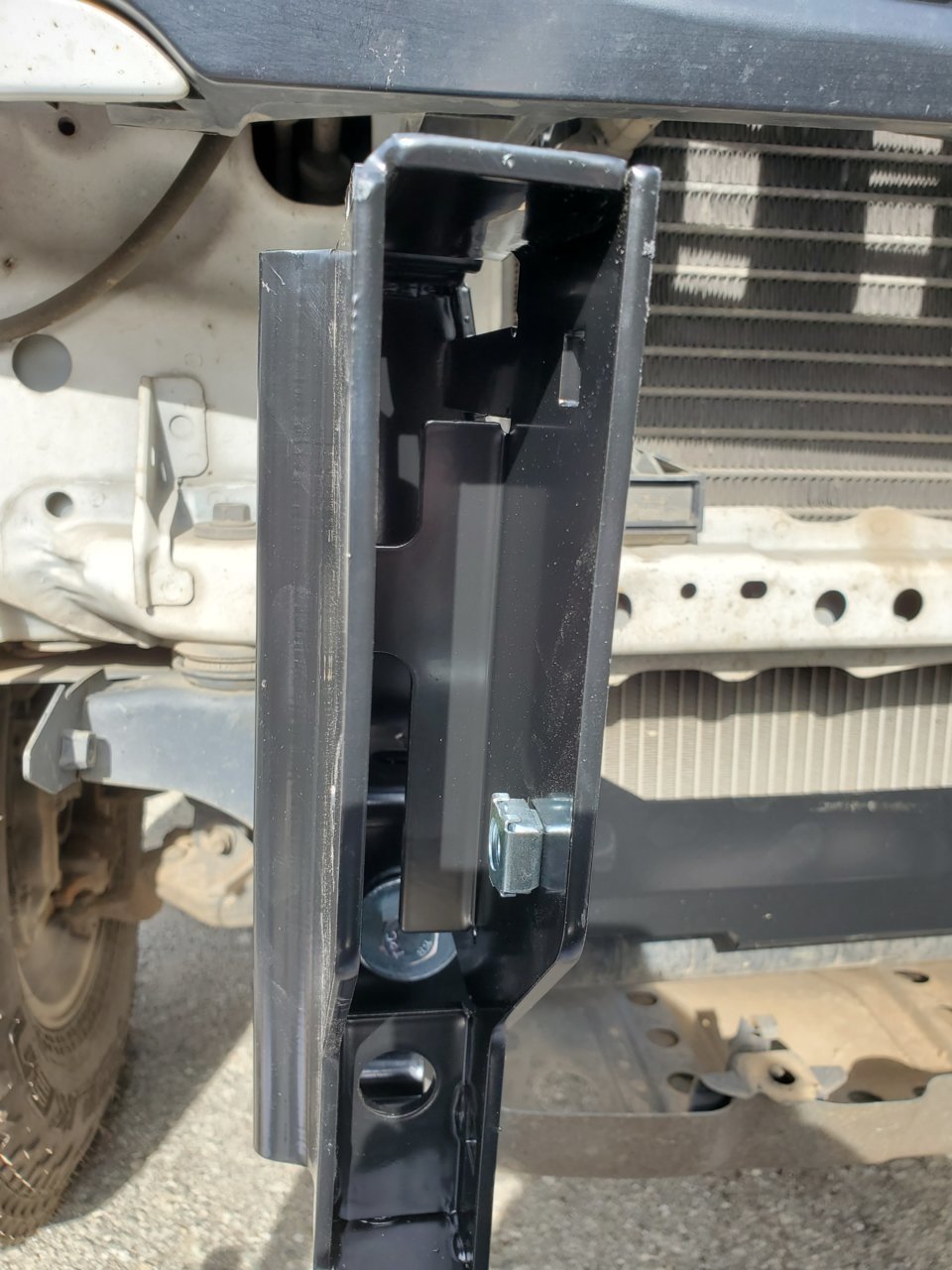

    *A ton of the hardware that comes with it ends up as leftovers. As for the rectangular packer, if you mean the stainless rectangle pieces with hole in center, those were unused on mine and I haven't seen anyone else use em. Also I used bolts that came with the kit to put the chassis extension blocks on. (Most annoying ones to tighter since that cutout space is tiny) Only bolts I reused were where the original tow hooks/tie down were.

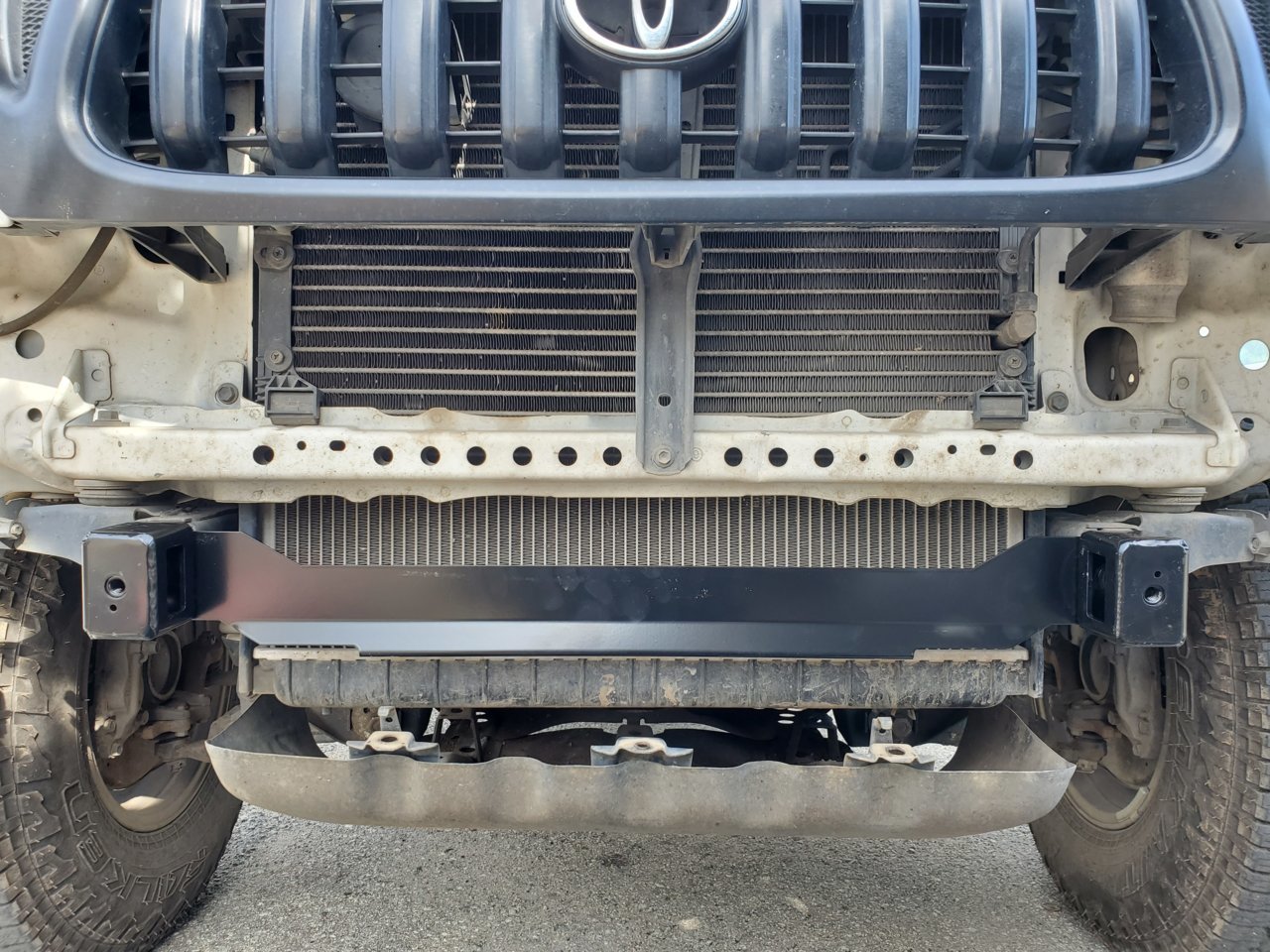

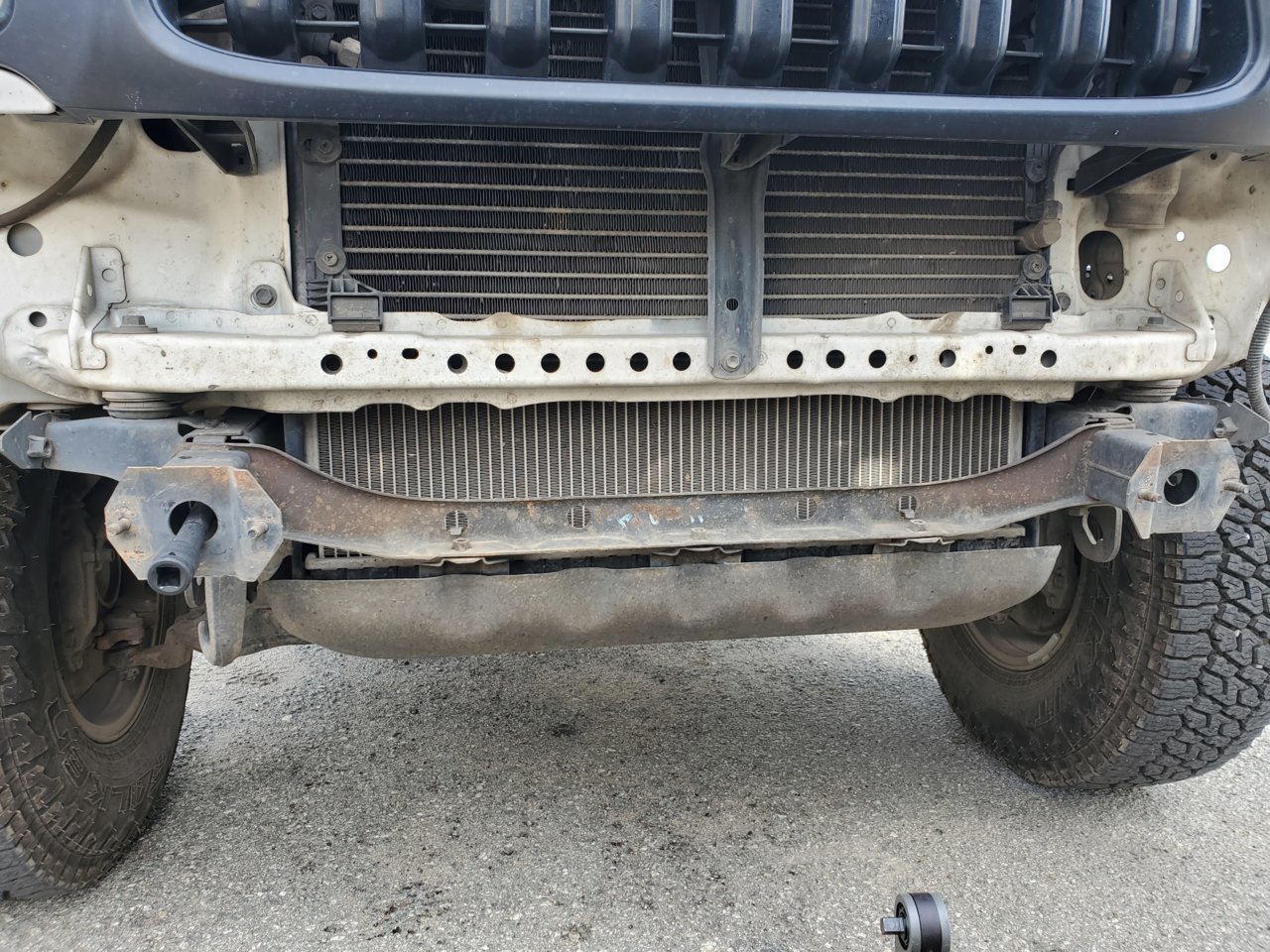

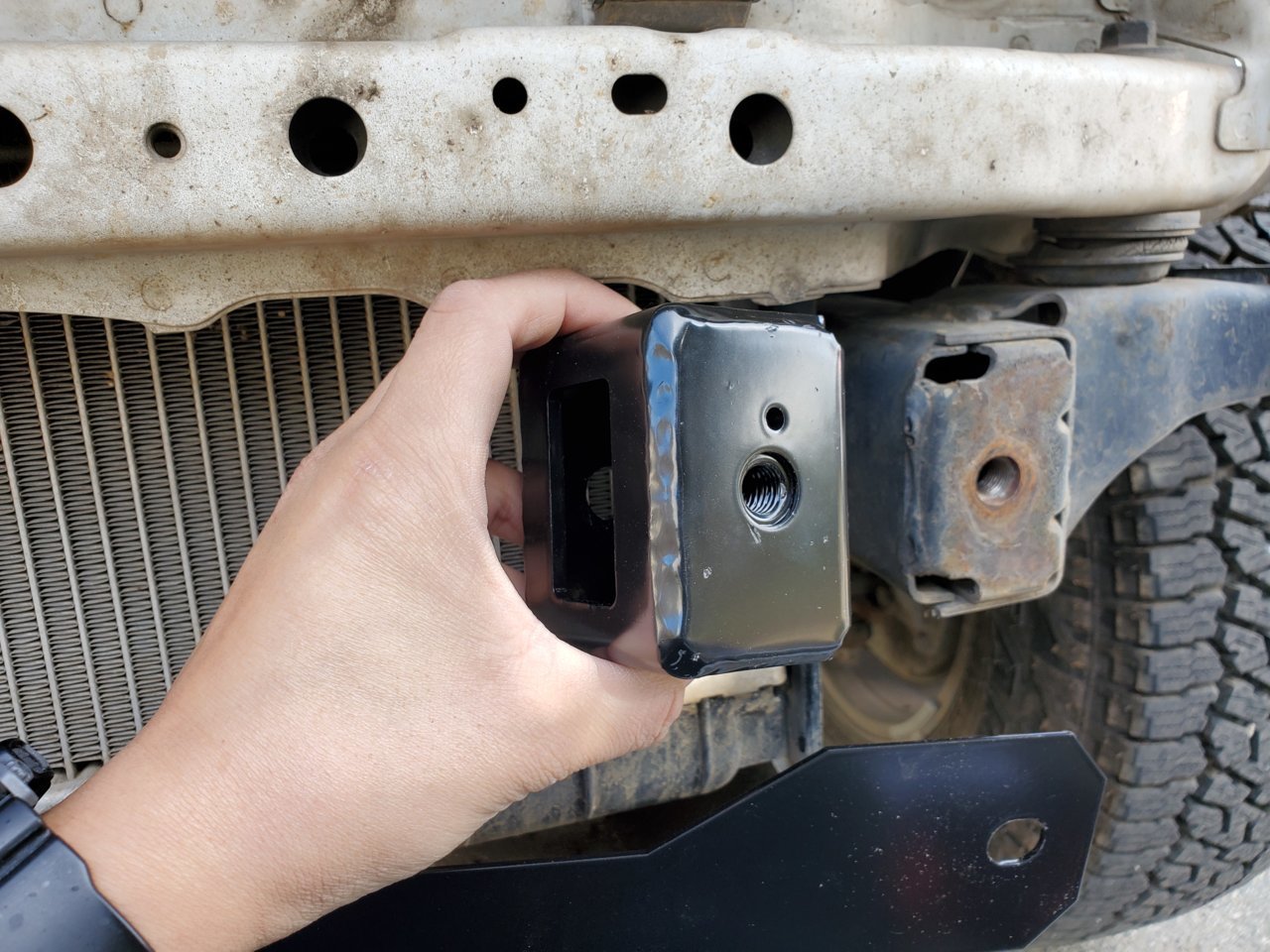

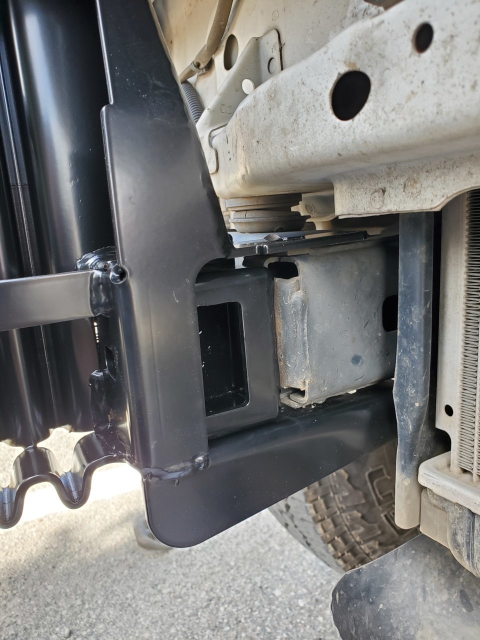

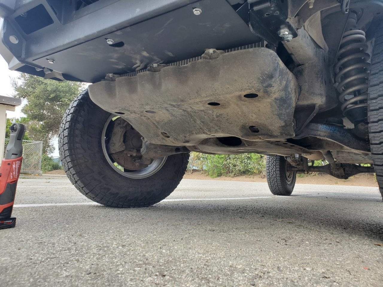

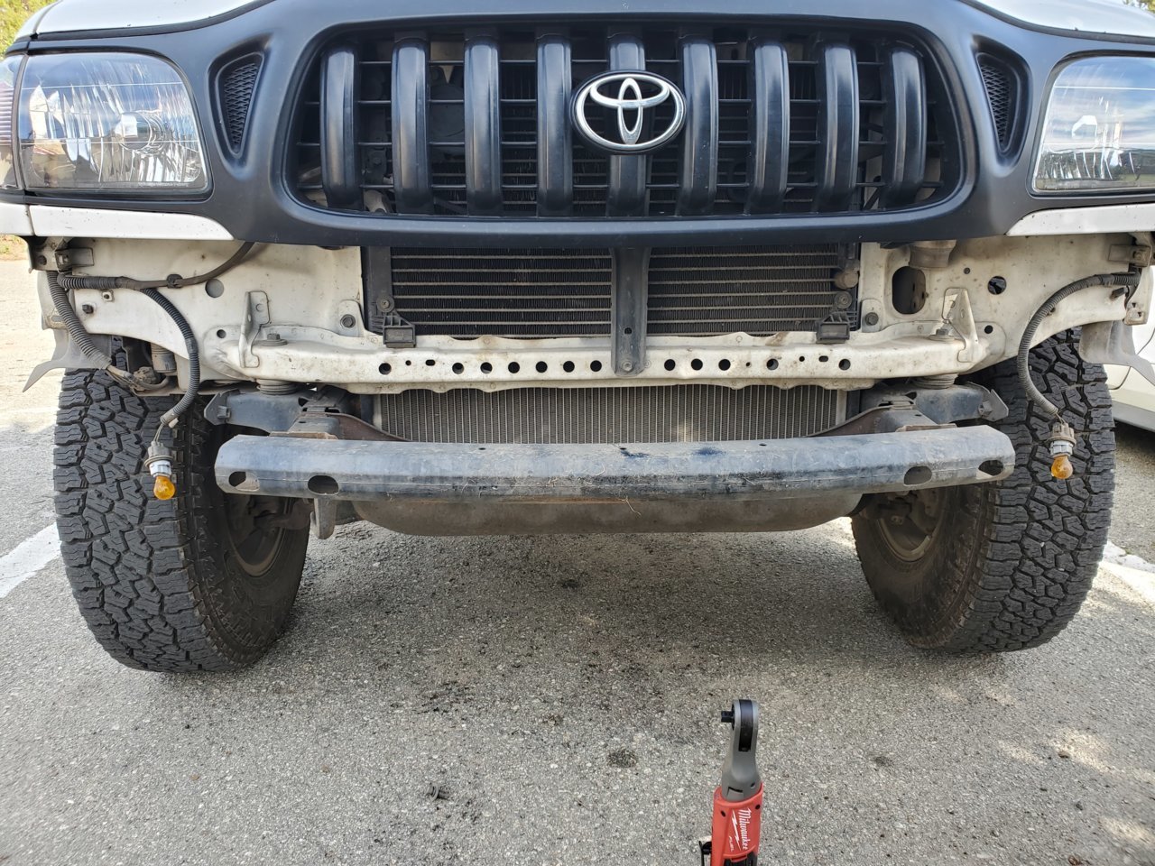

    Did you....go through the instruction manual found on page 1 of this thread?
    The install is easy, just need to organize said bolts to make it easy to use what you need.
    Here are some pics when I installed mine -
    shankyjones, TRD_IV, TRD493 and 2 others like this.

  18. Jul 18, 2021 at 8:37 AM
    #38
    01x4
    01x4 I know what I'm doing?
    Aug 26, 2017
    #228102
    6,655
    Coast of Southeastern VA
    Here's a snap of mine. I can't remember the lengths, which was which, right now. (That's not a double washer in the outer bolt btw, just a reflection on the surface) That outer bolt doesn't protrude past the welded nut on the inside of the chassis extension fwiw, if that helps with length.
    The other shot is the inside of one side of the bumper, where it slipped onto the big brackets.
    *Mine brackets too close together at first, I just loosened em a bit, got the bumper on then snugged them before removing the bumper again.
    Last shot is what I have left over. (I haven't drilled the underside of the blocks yet because I don't have a winch yet.)
    As with anything with crappo instructions, you're on your own, this is what worked for me and what I interpreted as the right way to mount it, so far it hasn't flown off.
