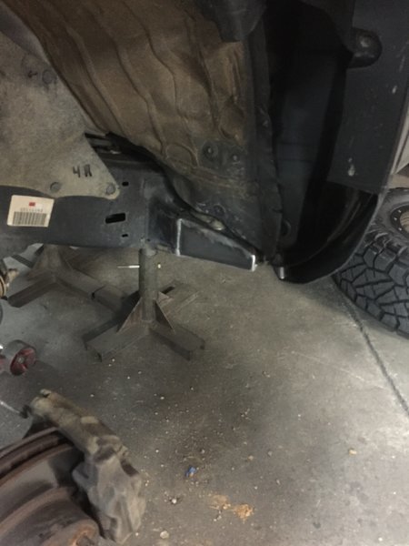

    I have a 3" OME lift with 285/75/16 KO2's and I had to trim inner fenders, remove mud flaps, and chop the cab mount.

    Depend on where where you will be driving. With my 3" lift up front, Frankenstein rear and 285/75/16's I had to remove the mudflaps, trim where the mudflaps mount, CMC, Trim inner fender plastics and beat back the pinch weld and I am still trimming..And I'm still rubbing..

    I'm on 285 75 16 with 4.5 bs. 2.5" up front and 3 in back. I've only removed mud flaps, trimmed the plastic where the mud flap mounts. nothing else yet. I have a hybrid bumper so nothing to cut in the front. stuffed it pretty good on a trail a few weeks ago and had a big rub. but haven't done any serious off roading since install. probably going to need to do CMC soon.

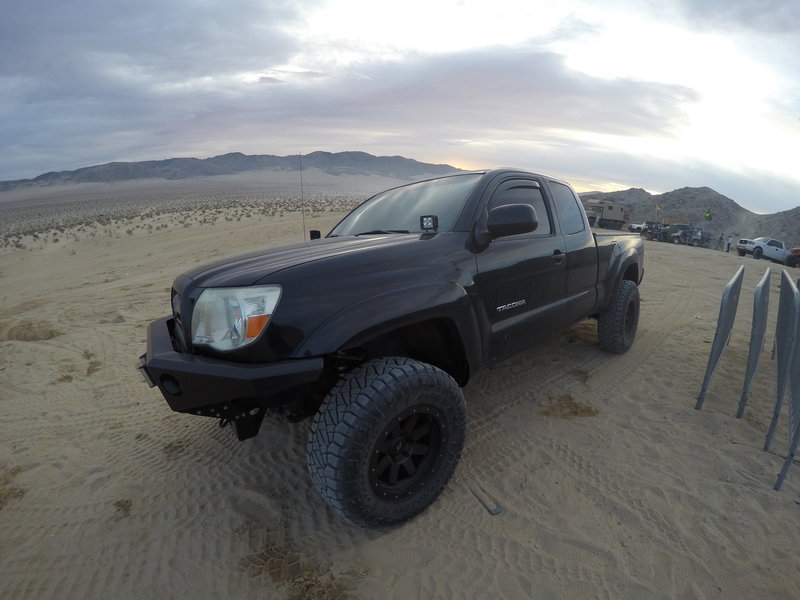

    If you want to go wheeling go 285s and a cab mount chop, and maybe flatten your pinch weld not extremely neccessary, and you should be fine i did mine and have been on multiple trips and have been fine so far!

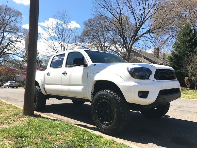

    127,315
    Sponsored by TacomaWorld.com
    What are the specs on these wheels? Truck looks damn good sir

    '14 TRD Off-road DCSB
    Thank you! I have the SCS F5's with 3.5" back spacing.
