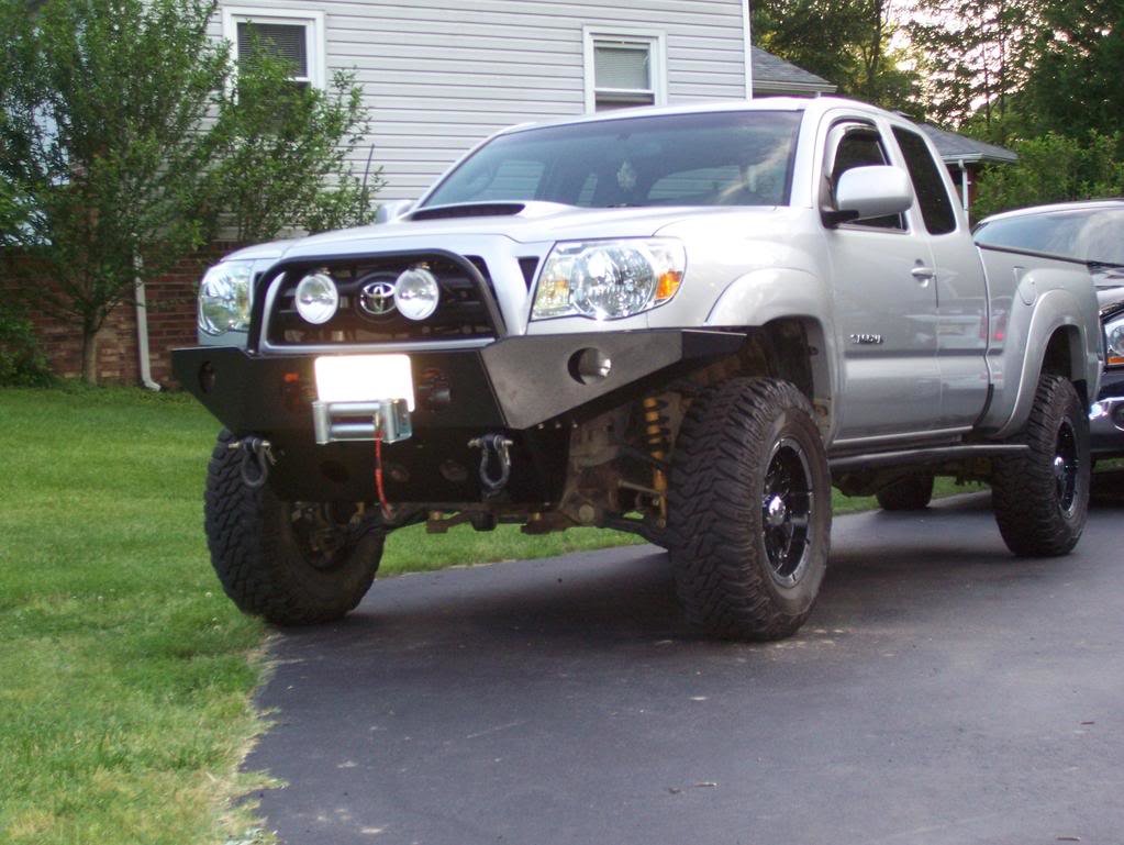

    The problem is the stock bumper is crap. It's just a plastic shell over an aluminum 2x4 bar. Why would you even WANT to mount to that? If you were to actually use the winch for the intended purpose the mounts would break or bend. I suppose you could replace half the crap on the front end to get a strong enough mount, but why? You can't mount a fairlead to the plastic bumper. If you did it would damage the bumper and probably tear the fairlead out first time the cable moved. One person on TN or TTORA did that by making a custom mount, replacing the aluminum 2x4, and mounting the fairlead to pipes welded to the frame. I seriously doubt his setup would hold up to an angled pulled, no one else has done the same setup AFAIK, AND I never heard about the setup again. So who knows how it did or did not hold up. I wouldn't trust it, but that's me.
    I'd say you're best options are (in order of lower to higher cost):
    1. Front mount reciever, winch mount, and quick connect wiring. Leave the winch off until you go somewhere you need it. Also gives you the option of putting it on the back if needed.
    2. Warn Trans4mer. More expensive, but permanently mounted and adds some protection to the front.
    3. Aftermarket bumper. Most expensive, rock solid, replaces cheap plastic crap on the front, much more protection up front.
    Personally, I'd go with option 3 and pick up a bumper from Shrockworks. :D If you're doing anything that requires a winch then it's only a matter of time before you rip the plastic bumper off, crack it, or have it flex and snap off all the connections behind it. Mine flexed during a slight bump. Bumper is fine, but fog light and head light mount tabs are broken because they didn't flex. Stupid f'ing design if you ask me.

    This might help:
