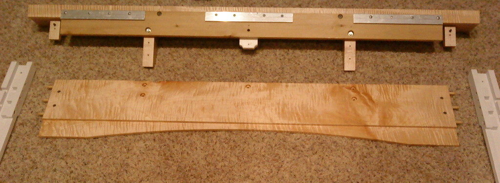

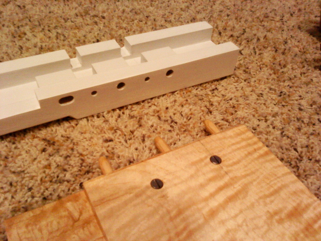

    ...some pics of the assembly of the fireplace mantel...
    photos of the installed mantel here: https://www.tacomaworld.com/threads/home-improvement-today.12120/page-382#post-12548939
    view from back (top: mantel assembly with corbels and hanging cleats, middle: fascia board, left/right: pillasters)
    1. pillasters get mated to fascia board via captive dowels and bolt/barrel-nuts
    2. pillaster/fascia assembly get mated to mantel assembly by pressing pillasters onto the small corbels on either end (notice the dowels there for alignment and support), then screwed into the back of the corbels w/ 1/4" lag screws and #8 pan-head screws.

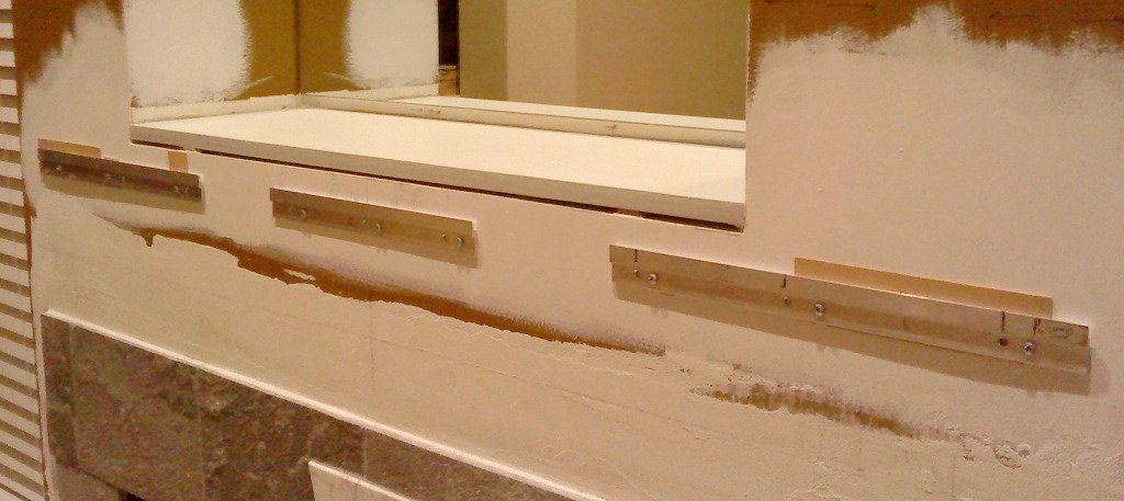

    3. pillaster/fascia/mantel assembly gets "hung" onto mating aluminum cleats on the wall above fireplace...
    closeup of pillaster-fascia joinery... i designed this to be knock-down, the dowels provide for alignment and strength, held together using barrel-nuts and bolts (not shown). the reason for the slotted hole is to accommodate any expansion/contraction of the fascia board across its width, since it is pretty wide and it's a cross-grain joint interface with the pillaster)
    ...aluminum "z-clip" cleats on wall support the weight of the entire assembly... these are 1/4" thick, beefier than the ones for hanging pictures and such...

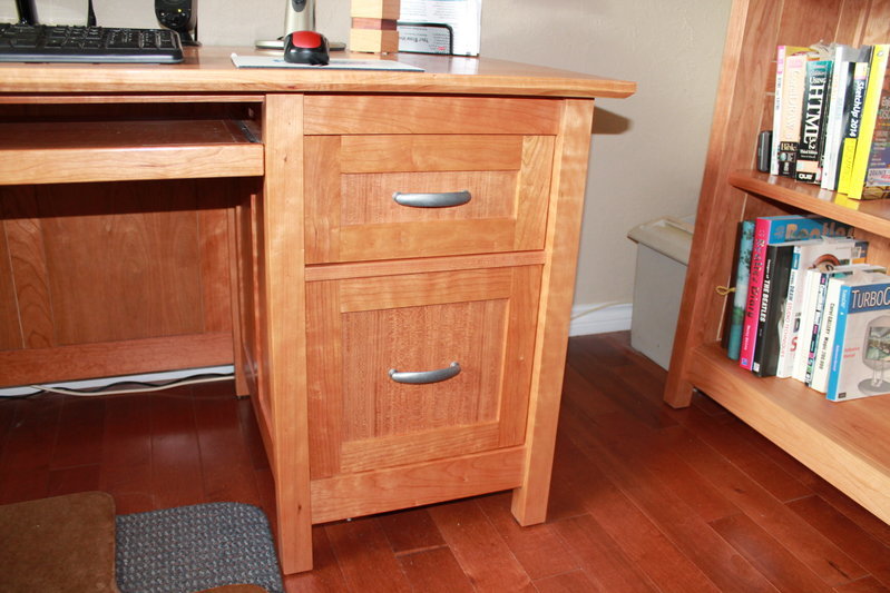

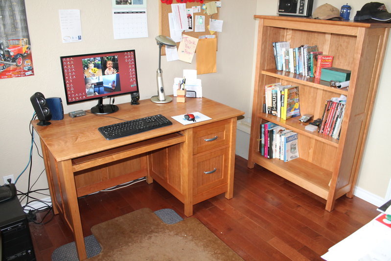

    my new office desk and bookcase in Cherry :)

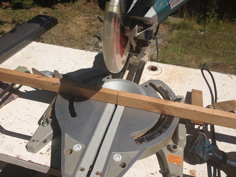

    @scocar

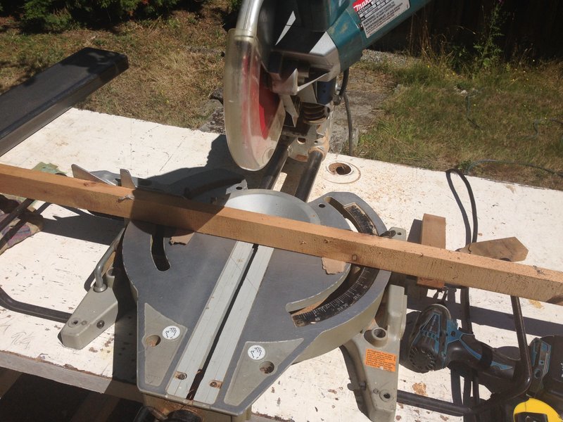

    Started working on the Rhino Fence today and chucked a quick sub fence on to cut some multiples so took a few pics so you were clear what I was saying
    I just screw on a straight piece of scrap to the LS1013 fence through the holes provided in the saw fence . I lift the sub fence up on a couple pieces of thin cardboard or similar ( in this case Ramboard ) so if I have to swivel the table it doesn't jam and sawdust doesn't pinch between it and the sub fence , then chop through it and pull out the cardboard .
    I can then add a stop block for multiples and the whole set up takes 5 minutes tops plus it provides a zero clearance tear out advantage for the pieces I'm cutting

    Wow, that Mak has like no fence to start with. But I like the idea for zero clearance on the back side especially for really fine work or small pieces. The DeWalt has a large V cutout there that I can remember at least once being a bit problematic with something I was doing. And screwing a stop block to that exactly where desired without fussing with clamps is a good idea. I'll give it a try this weekend when I chop some upright supports/corner blocks for my rolling shorts bin. Although those are all 8 footers I should just keep bisecting to nominal 2 ft sections.

    The LS1013 fence to the left of the blade flips up to provide a taller section , I have it flipped down in that pic

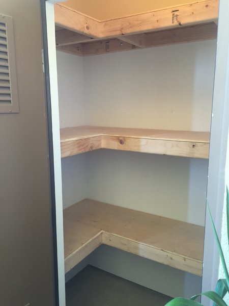

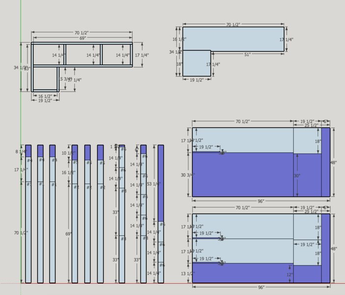

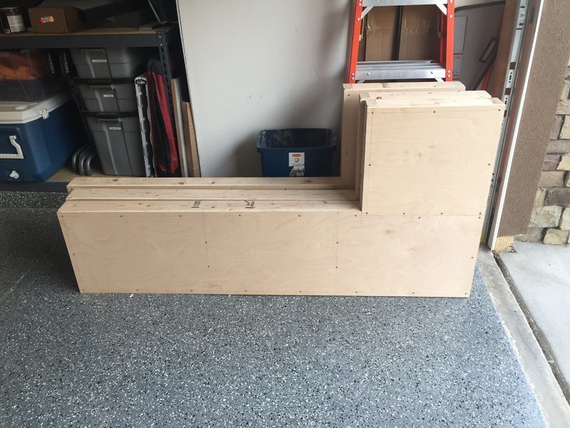

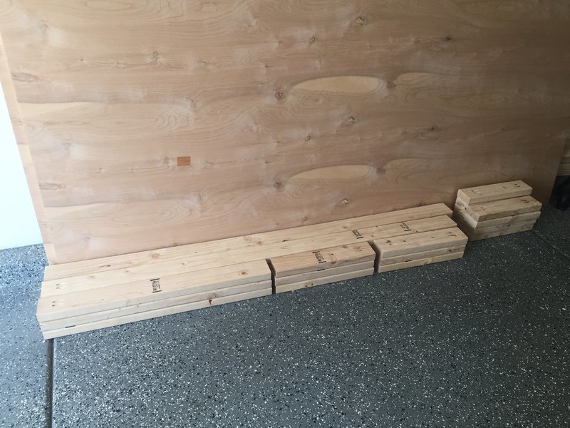

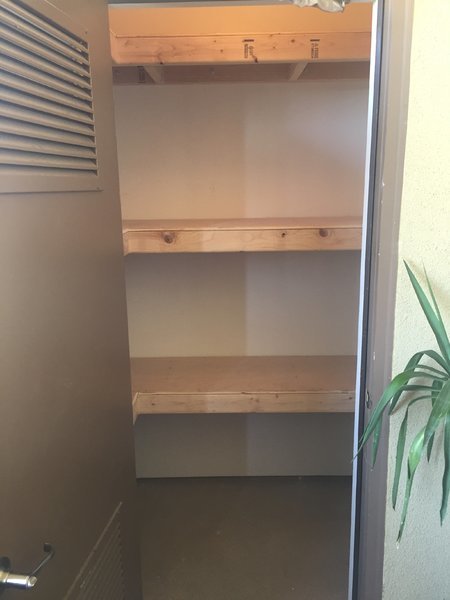

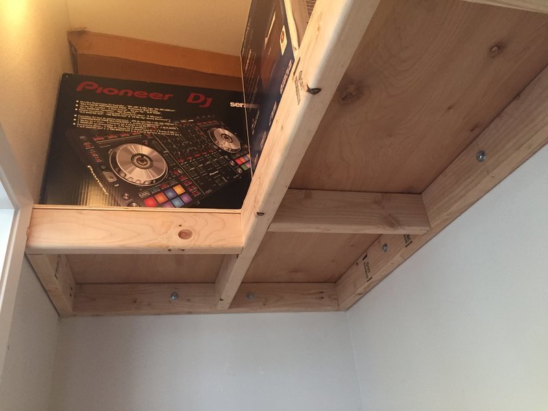

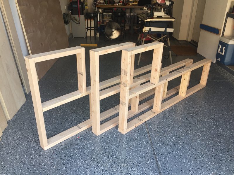

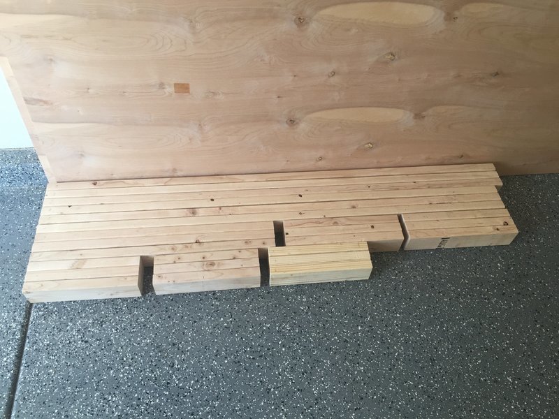

    Sooo... I overbuilt some shelves this weekend and this morning. The house was a complete shit show over the weekend with people and dogs coming and going for 3 days straight, so I had to work on this in 1-2 hour intervals between entertaining. Nothing special, just wanted some shelves in the patio closet, so I could move a bunch stuff out of the garage and make space to build more shit. There is no way I could use a "woodworker" title with my current skillset... more like lumber mutilator. This is literally my 3rd "woodworking" project.
    I like to obsessively plan my projects, to avoid numerous trips to the store, so I made a SketchUp model to figure out what I need to buy, exactly. I also picked up a Kreg pocket hole jig and a cross cut guide, so, naturally, I had to use them here.
    Pocket hole jig is impressive. I wish I bought Kreg clamp because it allows clamping the jig and the workpiece at the same time. None of my existing clamps were able to do that, but that may have something to do with the fact that I used by Ryobi table saw at a work bench... And let me tell you, it makes a shitty work bench. Surprisingly, shelf frames ended up being straight as an arrow. No wobble or twisting. I had to pat myself on the back.
    Ripping plywood with the Kreg cross cut guide ended up being a pain in the ass. I am not really impressed with that tool, but I kept thinking something was wrong with my technique and instead of going back to using a T-square as a saw guide I kept using the Kreg tool, which resulted in some not-so-straight cuts at the end of the workpiece. At the end everything lined up OK, but ended up dampening my mood a little.
    I also failed to account for the fact the the closet was built completely crooked, none of the walls were straight and I had to get the shelves in, twist and cantilever them into position. Scraped some walls and had to bust out a jig saw to shave some corners.
    Special shoutout goes to Deckmate star drive coated screws. Those things are a life changer. I am never using drywall screws on any wood projects! lol
    Shelves ended up pretty bulletproof. Had about 350lbs of humans standing and jumping on the bottom shelf last night. Pretty sure the shelves will outlast this house.
    Validate me, internet strangers! :)
    SketchUp Model
    2x4's are all cut

    Frames assembled
    Plywood is on

    Rest of the shelves installed. No way to get a good angle for the photo
    Bottom view
