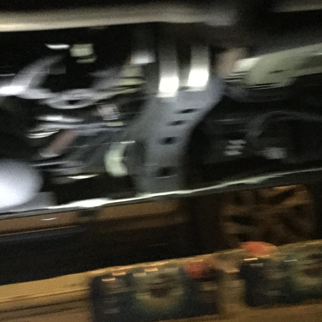

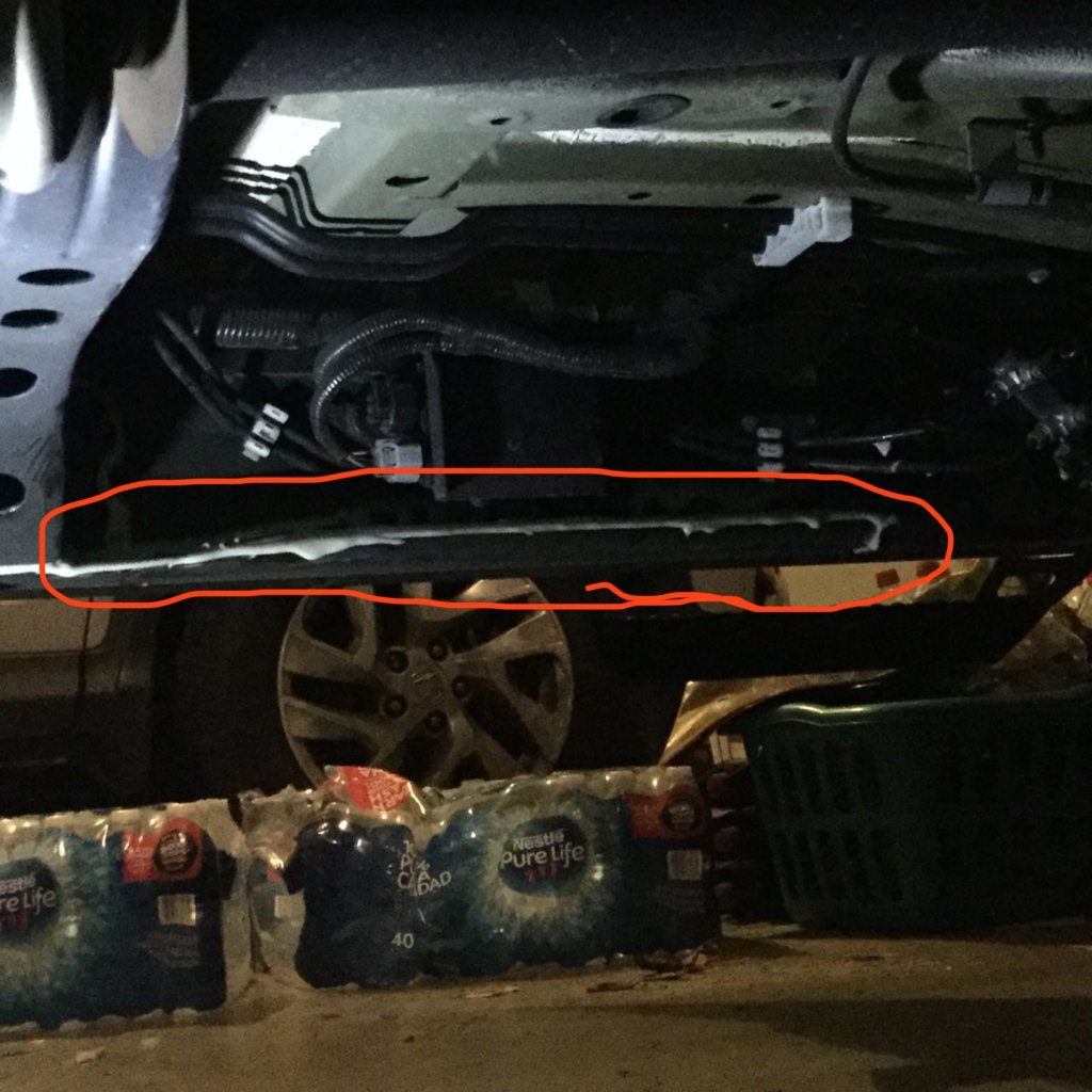

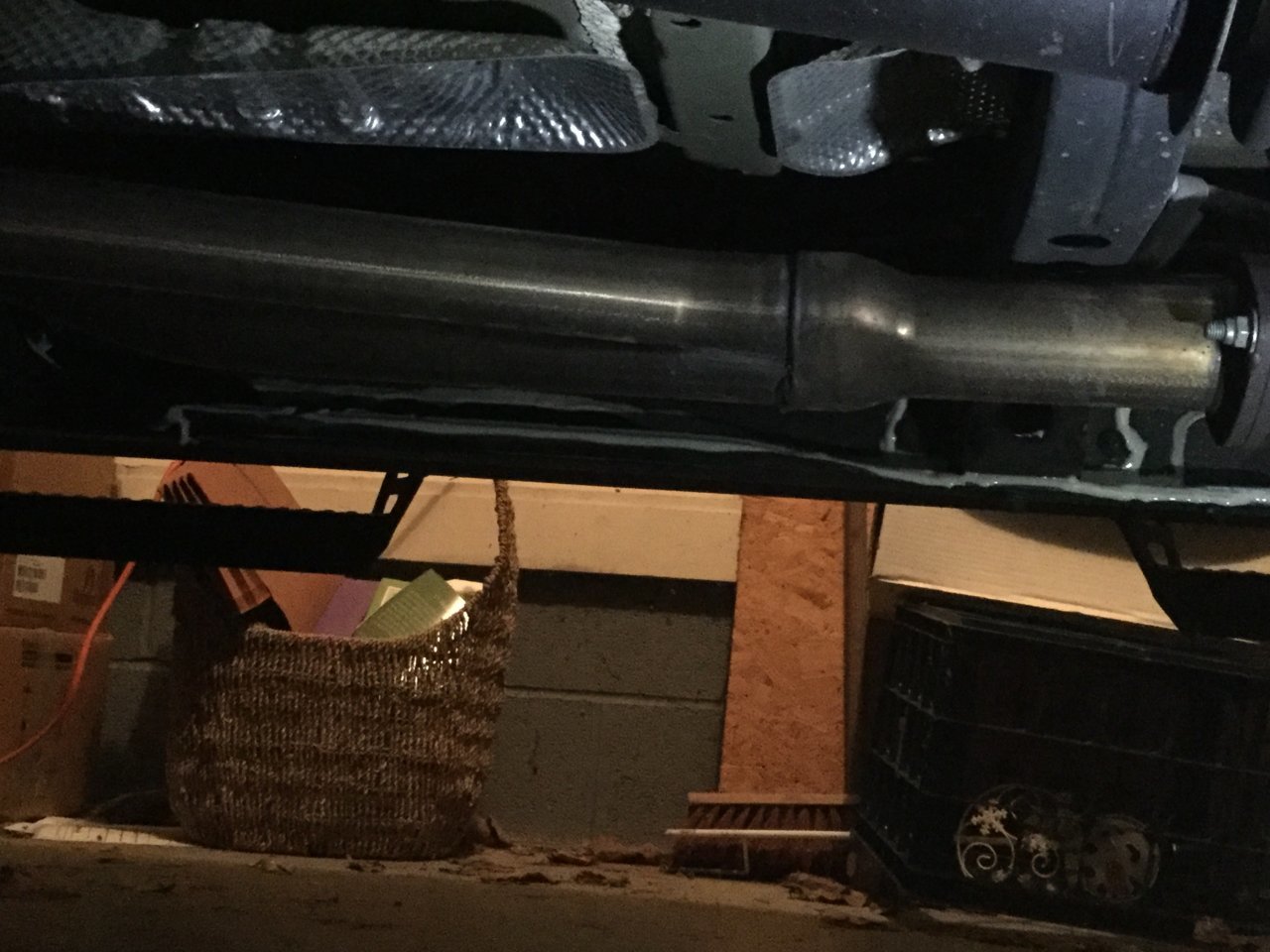

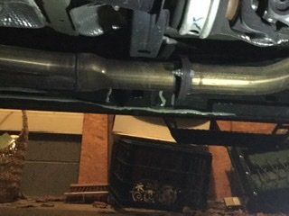

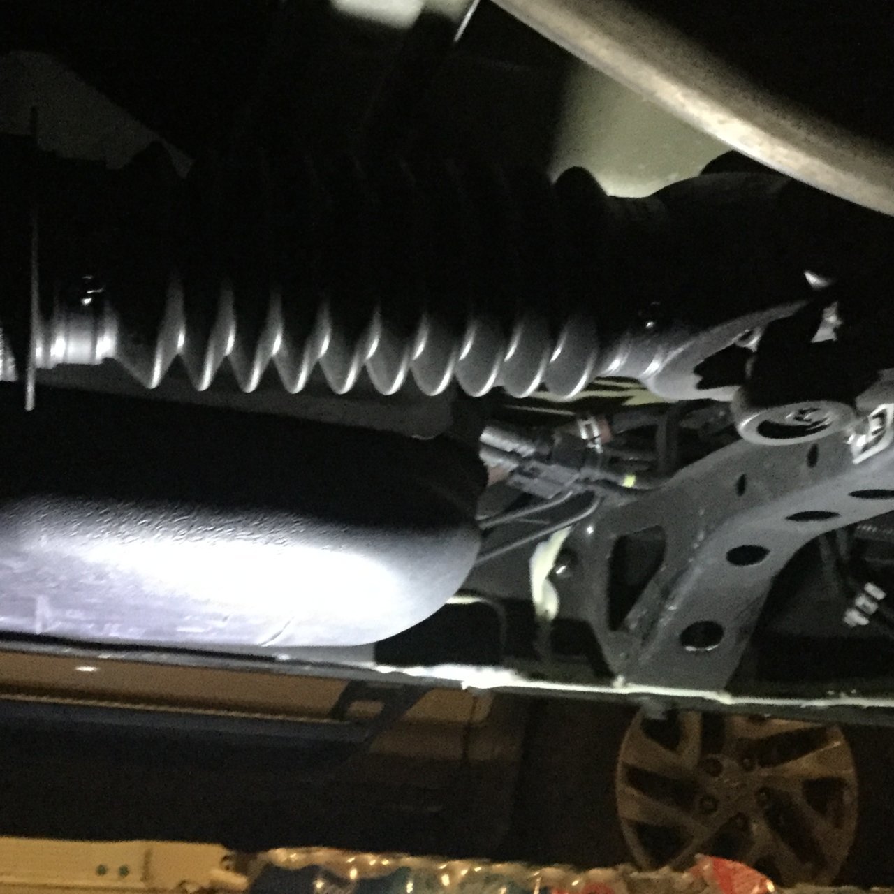

    4A54F96D-2574-4793-A59A-B26212CD6D07.jpg CC5225DE-AE7F-4320-B137-85F1B3B14FA3.jpg 3A522182-7011-4B47-83EC-B8D6F0CD25F5.jpg EDCC0A0F-F503-41AF-94CE-2871DD4D7AA4.jpg A58CF627-4A46-4097-9CB2-1C96B1D52C80.jpgThe white goup is what was put on. My photography skills are not the best.4A54F96D-2574-4793-A59A-B26212CD6D07.jpg4A54F96D-2574-4793-A59A-B26212CD6D07.jpgCC5225DE-AE7F-4320-B137-85F1B3B14FA3.jpg 3A522182-7011-4B47-83EC-B8D6F0CD25F5.jpg EDCC0A0F-F503-41AF-94CE-2871DD4D7AA4.jpg A58CF627-4A46-4097-9CB2-1C96B1D52C80.jpg

    Jeezuz.........hold the mayo!!!
    Is that stuff sticky or is it more like silicone?

    If I were you I’d be pissed they sprayed it on your camera

    Neither, it feels wet a little on the wet side.

    It’s hard to tell from the pictures. Do you think they did a good job? Also is that white goop all up inside the front boxed sections as well?

    Man, that just looks like a caulk job from a bad caulker.
