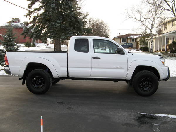

    BULL BAR,DRIVING LIGHTS W/ OEM SWITCH,BLACK STOCK WHEELS,265/75/16 TIRES,XM RADIO,EXTRA BED D-RINGS,SPRING TSB,5100'S @ 1.75",FOG LITE MOD, A/C COMP.MOD
    I HAVE TSB SPRINGS IN REAR, GAVE ME 1" IN THE REAR AND HAVE 5100'S SET AT 1.75" WHICH GAVE ME 2" OF LIFT IN THE FRONT, I HAVE A 1" RAKE FRONT TO BACK NOW. USED THE STOCK SR5 WHEELS AND 265/75/16 A/T TIRES. RIDES GOOD AND NO ALIGNMENT ISSUES.

    skistoy I'm def. a fan of your truck.
    DIRTRIDER thanks for posting that pic, setup looks damn good.
