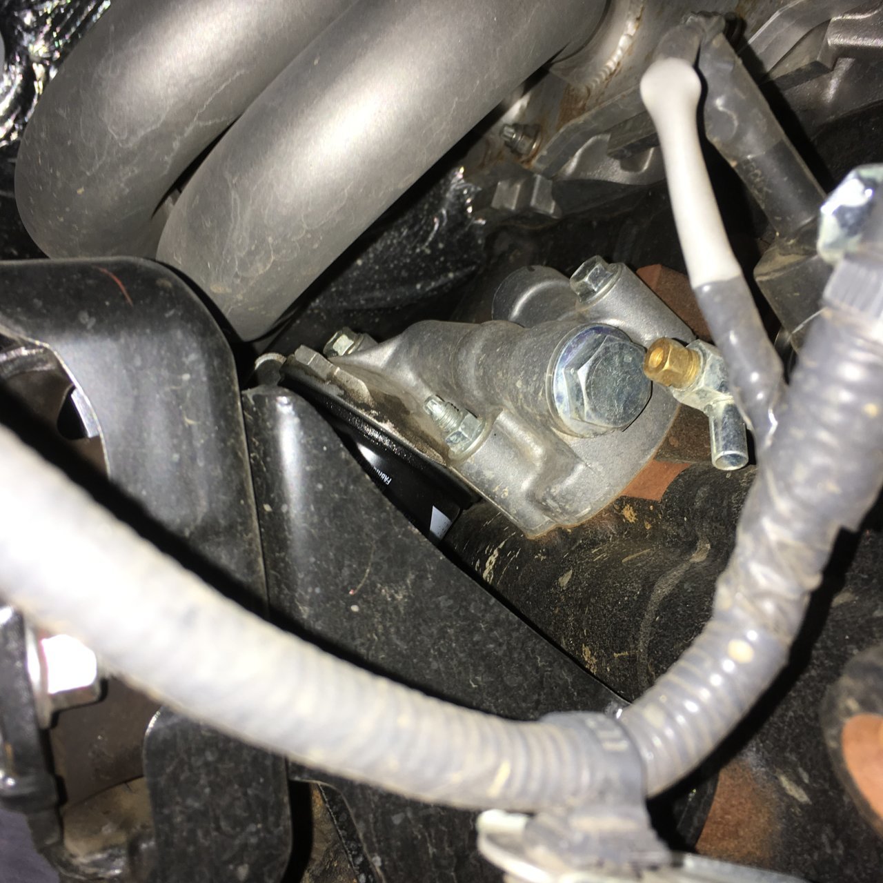

    At first I was thinking the best choice would be that big obvious post-filter outlet because then you could at least get some sort of idea of post-filter pressure drop, but then I saw that tiny little brass fitting right in front of it and I have no idea WTF it is even for! And then... both of them are absolute bastards to get at, such that I'd probably want to pull the whole passenger's side suspension to work on it comfortably!

    I'm pretty sure the pressure switch is right there, that grey wire in the foreground getting blown out by the flash.

    Alas I sold my 2TR equipped Taco in 2020 but I do have a picture that's gonna get you in the right neighborhood.
    This is looking from the front of the truck towards the back, the big silver thing is the oil filter mount and you can see the black filter peeking out over the motor mount.
    See the only brass nipple looking thing right by where the blurry wire harness is covering? Right about there.
    Sorry I can't give you an exact picture but you'll find it. There isn't much there to mix it up with.:thumbsup:

    Thanks for the reply, that did help get me in the general area. I did some digging in the FSM and found some more info on this for future reference in case anyone else is looking
