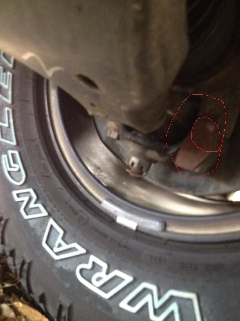

    I was having a similar problem, so I asked my mechanic what was causing the popping sound and he told me it's the turn stop located here:
    You see where the metal is rubbing on the turn stop (circled in the midde)? Put some grease there and see if the sound goes away, it worked for me.
    My .02
