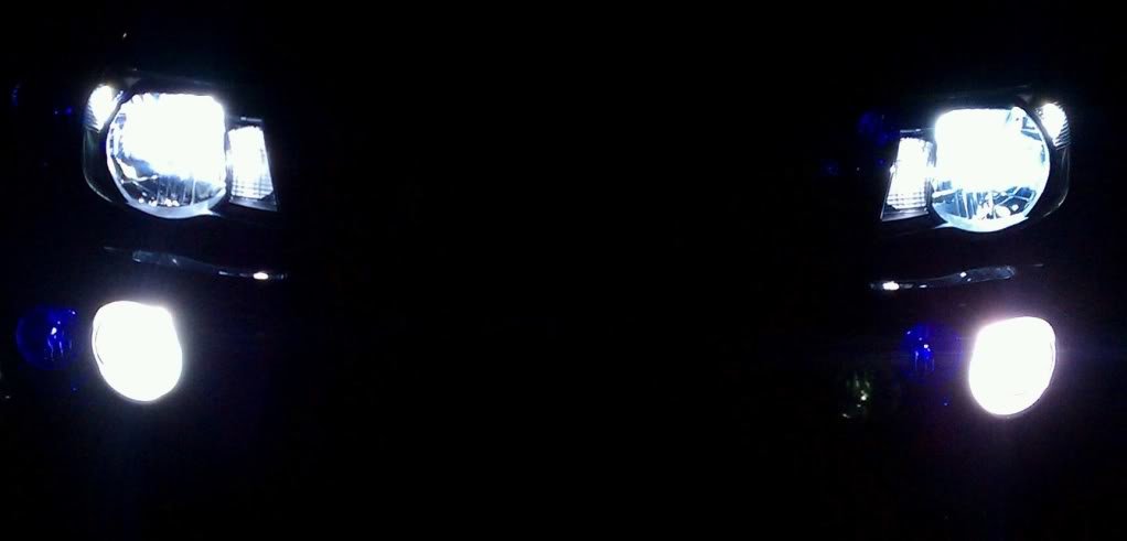

    I have a set. Amber is not that bright but does the job.
    Here is a pic of them installed.
    Edit: btw 92 version are too long and do not fit

    the fuse is most likely blowing because tacomas use CK wiring, check your bulbs and make sure they are CK not standard see the photo above as a reference, CK has grounds top and hots bottom, standard has grounds left and hots right. Emanon - Looking good, what are you using for your fog lights and low beams?
