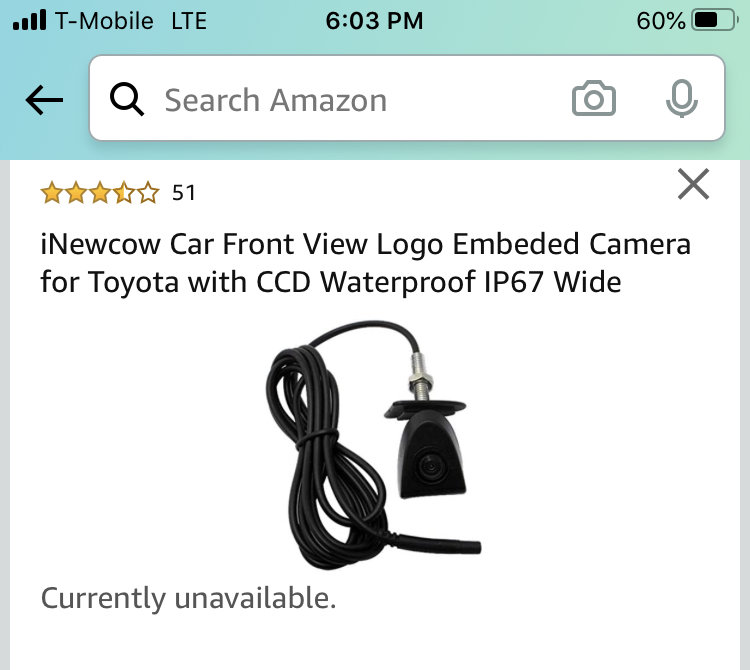

    I did install a front camera when I got the Taco. As long as you have a plug-n-play kit, the worst part is fishing through the firewall.
    The camera that I have fits the badge on my cheese grater grille:
    https://www.amazon.com/gp/product/B00P2EN5J2/ref=ppx_yo_dt_b_search_asin_title?ie=UTF8&psc=1
    There used to be two version. Non-wide angle that fits the center hole and looks a bit like Gonzo's beak and that one, which is wide angle. I should have grabbed that one, but mine is working very well.

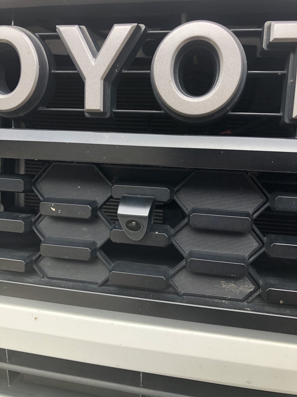

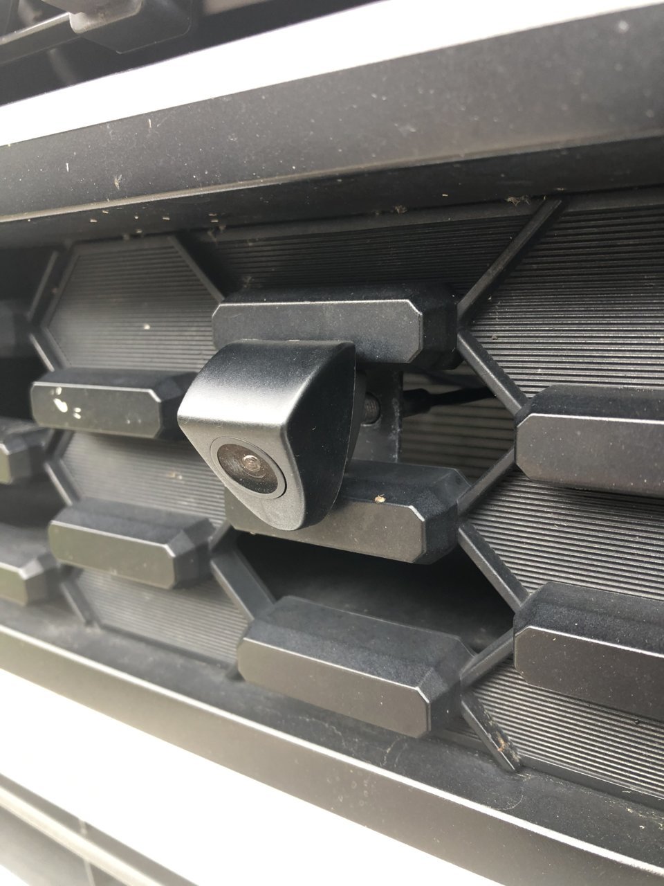

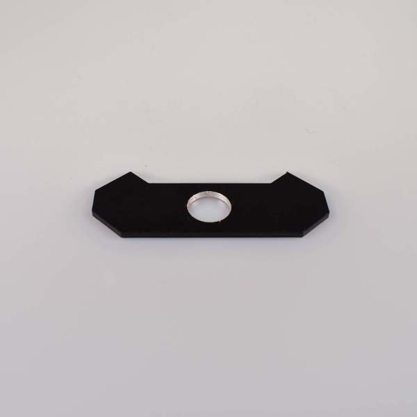

    Finally got mine in, took like 2 weeks for them to ship the damn thing! It does fit the row above "TOYOTA" however if you invert it, it's too tall to fit on the first row. I ended up not using the Pro grill mounting bracket. Since I have TSS on my truck, the garnish is flat so I was able to make this camera flush in front of the garnish by drilling a hole and dremeling some plastic away so the nut can fit snug. I have a bracket for sale if anybody is looking for one. [​IMG]

    Got any pics of your install?

    1211A5A4-8E2A-4DF2-9CAA-781153E13513.jpg C323DDCE-B804-44BF-8BE7-F5FFC0AEE834.jpg 7AD316B5-142E-408F-8BCE-017512F501DC.jpg

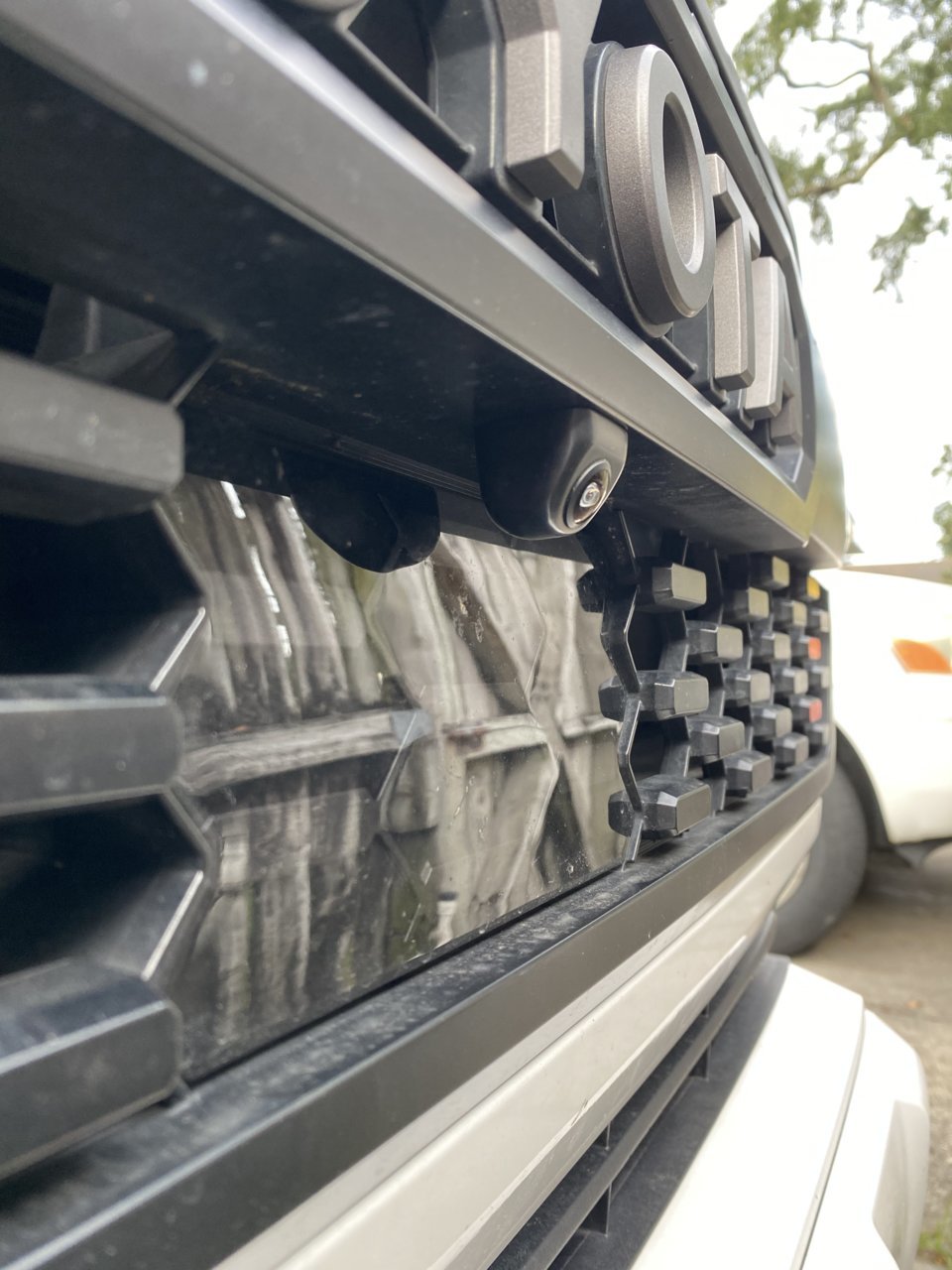

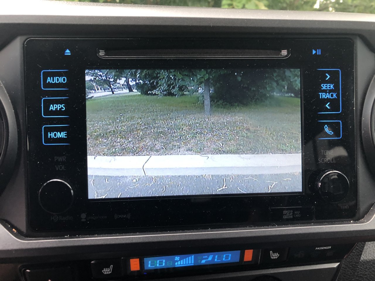

    I don’t have TSS...but a large washer or flat piece of metal works just fine.
    0D18208E-28E9-4CC9-8C69-EE6A2D309D80.jpg 1899A743-7336-4B92-916F-D80930666F05.jpg

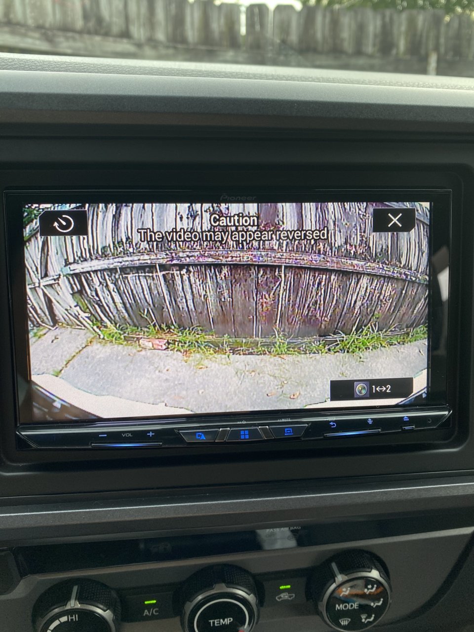

    What camera is this? How is the picture quality?

    Picture quality is as good as the oem rear if not alittle better.
    E4189BB0-7FD6-4B85-B9AE-7CB671A6348A.jpg 1A76FBA6-AA72-4D7B-B7B6-5FF9E71F12E2.jpg

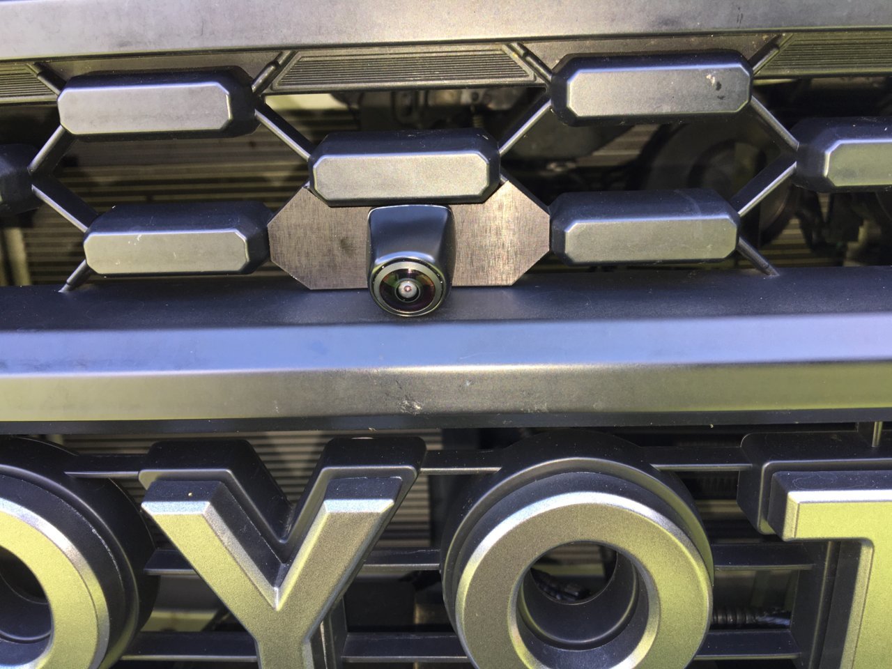

    Finally got around to updating my front camera mount .
