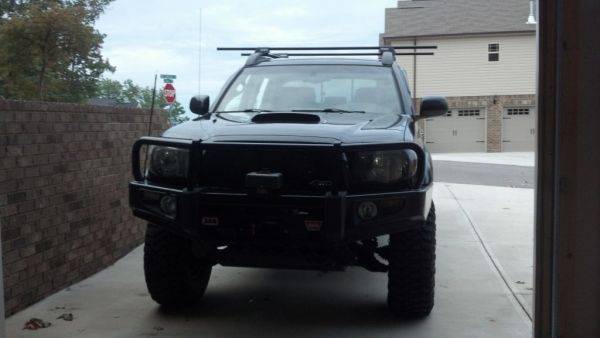

    A few bolts are different.
    Went with the 78" bars so I can put my canoe and stand up paddleboards side-by-side on the rack. The bar ends are pretty much even with the mirrors. Overall I like the facotry rack much better. I dont run arround with the 78" bars on there. I also believe my gas mileage has gone up slightly without all the yakima stuff up there 24/7.
