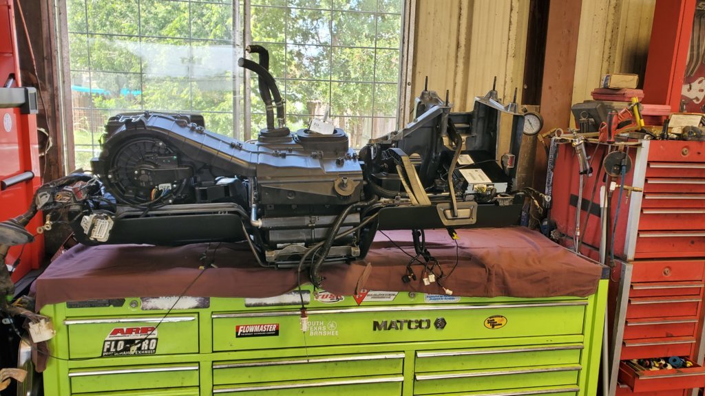

    It’s not great in the older ones either.
    Got to pull the whole dash and the accumulator, so you have to disconnect the AC. Then some of the guys that got a cheap one at autozone or such would have to do it all again 2 years later.

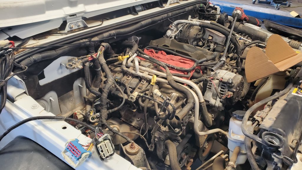

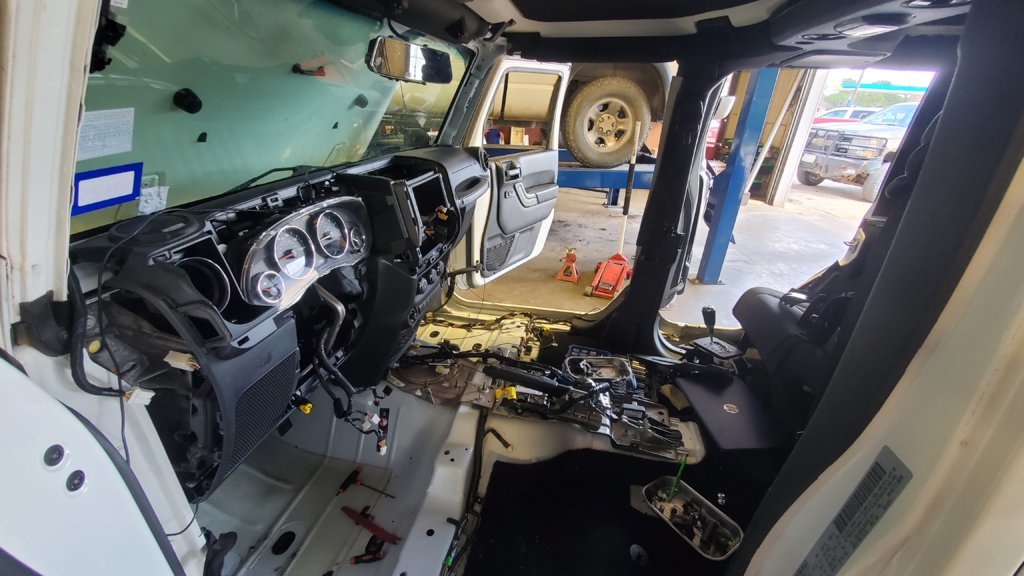

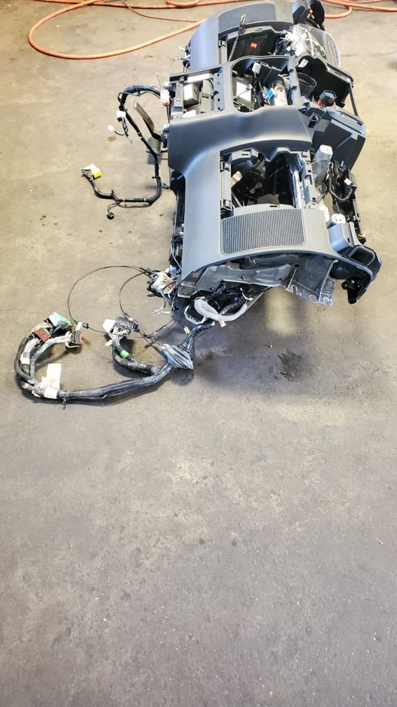

    It's cake on the older ones compared to the new ones.
    You have to pull the dash on pretty much everything nowadays to do heater cores, evaporator cores and sometimes blend door actuators, I do it pretty often.
    It's generally not that difficult once you have done a few but I did a 17 Wrangler (only 16k miles) a couple weeks ago and that has to be the most poorly thought out conglomeration of stuff slapped together I've ever seen, it's like everything was an afterthought.
    You have to literally take everything apart just to get the dash out then take the dash apart some more to get the HVAC box out of the dash.
    Definitely not a job for someone new to pulling dahses.
    Here's some pics.

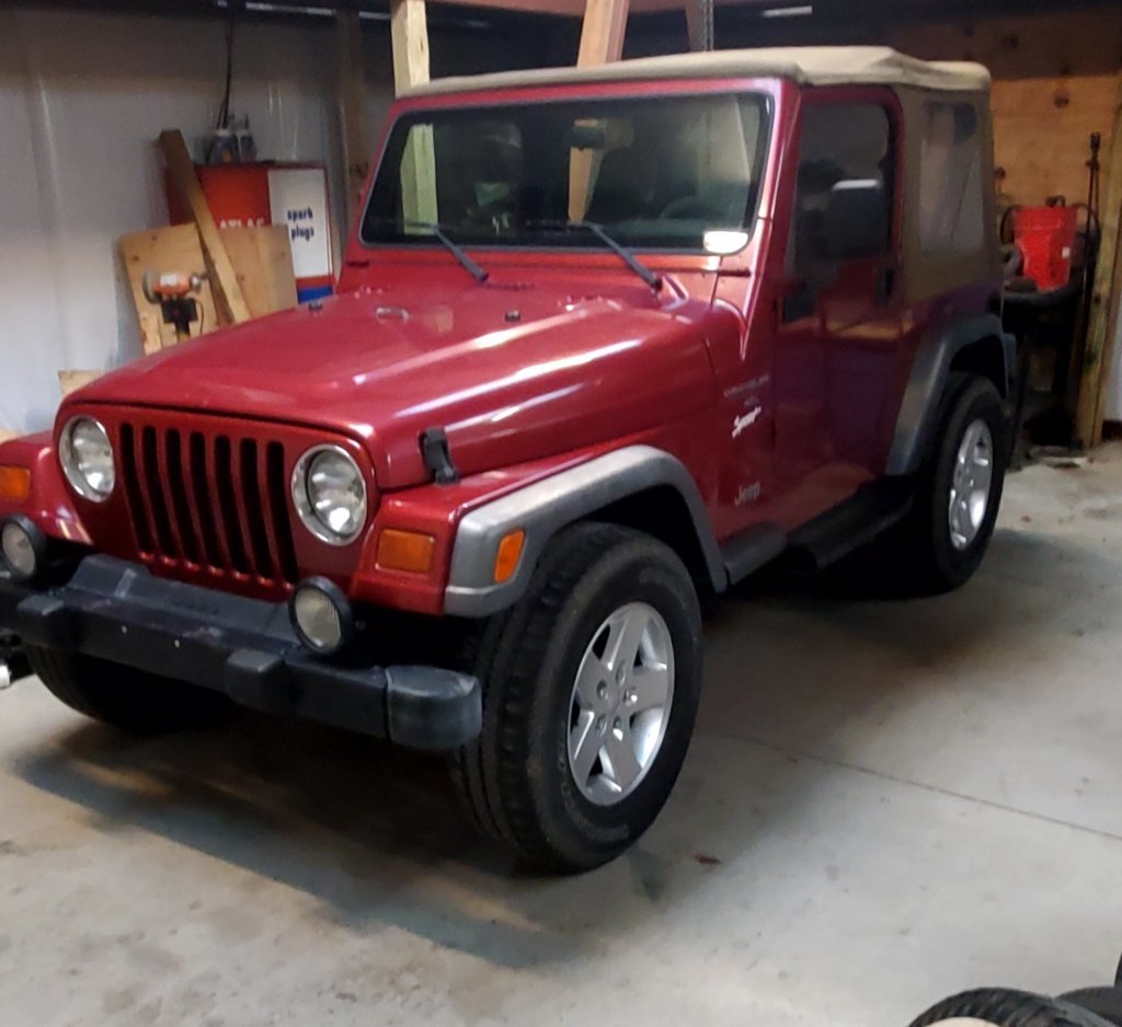

    I have two Tacomas, an '06 and a '15...
    ...and I also have a '98 Wrangler TJ, 4.0 and 5 speed.
    My Jeep was my daily driver from 2011 to 2018 (yes, this was while I owned my '06 Tacoma). In 2018, it was totalled when a lady pulled out in front of me. In 2023, I rebuilt it and had it inspected and applied for a rebuilt title. It currently has @285,000 miles... the engine is original, but the transmission has been rebuilt.
