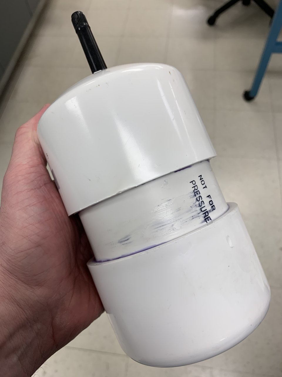

    Going to try this today. I have two sets of wheels. Just need to figure out what size hole to drill. Any reason you can’t use one of the censors itself to fill with air instead of buying the valve?

    Well that was a lot easier than I thought. If I did it again or if anyone is going to do this cut the 3” pipe shorter than I did (like zw470). Fits under the seat right in front of the jack.

    I don’t think it could get any more simple. Only took about 10 minutes

    made one of these but may have messed up and let too much air out of it. Passed a leak test submerged in water.
    what is everyone using to inflate them?
    I tried an HFT bicycle pump but it’s finicky and $15 for a big ugly pump
    rather have a cheap little soccer ball pump or something if that even attaches…
    found out unfortunately the self serve pump at Costco doesn’t work for this. I assume it’s too sensitive, small a volume, and machine not able to detect resistance of air like it would in a big tire
    I tried to set it cold 29psi but might have dropped the thing below that so will have to try it again. Didn’t know the truck was that sensitive. I’m guessing it’s currently at 28psi and tripping the warning even though door cold spec is 29…
