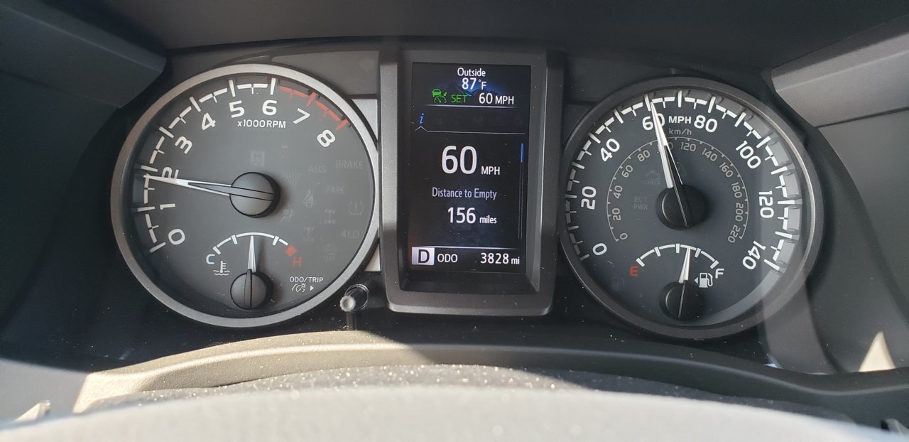

    Ok i took my truck to servco
    The guy that chcking in the vehicles
    Said since y truck is 2018
    It might have the updated tsb program on it already
    But he is going to check it
    It just so happen my truck didnt have it yet
    So they did the update tsb
    And man ohhhhh mann
    Its running soo smooth now like my old 09 tacoma
    More responsive shifting smoother
    None of that high revving anymore

    Very happy with the tsb update
    My cruise control is very accurate now
