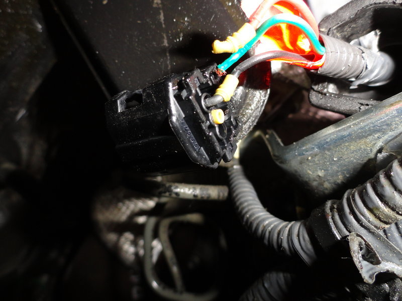

    I decided to replace my sensor as a preemptive measure. I had difficulty removing the electrical connector. It's covered by a rubber boot and it's hard to move the boot out of the way because the boot is taped to the harness. I ended up damaging the wires where they entered the connector but the damage was hidden by the rubber boot.
    After I put the new sensor in, the check engine light came on so I thought I might have a bad new sensor. I put the old sensor back in and still had the check engine light. I figured that the only other thing that I touched was the wiring so I opened up the harness and found the damage.
    My first attempt to repair the damage was unsuccessful so I ended up buying a new plastic connector (part # 90980-12353) and new terminals (part # 82998-24250). The terminals are the metal pins inside of the connector. The replacements had a short length of wire already crimped to the metal pins. I assembled the new terminals into the new connector and spliced the new wires into the wires on the truck (no easy task given the location).

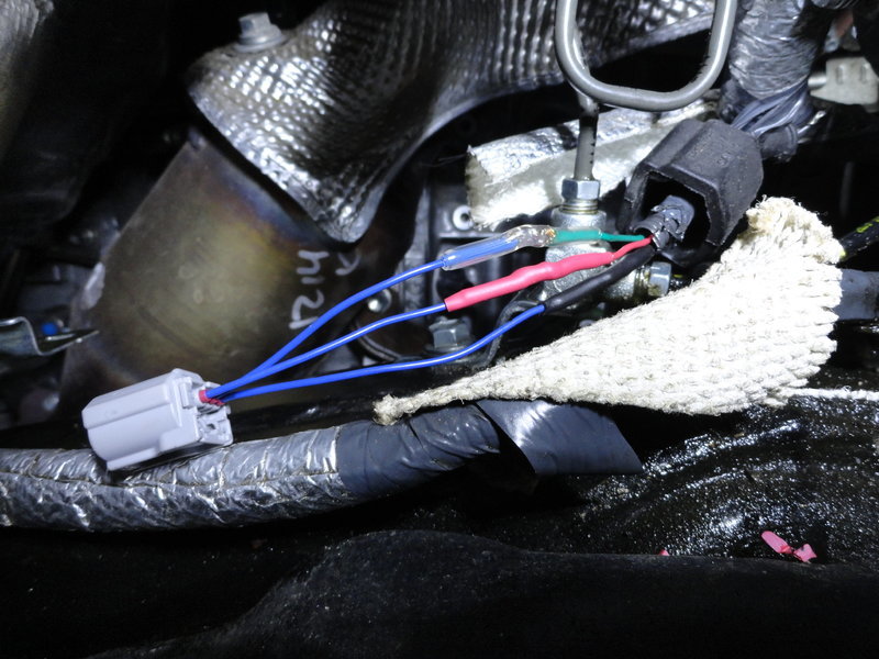

    Here is a picture of the damaged wires and the repair. Trust me, you don't want to have to do this.

    Damn, you really fucked up them wires huh. Some people are just better off leaving it to the professionals...

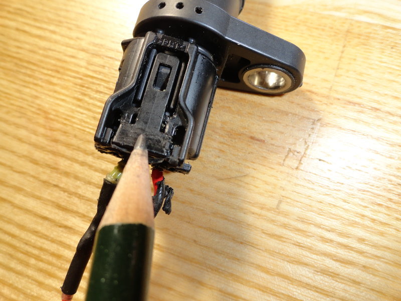

    Once you get down to the connector what do you have to do to actually have to do to release its lock before you give the final pull?

    The tip of the pencil in this picture is the exact spot that you need to press to release the lock.
    You can see the lock above it in the picture. It's on the side closest to the converter.

    How does the repair look fucked up?

    Same question here too. The heat shrink looks great.

    I think he was inferring the initial attempt at swapping the sensor which caused the repair.

    Thanks for posting the picture. It helps.
