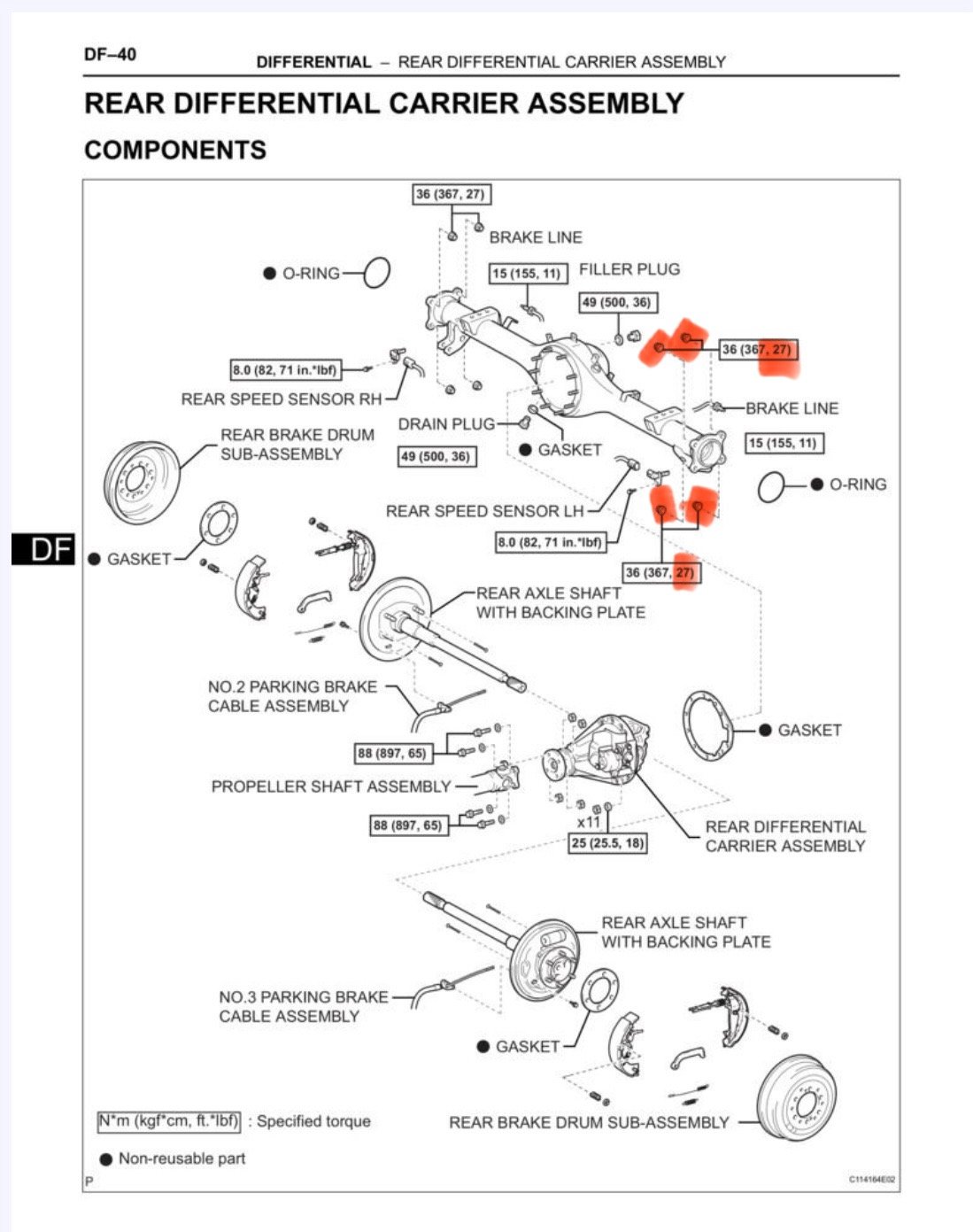

    Anyone have the torque specs for the four nuts in question?
  15. Feb 28, 2024 at 11:57 AM
    #115
    faawrenchbndr
    faawrenchbndr Til Valhalla
    Jul 17, 2011
    #60024
    2,590
    Greg
    Denver, Indiana
    ‘23 Sport 4x4 DCSB
    service manual calls for 27 lbs ft

    I see where the nuts are located what I am wondering is if you have to the drums to get to the backing plate to put a wrench on the bolt to tighten down the nuts.
  19. Feb 28, 2024 at 12:31 PM
    #119
    Thegrassisalwaysgreener
    Thegrassisalwaysgreener Well-Known Member
    May 31, 2023
    #425767
    305
    Manitoba
    They are pressed in studs not bolts with heads you have to hold onto to tighten.
