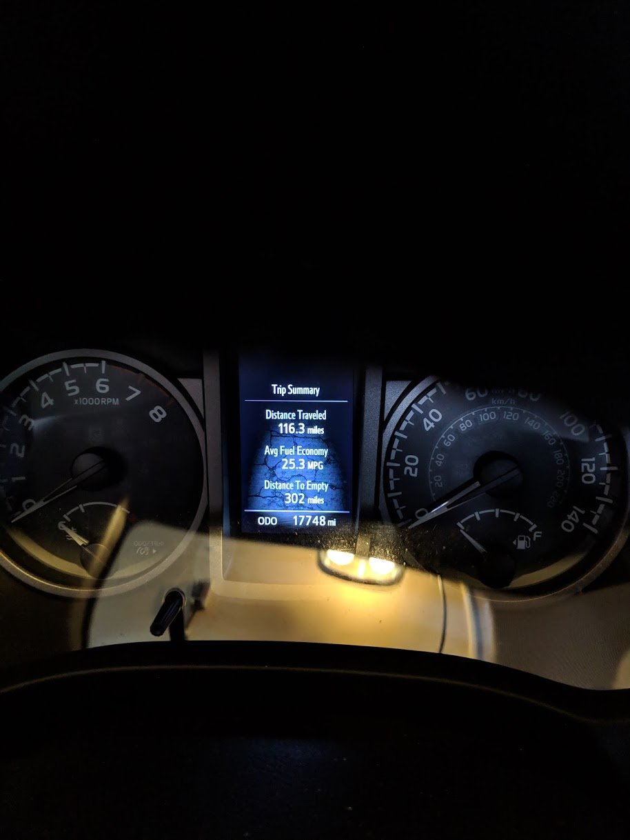

    2019 Tacoma TRD Off-Road DCSB Magnetic Gray
    I got 25.6 today, AT trans. I have no idea how I pulled that off. Must be a glitch in the matrix
