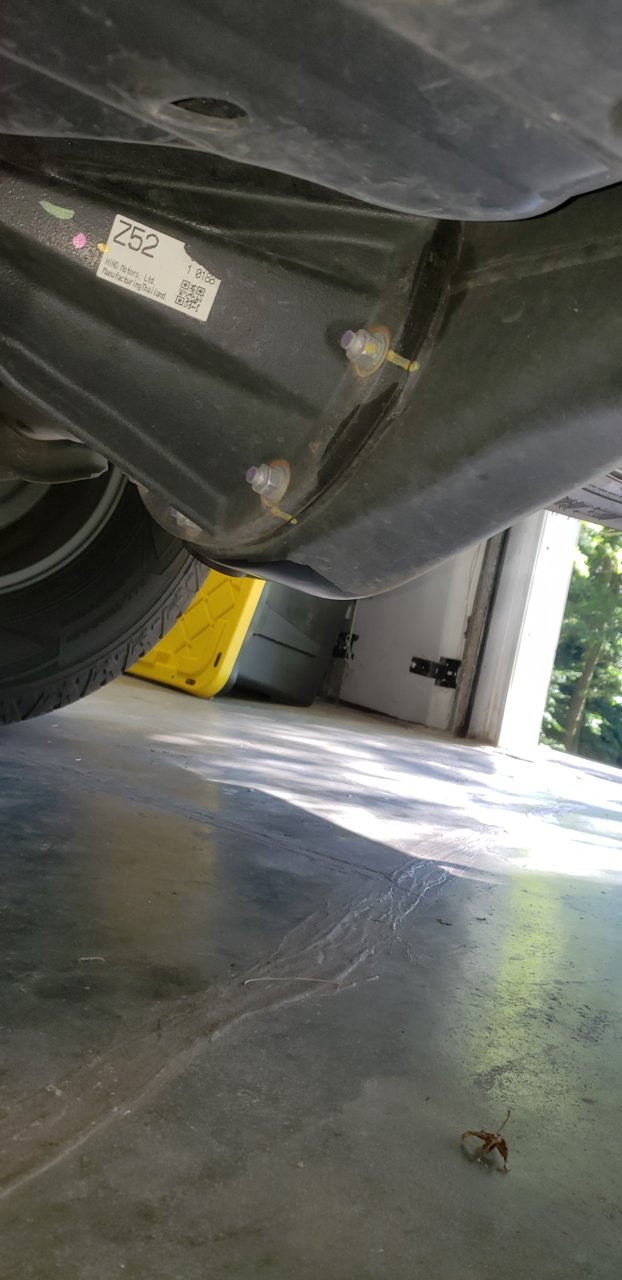

    Smacky2020
    Smacky2020 Well-Known Member
    May 4, 2020
    #326715
    791
    Bristol, VA
    2020 TRD ORDC - Cement
    Stock wheels and suspension. Random "utilitarian" mods featured on this great forum.
    Yes to a '20 having similar thing. Not calling it an issue because I'm not truly worried about. Got it checked out by dealer who confirmed it wasn't a leak (just to get it logged) and will continue monitoring. Hasn't gotten bigger or leakier since I took the picture few months ago. No diff howl or other popular complaints.
    The hammer and myn75[OP] like this.

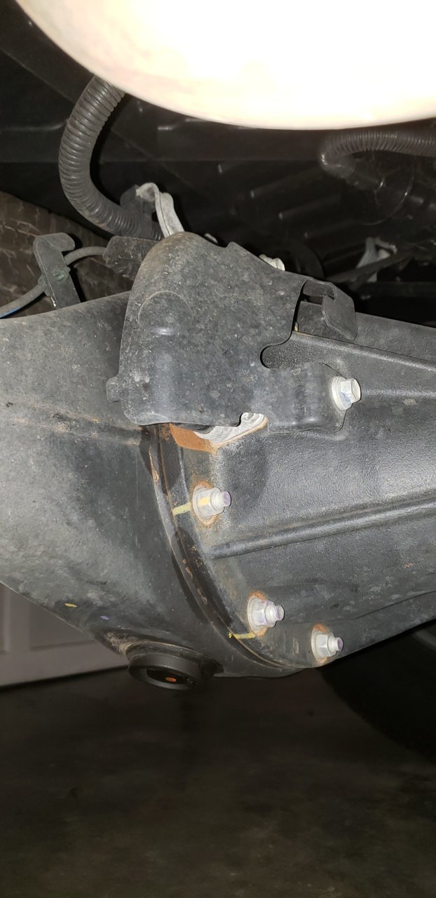

    myn75
    myn75 [OP] Well-Known Member
    Dec 6, 2020
    #348879
    593
    Nor Cal
    2021 TRD Off-Road 4x4 DCSB, 1996 4runner SR5 V6 4x4 auto
    ARB OME BP-51 2”, TJM sliders, AT3Ws, Diode Dynamics SS42"
    im not saying my seep lost a whole quart, it was most likely low from the factory. regardless i was able to put in a whole quart on level ground

    myn75
    Dec 6, 2020
    #348879
    593
    Nor Cal
    damn, yours looks exactly like my friends' truck. id be pretty annoyed at that much seepage.

    The hammer
    The hammer Who’s the Wrench?
    Mar 7, 2016
    #180475
    3,880
    '16 Tacoma SR5 4X4 DCLB TSS Pkg 17X8" BSW-Cooper DIscoverer AT3 4s P265/65/17
    Underworld Flex trifold, tinted, TRDPRO grill, TRDPRO shift knob, etc,etc
    Yes
  17. Jul 31, 2021 at 2:07 PM
    #37
    The hammer
    Mar 7, 2016
    #180475
    3,880
    Any diff oil seepage found should be followed by a check of the diff pressure relief valve, a proper torque of all fasteners in the proper sequencing should be performed, the diff oil level and axle oil seals should be checked for leaks as well and any stains cleaned for future follow inspection.
    The diff gasket replacement is an intrusive repair, and not a 30 minute job, and no seep should cause the loss of a pint. It is best to avoid it if possible.
    Keep it clean, be safe
    Junkhead and myn75[OP] like this.
