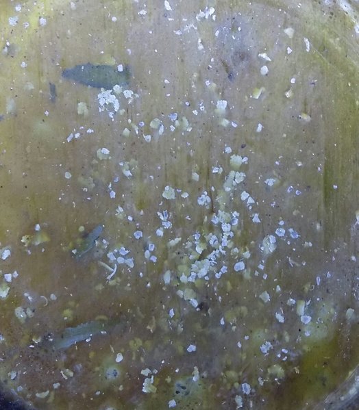

    I have not been on the forum for a while because I have been fighting with dealership over what I found in my engine after head gasket replacement. (Picture attached). The MORONS at the dealership machined my heads! Under no circumstances should you ever machine the heads on a 1GR-FE! At minimum your timing will be a hair off forever! Well... they machined the heads, but didnt clean them properly! So ALOT of aluminum shavings got into the engine. I did not know this until about 2500 miles later when I changed the oil and drain pain was full of aluminum shavings and glitter from the bearings being shredded. I have basically left the Tacoma parked. Long story short, the dealership is 128 miles away. I also have a 2011 Ford crewcab F150. and they wont pay for a tow. Anyone ever hooked a tow bar to the front to pull your Tacoma?

    The black stuff is remnants of the old cam chain guides they replaced. When they removed the old guides, they cracked. No one bothered to see if debris was left.

    Timing will adjust due to variable intake, on intake side. If the heads are machined, then a gasket needs to be ordered accounting fornthat material loss. That will account for both intake and exhaust.
    I have had plenty machined on the 1GR. They simply were reluctant to be thorough. Ehich is shit.
