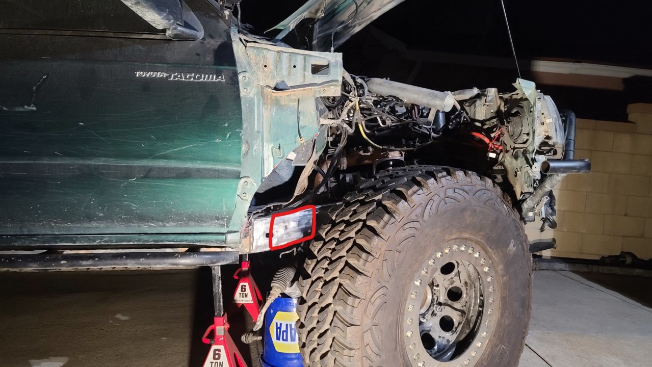

    Yeah right here:

    So the frame actually bends in towards the middle in the front of the truck. I have plenty of room up there, it's only on the tail end that I have issues.

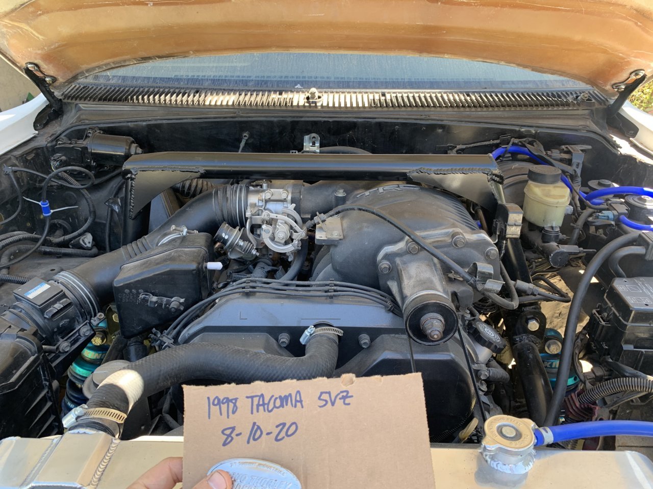

    Oh good idea! I could probably run one from shock tower to shock tower like those good ol race Civic's. Since I already cut my fenders and tubed my front it would be super easy.

    Yeah plating the frame is standard practice on most go-fast trucks keeping the factory frame rails and hard hits will twist the frame in on the engine so if the c notched area proves to be weaker than it was before, the cross bar will keep the frame from twisting as much at this stress concentration. It’s a necessity on bigger suspension / higher speed trucks so definitely useful on a truck that might have a little more tendency to twist at this point. They aren’t that hard to make and can be easily fit under the 01-04 hood.

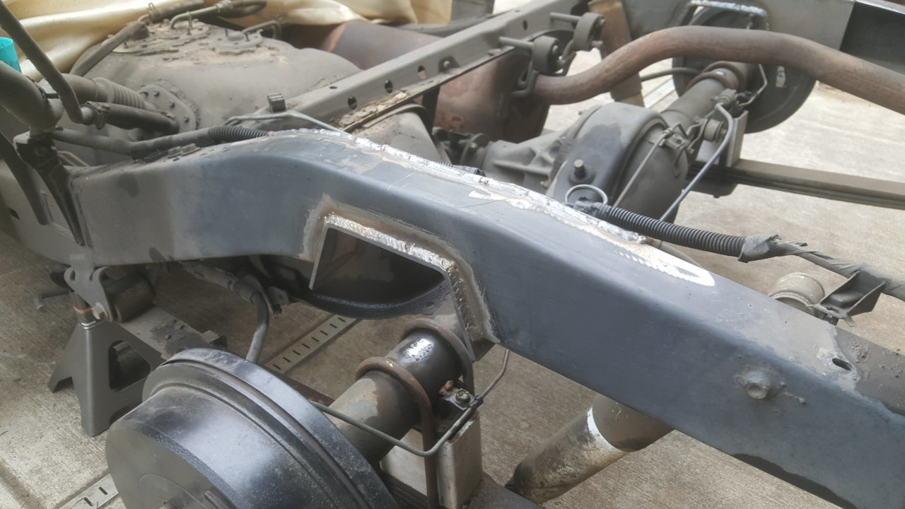

    Don't notch the frame if you are going to do this, it will make it a PITA when you do the frame chop. I would adjust the steering stops, run wheel spacers or a smaller tire in the interim. It just seems like double the work that will drive some headaches later on. All my frame fish plates when I did my chop run right over that area you want to cut.
