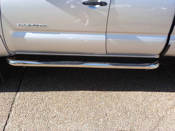

    I can get them installed for $329 ( Trail Fx or Westin) plus taxes but seeing some on ebay for $141 though the brand is Automax. Just wondering if you guys put your own on or seen it done and is it easy, PITA, or what. Holes have to be drilled im sure. I mean with 2 people and lining it up it shouldn't be bad to mark the holes and do it but just wondering. I might just get it installed and put on at same time i get the cover done. By the way I found a good price on a used cover and they are going to install it

    most steps use pre-existing tapped holes under your truck, and will have the proper bracket to utilize them. People usually don't have to drill new holes in the truck.

    It depends if they are bolt on or weld on. If they are bolt on, the holes are already there and it should just be a matter of holding it in place and bolting it in. For some brands there may need to be additional holes drilled but most should go where the factory ones were/are installed.

    I don't think hes talking about sliders, just side steps/nerf bars

    My 2013 Access Cab already had drilled and threaded holes in the frame for the side steps. It was just a matter of lining up the holes and bolting the steps in place. Check the frame of your '04, the holes may already be there.

    you should be able to loosely thread the brackets into place on the frame, lay the step on the brackets, center it up, loosely thread the step onto the brackets, then go back and tighten the bracket-to-frame blots, and tighten the bracket-to-step bolts.-all of this you can do by yourself. should take you no more than 15 min per side.

    yes guys i'm talking about the nerf ones like pictured. I will check and see if it has the holes already and if so I will do myself :)

    I just bolted on a new set of N-Fab nerf bars by myself a little over a week ago. Easy to do as long as the bars/steps you are purchasing are using the pre-drilled holes. When you look underneath, you'll see little plastic screws that you can easily remove with your hand. Just unscrew those and you'll reveal the holes for the bolts.
