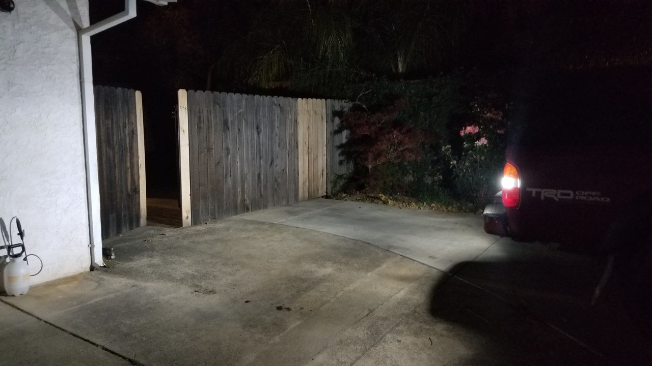

    These are just plug in replacements for the OEM ones. No real need for external pods, IMO.
    I got them from Amazon, but superbrightLEDs has basically the same ones.

    Those are cheap generic brand LEDs, you can find the same ones on ebay or others for way less. Obviously the output is greatly exaggerated and not to be believed.
    https://www.ebay.com/itm/AUXITO-T15...LM-White-for-Toyota-Honda-CSP-EA/303313419262
    Light output is initially high but will rapidly decrease. More reputable sellers will also warn you that the product isn't intended to stay on for long and risks overheating and early product failure, so might be great for a parking lot, but not if you need to reverse down long portions of a trail.
    You might consider this instead. One member ran both the lights you linked above and this HIR upgrade, and said the HIR upgrade was significantly better.
    https://www.tacomaworld.com/threads/gy6-35-hir-921-reverse-light-upgrade-vs-high-power-leds.474996/

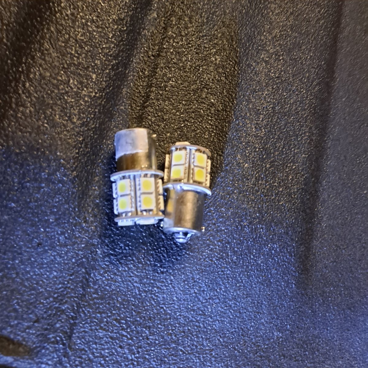

    I got Phillips LEDs thinking they’d be brighter but they’re not much better than stock. Really looking for a better solution that isn’t $55 like the dieselleds

    Thanks, but I have an 1156 bulb truck so I think my options are more limited than 921 trucks :(
