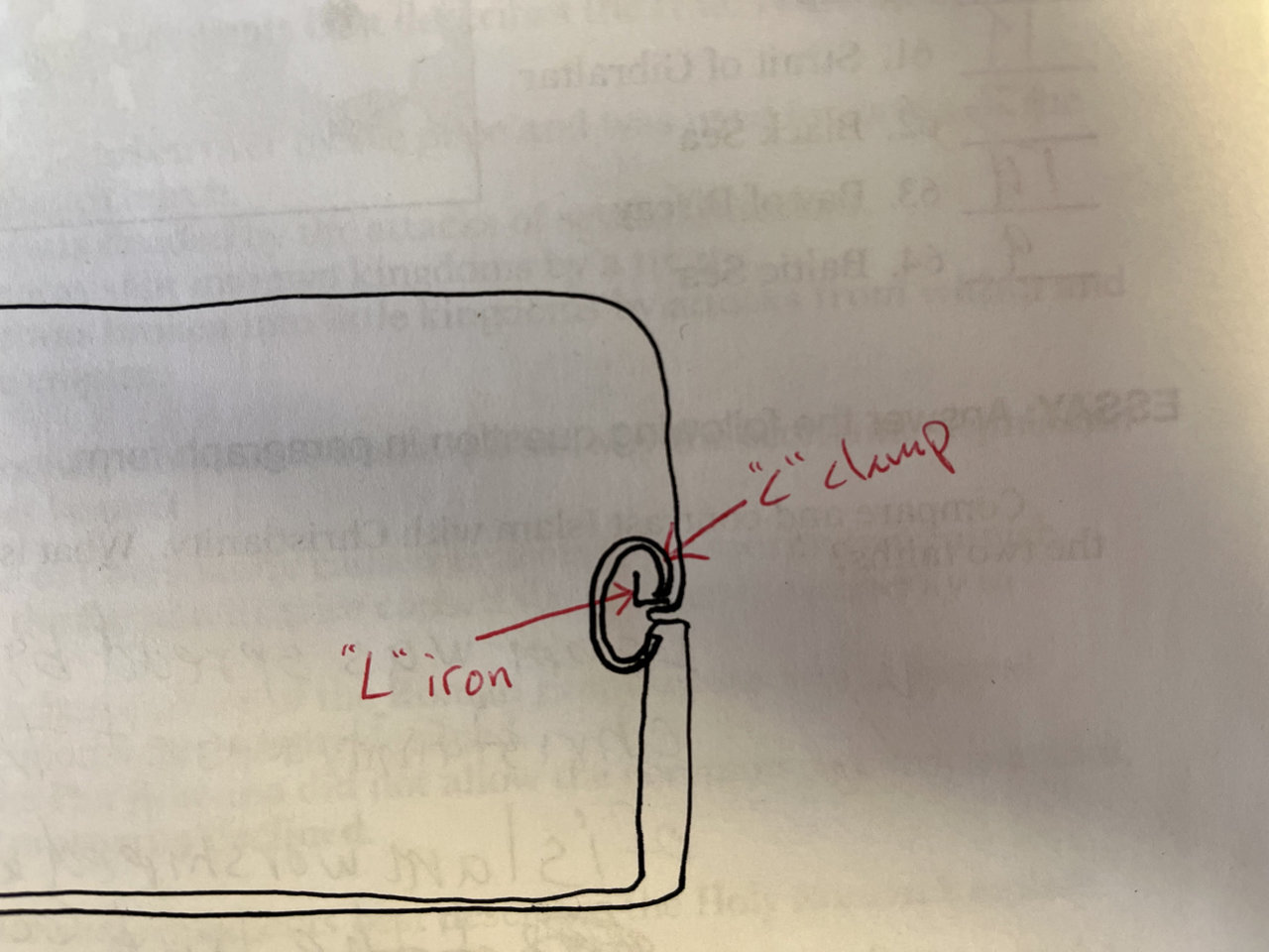

    So you get an L iron that is really long, running the length of the bed or so? And is it small enough to stay on the inside of the C clamps when the clamps are closed? if that makes sense?
    The top line is the shell, the bottom line is the truck bed, as observed from the rear.

    One of those things you can adjust to work with your dealing with.
    Yes in theory If your cap has a lip on the inside you might need a spacer under the angle iron to lift the angle to clear the lip
    then you can have the angle point in whatever direction works best up or down.
    Install your grippers where they work best if your first location is not ideal you can move them easy.
