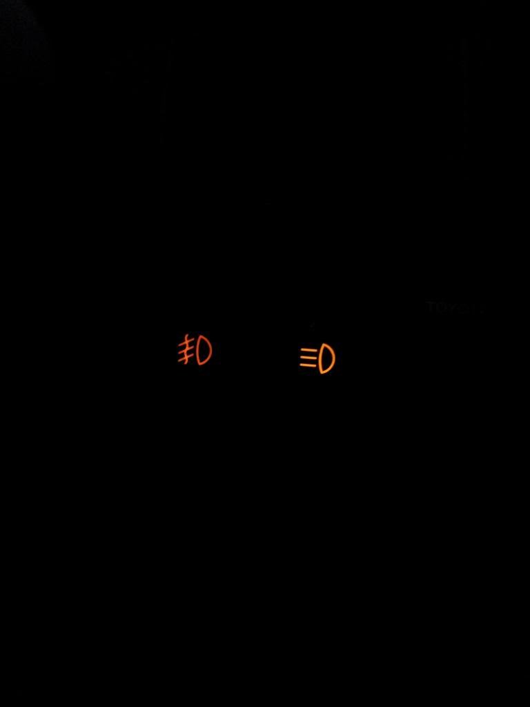

    Awsome! ya it does not seem to be to difficult, the only part where i second guess myself is getting the wiring right for the switch illumination and the switch LED.... i am gonna be picking up my avid bar some time this week so i will pm you when i get it and we can set something up.....

    well i bought the harness but they are two different guage wires, so im thinking about swinging by the dealershp and picking up the pigtails and using that instead.....

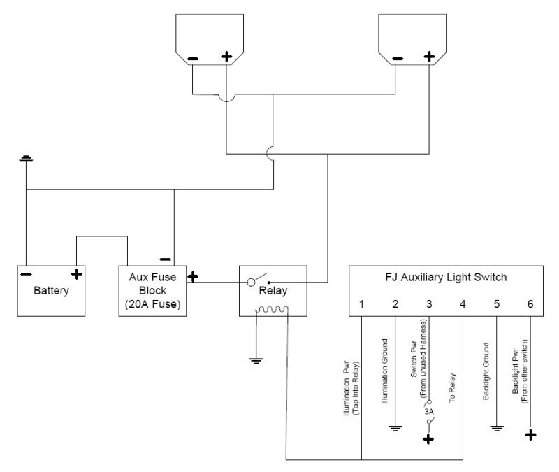

    Does it look like this: [​IMG]
    If so here is the wiring diagram. Pretty straight forward.

    yup that is it

    Looks simple enough. Let me know when your ready and we will get it handled.

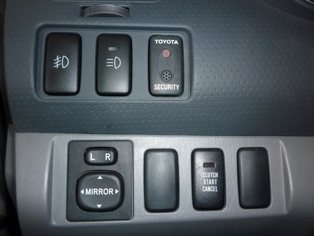

    Good choice of switch OP. Definitely makes for a clean install:
    I'm obviously a fan of OEM :thumbsup:

    ya that is what drove me to spend the extra cash for the FJ switch, like to keep that stock look.....
