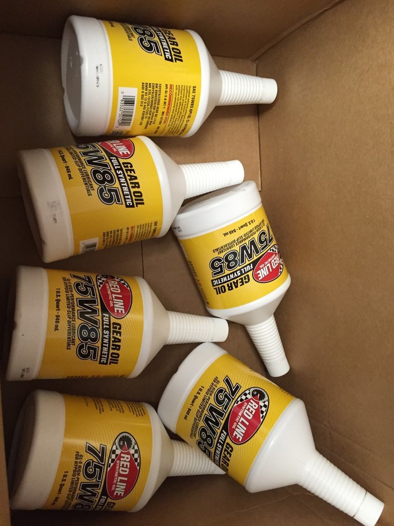

    changing my diff oils tomorrow. Mainly to get any wear metals out, any water from water crossings, and to upgrade to a high quality synthetic.
