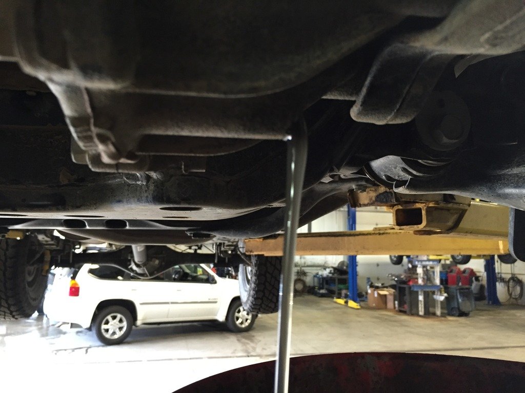

    Changed both my diffs to redline 75w85 today. Pretty dirty for only 3400 miles. And a good bit of metal on the magnetic drain plugs. I've probably got more 4wd miles than 90% of members though. And quite a few deep water crossings.

    yes, breather mod. I never bothered to check the level since I had to drain it anyway. Rear took 4qts to fill and front took around 1.7
