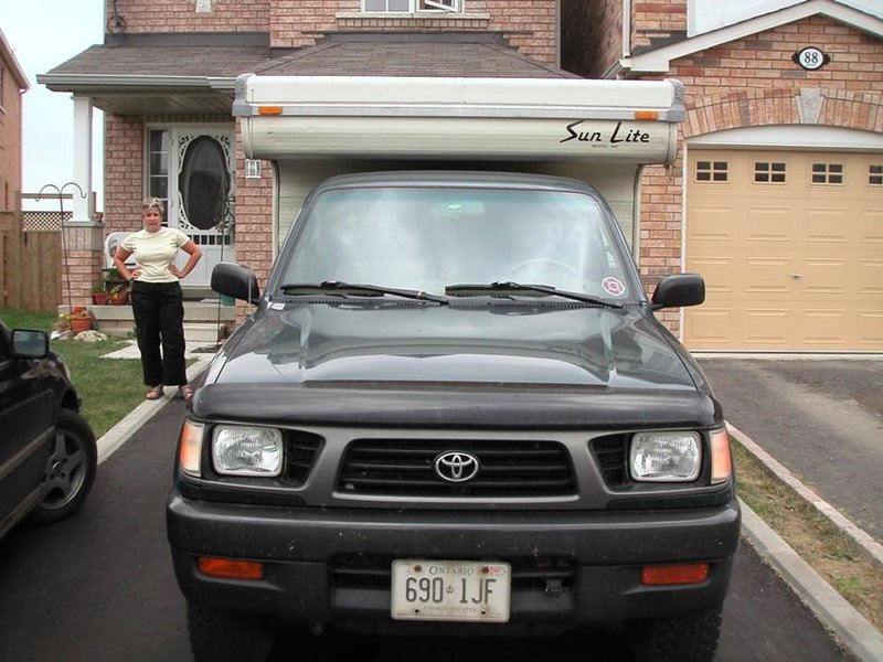

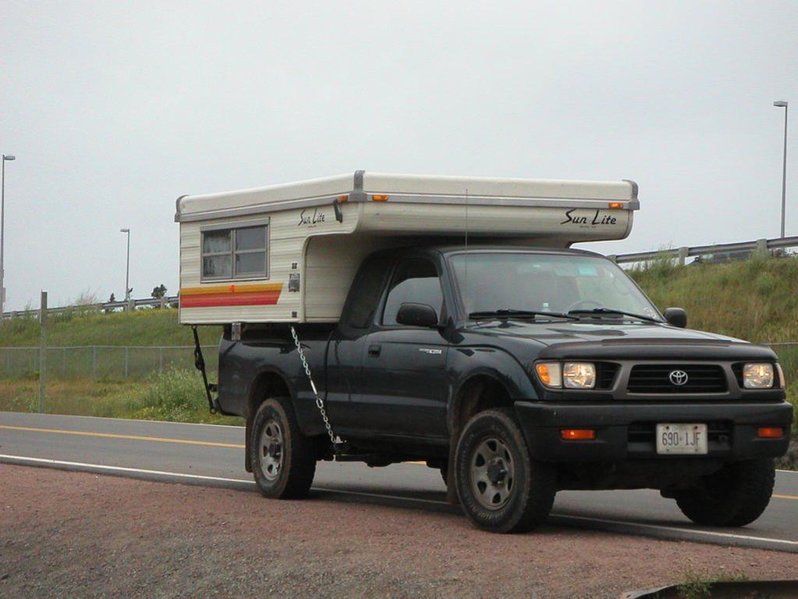

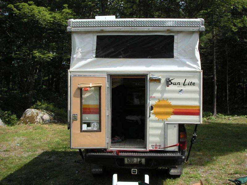

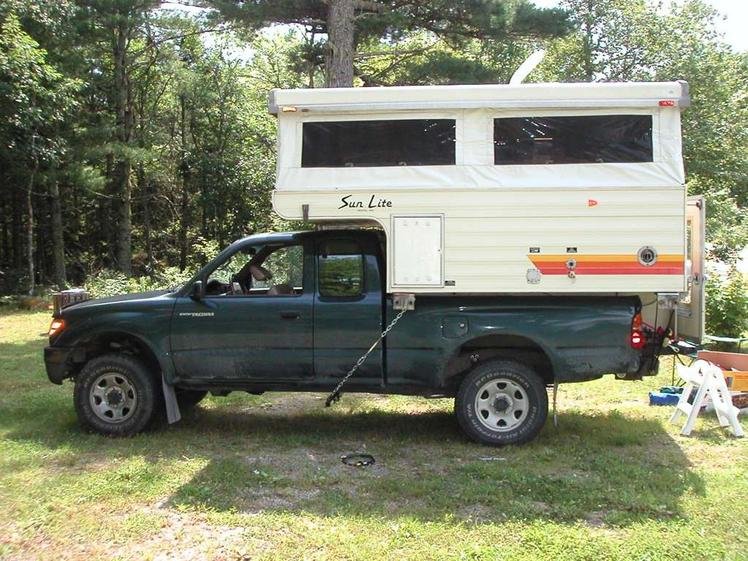

    I hauled one with my 96 Tacoma for well over 10,000 miles.
    Worked great in the truck, the 05+ with a V6 would be much better. ImageUploadedByTapatalk1406279417.893135.jpgImageUploadedByTapatalk1406279438.910481.jpgImageUploadedByTapatalk1406279452.178161.jpgImageUploadedByTapatalk1406279495.811013.jpg

    Nice old rig shawnd2. Those old sun lite are a bit heavier than the campers nowadays. The model I'm looking at is either an eagle or fleet from 4wheel camper. Dry weight is about 800lbs wet with water propane is about 950-1000 not including camp gear. What kind of suspension did you have under that 1st gen?

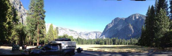

    Yes sir, I have an FWC Eagle on my '10 DCLB. We just got back from a trip out to CA and back with no problems. The V6 pulls it fine. You've already done the suspension mods so you shouldn't have any problems there. I'm running OME Dakars w/AAL and Ride Rite Air Bags w/Daystar cradles. You'll want load range E tires. The braking is a little weak but I changed over to SS brake lines and that helped quite a bit. I'll be doing a front brake upgrade (rotors/pads) soon.
    As mentioned above checkout the Expedition Portal and Wander the West, tons of information there. Let me know if you need anymore information. Good luck.

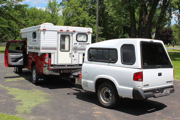

    I found a 1990 Scamper in great shape a few years ago, these were built for S10s/Rangers with a 6' box. The seller had used it for years in his 1st gen Tacoma. It sits on a frame in my box that raises it the 1.5" needed to clear the box rails. It's snug but I can close the tailgate (and still use the back up cam) when I'm hauling it. It runs about 1000lbs so Ride Rite air bags were needed to support it.
    I've used it in both my old 2009 DCLB Sport and now my 2013 DCLB SR5. As another poster mentioned Load Range E tires are a good idea for this application. Last year I took the 2009 with camper to western Montana (no trailer) and it handled the trip very well. I did notice more wear on the rear tires than the front after I returned (not Range E tires, Geolander HTS). The truck had to work hard on a couple freeway mountain passes but otherwise cruised along with a couple mpg loss. Nine nights were spend in the camper and I slept very well even at rest stops.
    A camper this size would not be good for serious off roading. I take it on fire roads with the occasional partial washout and it does fine but with 30-40lbs in the air bags the back is pretty stiff.
    This is the only shot I have so far of the camper in the new truck. We're about to head off for a long 4th of July weekend trip. The trailer is nice for totting all our gear (2 kids, 2 adults). I could have packed it all in the camper but prefer to spread out the load when possible. The truck did fine but you do notice a little more downshifting on the hills but nothing to slow the trip.
    When I get all the pictures rounded up I'll be doing a write up of my new and improved system for mounting the camper to the truck.
    Here is a photo of it in use from last years trip:

    Round house, I made the same trailer out of my '98 extend cab S-10 years ago and actually have it for sale for $500, just need to get it out of my driveway. I only use it for storage now and need the space. Mine is titled as a trailer which was a pain in the ass to do in Pa. which from what I understand you can't do anymore. I've had a couple different caps on it over the years.
