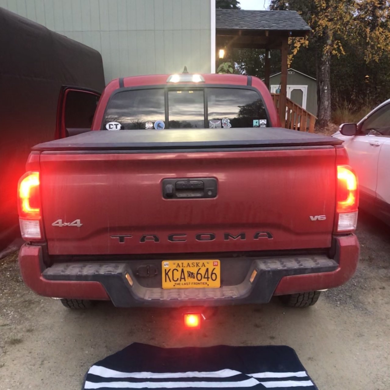

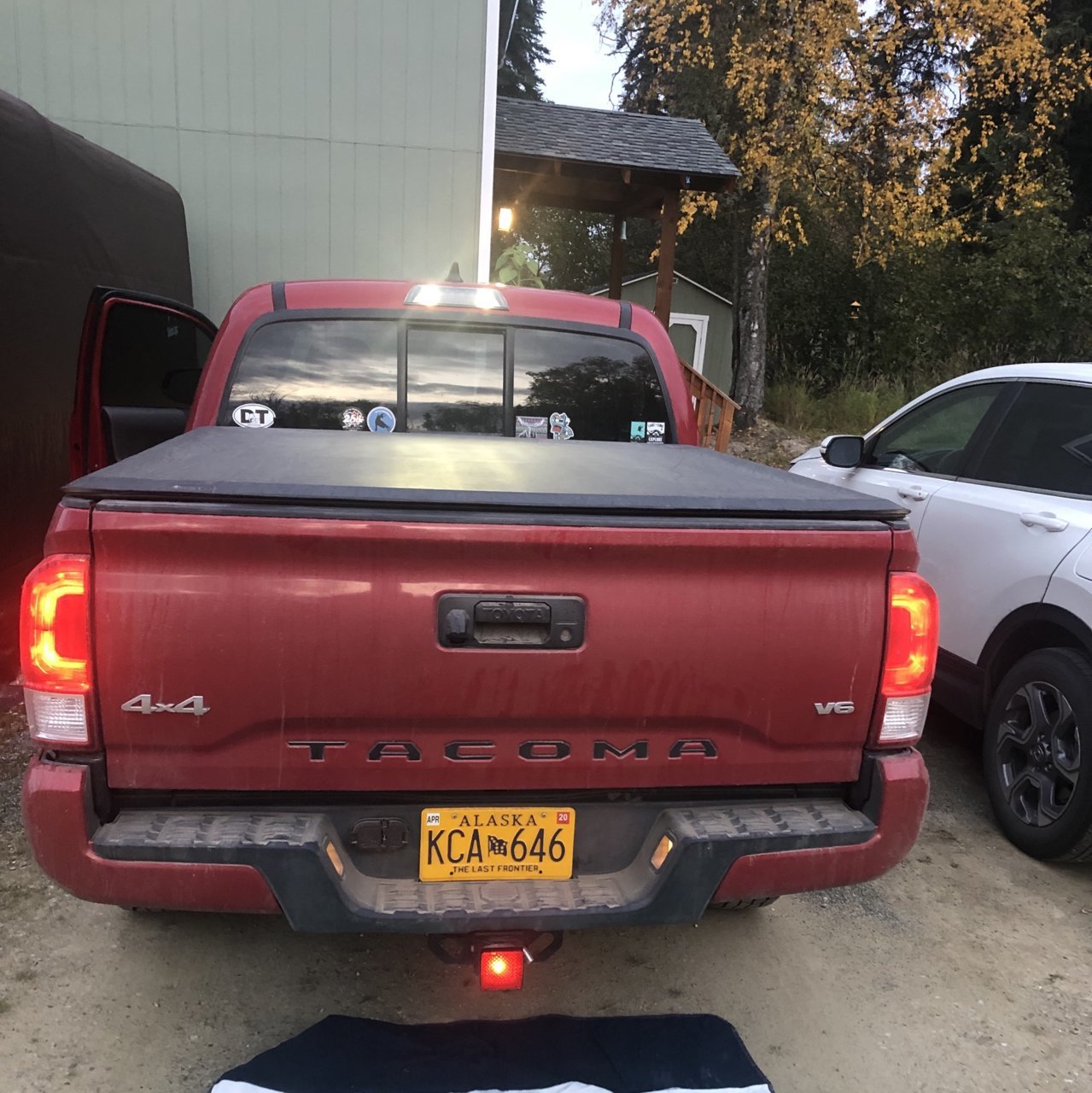

    Did a search and found this old thread. I’ve got the same light, but instead of an LED I swapped in a 2357 bulb in place of the stock 1157. It’s higher wattage and significantly brighter. Not sure how it compares to LEDs but I wanted this setup for winter driving so for me the heat from an incandescent is useful to keep the light clear of snow. My wife had followed me home and said the extra light makes me a lot more visible when snow is blowing around.
    I also just added a curt trailer T harness so I could wire the hitch light independent of the bumper plugs for a cleaner install.
    CURT 55384 Replacement Vehicle-Side Custom USCAR 4-Pin Trailer Wiring Harness https://www.amazon.com/dp/B0009FJ38Q/ref=cm_sw_r_cp_api_i_TziDDb21BDMHM
