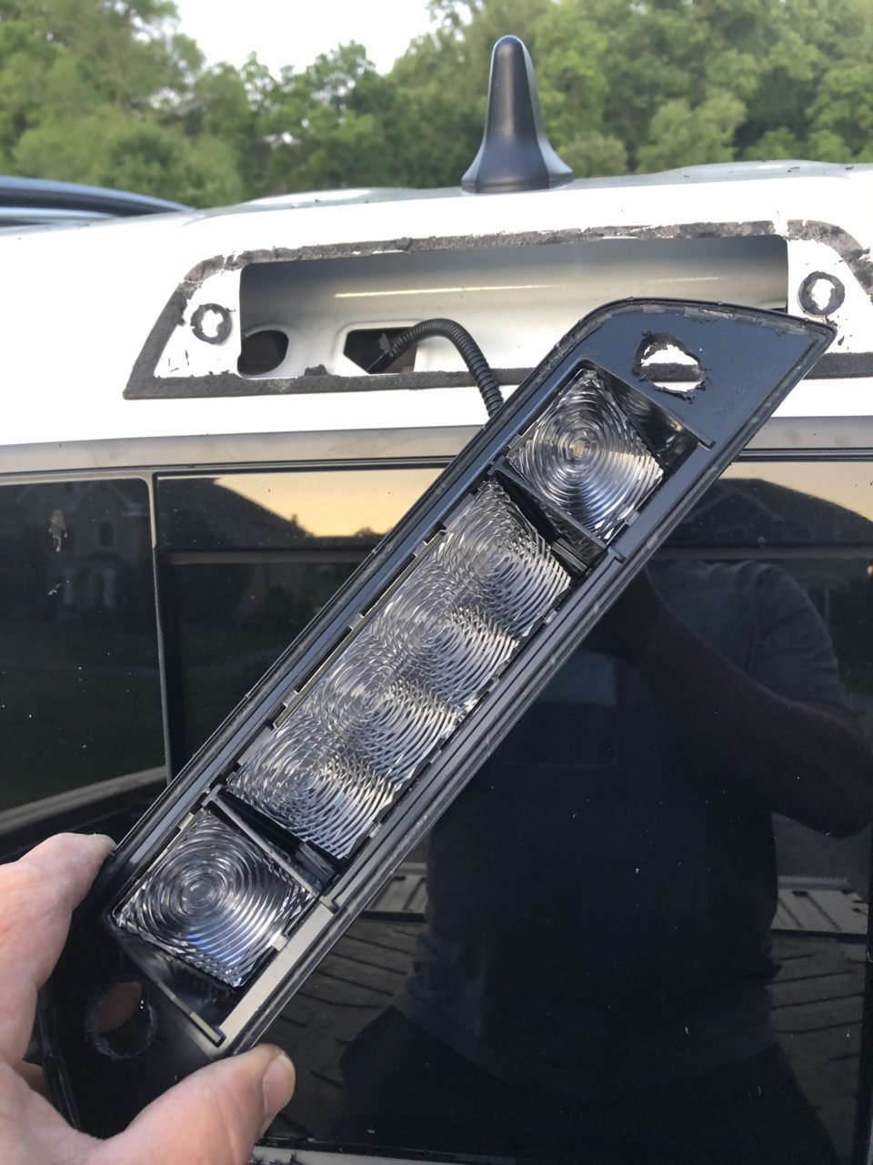

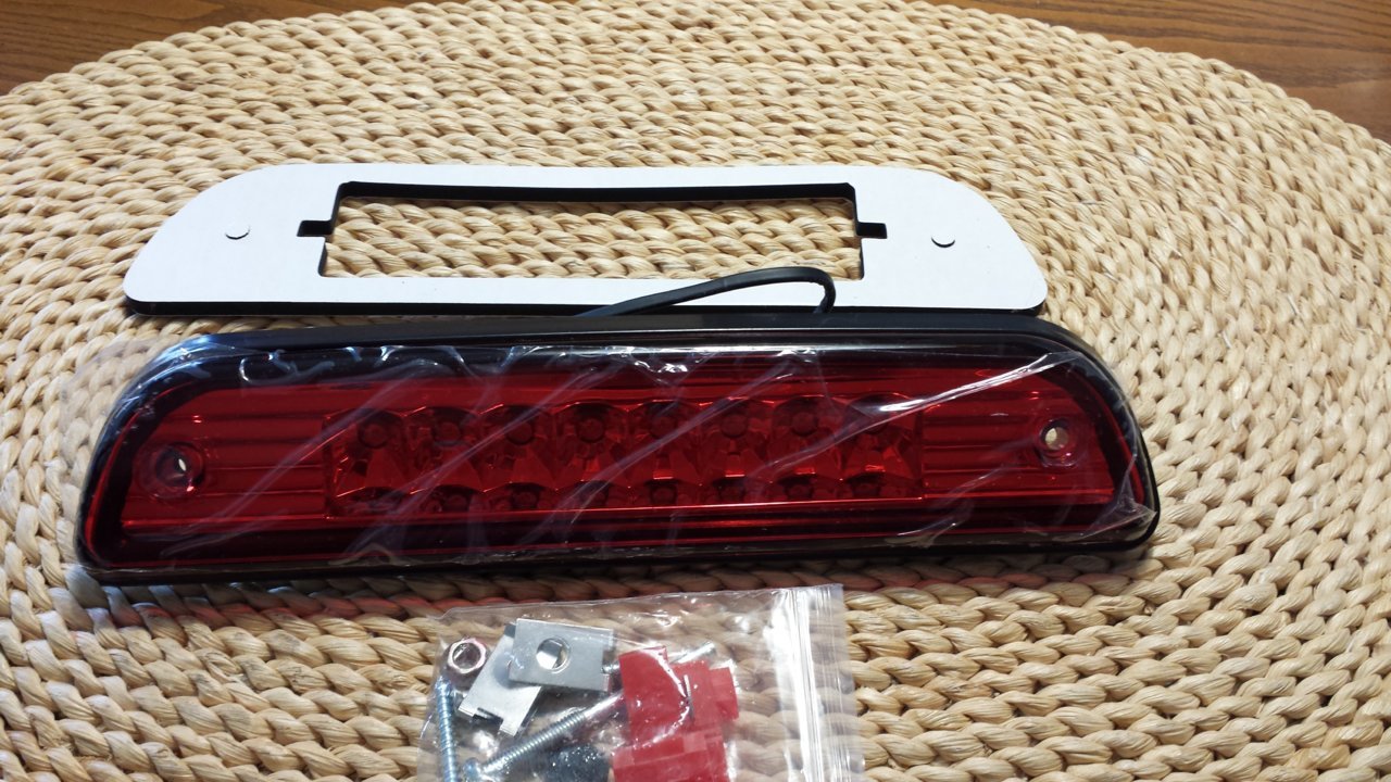

    Here's what I got.
    It appears to be of decent quality. WARNING: It did not include instructions. It did have some extra mounting hardware, which I did not use.

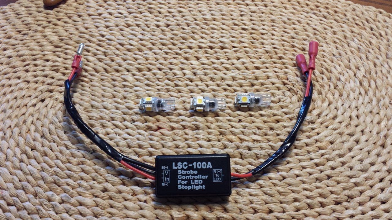

    Here's the strobe module.

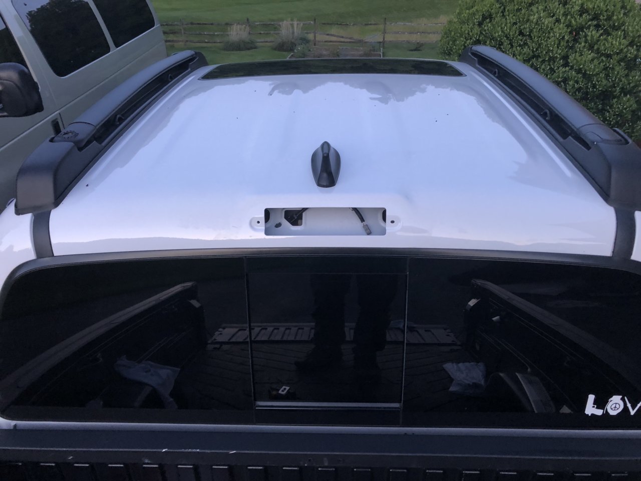

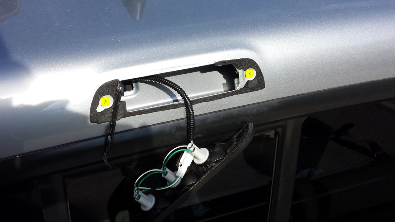

    Installation was easy. The toughest part was getting all of the adhesive from the foam gasket off of the cab. Goo-Gone to the rescue.
    I unplugged the original light and this one plugged right in its place. Worked first try.

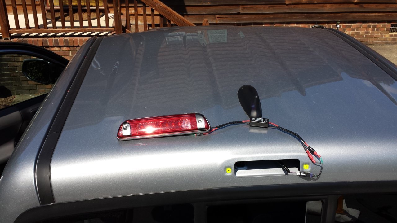

    Then I spliced the strobe into the new light's pigtail.
    Note: The truck's wiring was not modified.
    The finished product:
    It looks good, and between the LEDs and the strobe module is much more eye catching.

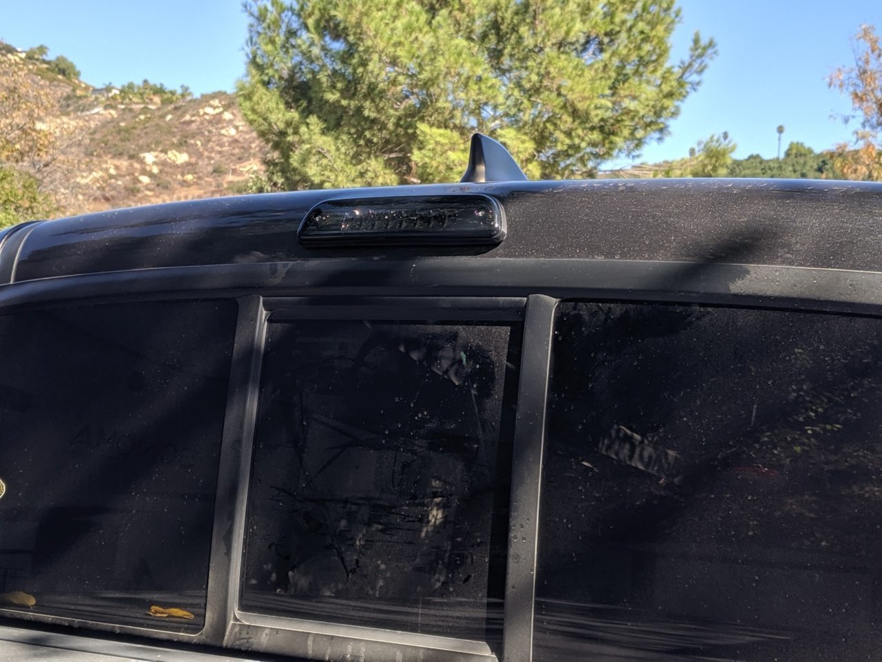

    I just wanted to say that you can find anything on TW. I wanted a cheap replacement brake light and found this post. I got the smoke one, and took a chance because even though everything in the description said for a Tacoma, when you select the smoke option it comes up as for a Dodge ram. A glitch in the system because it is definitely for a Tacoma. I just installed it today, and it works great!! Thank you!

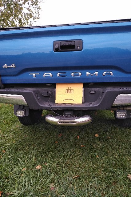

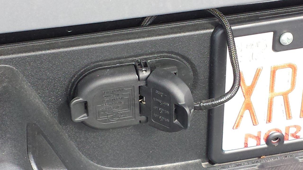

    I decided to add this unit to my receiver hitch. Going to add an additional 4-way plug in behind so I can route the wire underneath the bumper.

    @oostroma , Back when I first did my Auxiliary Lights, I temporarily ran the plug's cable behind and over the bumper.
    Well, here we are about 6 months later and the "temporary" arrangement is still in place. I never even notice it, so it's likely to stay that way. o_O
