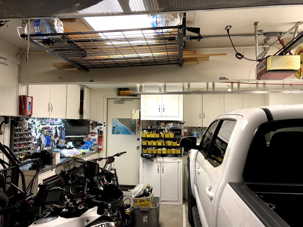

    Look where the eye bolts are in the 4 corners. Now look at the 2x4 in the back. So I remove the grated platform and attach the eye bolts to the far outside holes of the 2 x 4s (flipped over). The 2x4s have the addition (step, aka notch) to keep from lifting on the exterior of the shell (don't want to crack the gelcoat). I want to lift on the part of the shell that touches the top of the bed.
    RZ Rob

    Interesting, okay well next time it's in action IF you remember, try to snap some action shots.... I'm challenged in this situation when trying to use my imagination. I think I understand your concept.... but yeah :D :oops:

    I don't have the shell (or truck) anymore, but you can log-in to http://www.watchyourstuff.com Username = demo Password = Password1! and see the rack. I can give you a live demo tomorrow after work. It worked great and I liked that I could remove and install shell by myself.

    I wasn't able to watch the video, do you have any more pics of the notched 2x's?

    Just consider that you want to pick up the cap from the interior perches that rest on the lip of the truck bed without touching the overhang of the shell that runs along the outside of it. The idea is that if you don't pick up from the part of the shell designed to handle the weight of it, you could crack it, or at the very least damage the gel coat. Pretty logical.
