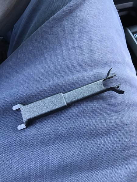

    Hit a large dip at speed and this fell out of the headline / roof. Could not see anywhere it possibly came from

    rear view mirror wire cover

    man i looked at that area and didnt see how this fit even when collapsed.

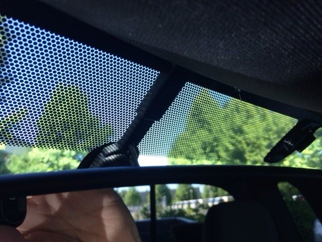

    Looks like a tight fit! Must have been a BIG dip!

    ahhh shit, i was looking on the backside of the mirror.

    the bottom part closest to the mirror mount clips in and the top fork slides un between headliner and glass. Mine kinda rattled until I slid it in all the way.
