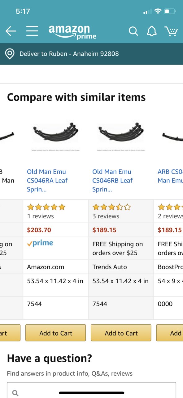

    Interesting... Do not have these springs but do plan on getting them in the future. Just checked on Amazon and the dimensions for those specific springs say 53.5 in....B48DB51A-57E6-4C91-80B3-C502AE37AC75.jpg I know for a fact those springs work and are specifically made for our trucks... Very weird.

    Don't go off Amazon specs... Not always accurate.
    Again, correct part numbers for our trucks. Leaf springs are not the issue. It's the dealer service department in OPs case.

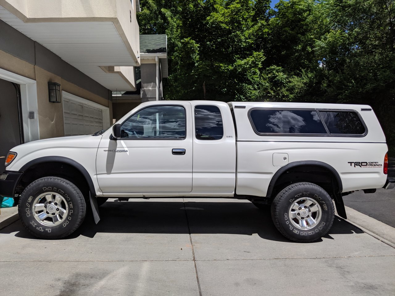

    Ahhhh stoked. Next step new wheels and some KO2s. Same size preferably. Any recommendations?
    Thanks again all

    Good to see that the tech figured things out. That looks really good :thumbsup:
    You may end up lowering the front a tiny bit as the rear will settle a bit after some time. That way things stay level.
    If you go with bigger tires, I'd get a 3 degree shim to offset the rear axle a bit.
