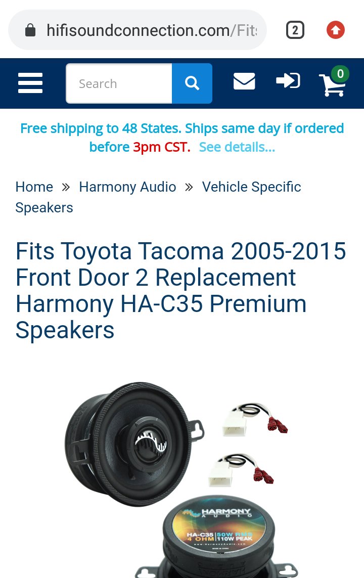

    Screenshot_2020-01-23-22-01-01~3.jpg I've no experience with these particular speakers but they claim to be direct fit OEM replacement size w/ plug&play installation..$50 free shipping.

    SO... problem... If I disconnect the tweeters, my door speaks stop working. When I reconnect the tweeters, the door speakers come back on. My door speakers have built in tweeters so I don't need the factory tweeters. Anyone know why this is setup this way or what I can do to fix it?
