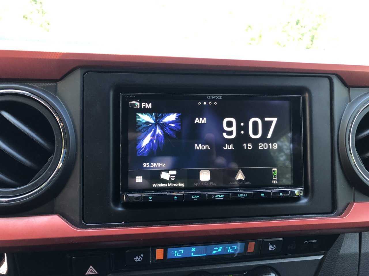

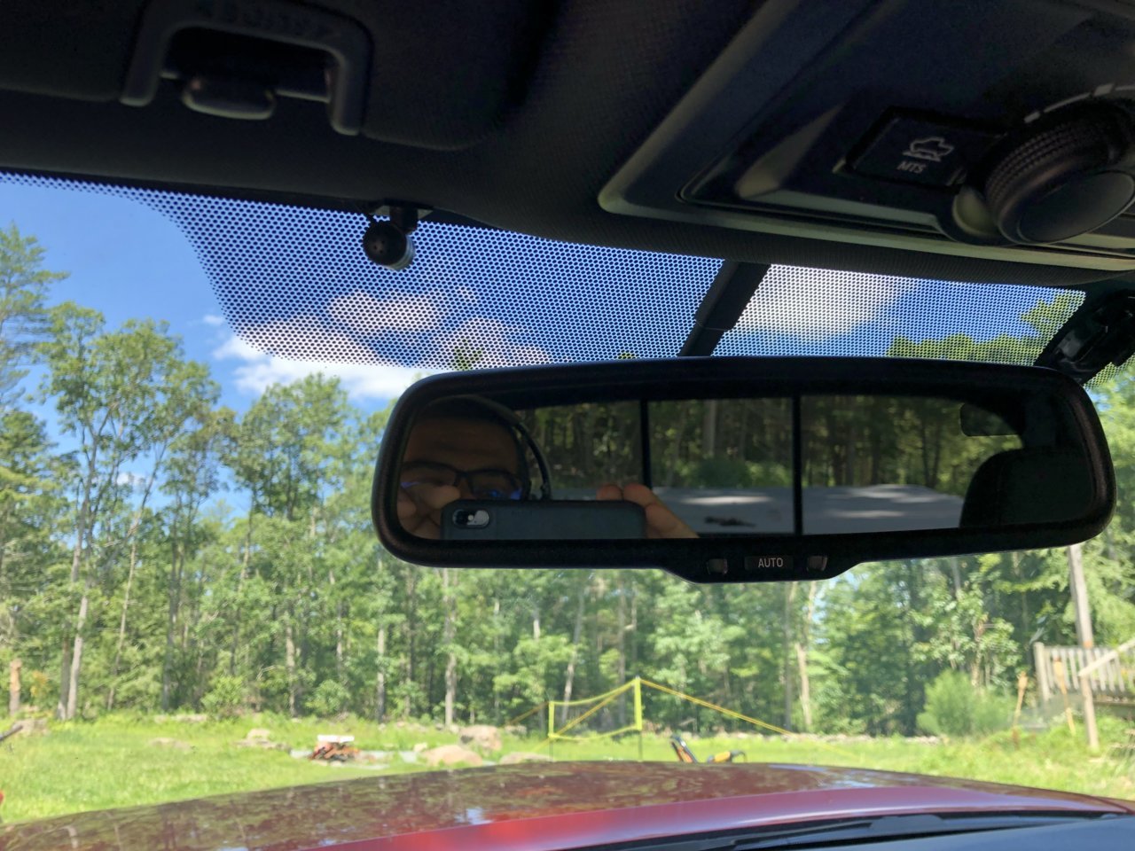

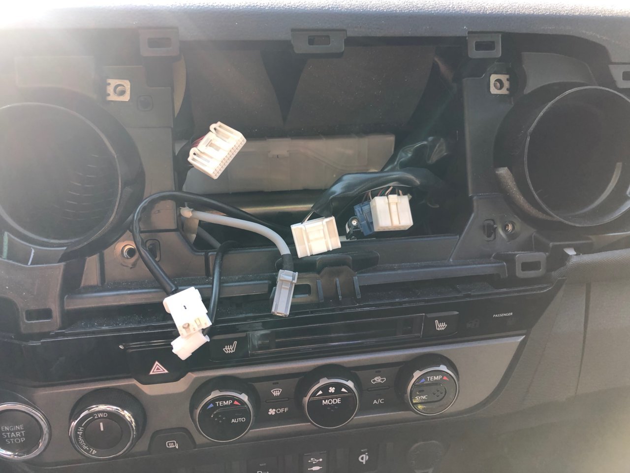

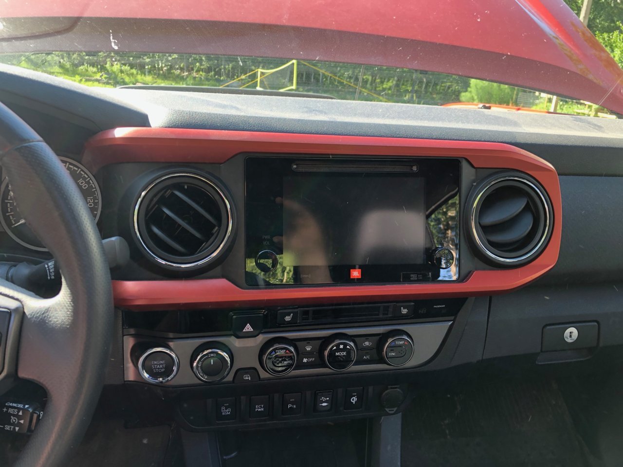

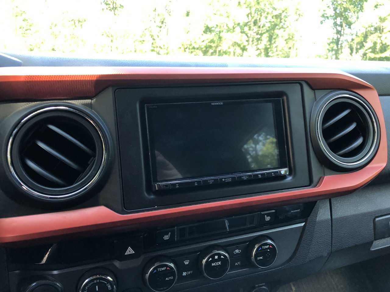

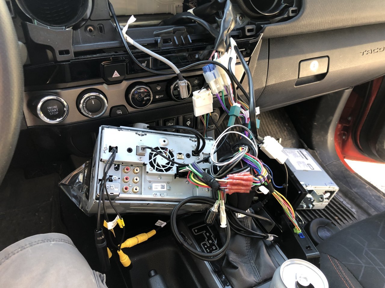

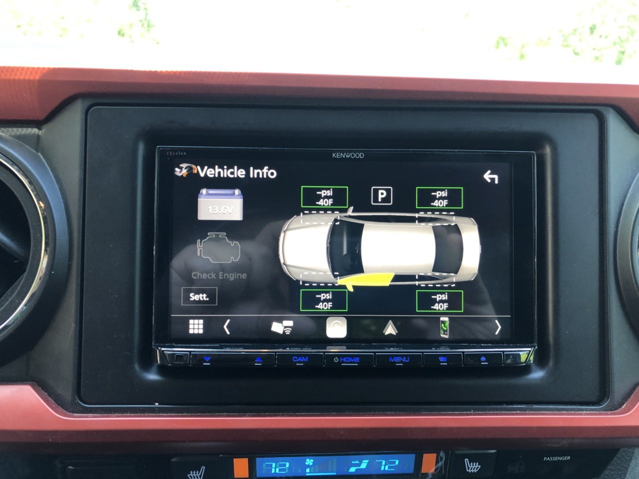

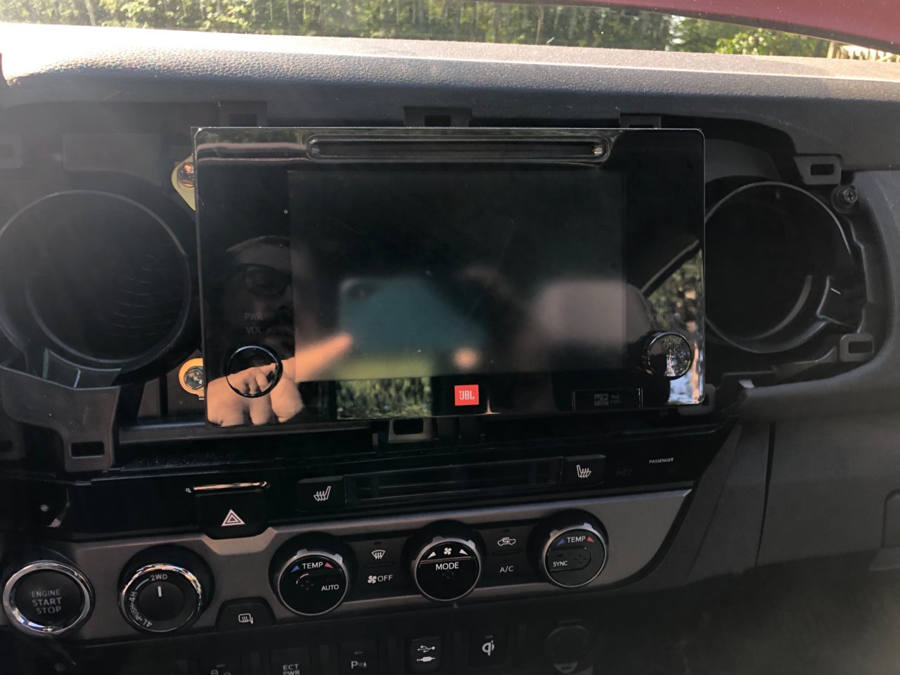

    Well I went with the 9906XR as it has a higher resolution screen and I didn't opt to pay the extra $500 to get Garmin GPS given I never would use that with CarPlay as an option. Few lessons learned:
    1. Flashing the Maestro - when I tried to just turn off radar detector option and progressed along I discovered that it was turning off other options including factory amp. So I left settings to all on and then it flashed properly
    2. I could not get the GPS adapter to work so I just stuffed the GPS antenna into the dash
    3. ran the provided mic up to top of my windshield - would have preferred to keep OEM but overall this looks good and I like the fact that it is pointed directly at me - will see if others notice any improvement.
    3. Overall given I had Crutchfield do the harness wiring it was basically very plug and play once I got the maestro flashed properly
    A couple of picture below.IMG_4802.jpgIMG_4801.jpgIMG_4800.jpgIMG_4803.jpg58480584185__3268D664-0B2E-41F9-983C-1C4F4CFA562C.jpg

  11. Jul 17, 2019 at 8:14 AM
    jLEE028
    jLEE028 Well-Known Member
    Jan 25, 2017
    #208581
    519
    MKE
    were you able to keep the navi in the screen between the speedo and tach?
  12. Jul 17, 2019 at 9:15 AM
    NewfTaco72
    NewfTaco72 [OP] Active Member
    May 14, 2019
    #293277
    28
    Brian
    Narrowsburg, NY
    2017 Inferno TRD OR DCSB
    None....yet
    I went with a 9906xr - which gave me a higher quality display but no navigation - so I don’t know - wasn’t worth $500 extra for a Garmin system I wouldn’t use. All other screens and features work perfectly.
