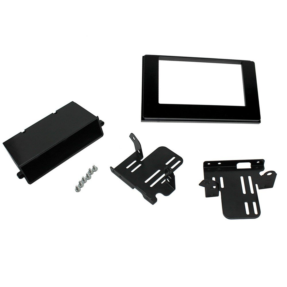

  3. Aug 18, 2019 at 9:44 PM
    #23
    BearWithMe
    BearWithMe Well-Known Member
    Jul 7, 2018
    #258617
    484
    Four Corners
    2025 OR 6MT Celestial Silver
    Prior: '18 OR 6MT
    It's kind of a mixed bag -- Scosche makes a bezel for the Entune Premium headunit (TA2121B), but it positions your aftermarket double-DIN very high up in the opening i.e. your radio isn't centered vertically in the stock opening. I think it looked really goofy (see photo below). As far as build quality, Scosche uses metal brackets (Metra is 100% plastic) and their bezel is just hard plastic with some texturing. I didn't mind that at all, but the Metra has some sort of soft-touch paint on the bezel that I kinda like and it seems very durable. I tried scratching it with a fingernail and couldn't.
    So, I like how the Metra 99-8251B centers the radio in the opening, but as others have pointed out, you will need to shim the bezel with some washers in order to get the Metra bezel flush with the Toyota radio bezel surround. It took me three washers in three corners, and four washers in the bottom right. Frustrating since it's kind of fiddly trying to get the washer stacks lined up behind the Metra mount. Ended up gluing the washers in each stack to each other in order to make them easier to manage.
    Just to be clear, the gap is between the Metra bezel and the OEM surround (the one with the vents), not between the Metra bezel and your new radio. No problems there. I don't see that any adjustment of the radio mounting holes would affect this. I think it's just poor measurement by Metra when they designed the part.
    Even having said all this, I kept the Metra and returned the Scosche because I thought the Metra looked better.

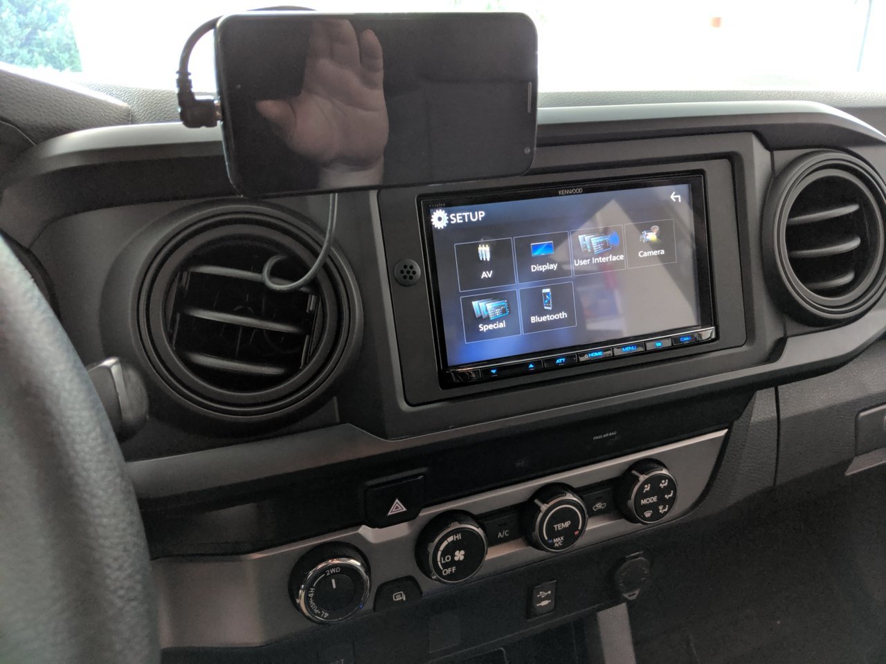

    How did you mount the phone here - looks tidy.

    Did you drill out a hole in the Bezel to mount the Mic? That is a good idea if so, any issues with people not being able to hear you etc?
  8. Sep 2, 2019 at 11:41 AM
    #28
    auskip07
    auskip07 Well-Known Member
    Jan 1, 2019
    #277665
    4,298
    Skip
    Atlanta, Ga
    2019 TACOMA SR V6 SC , 4X4, AUTO, 4.88, 265/75 r16
    Yep, took the stock mic apart (be careful those solder joints are not sturdy) measured got close with a bit then dremeled with stone bit until the cap snapped in fit. No complaints ive called a few people since and no one has complained i also called my wifes voice mail and used different levels of voices and i was loud and clear on the recording.

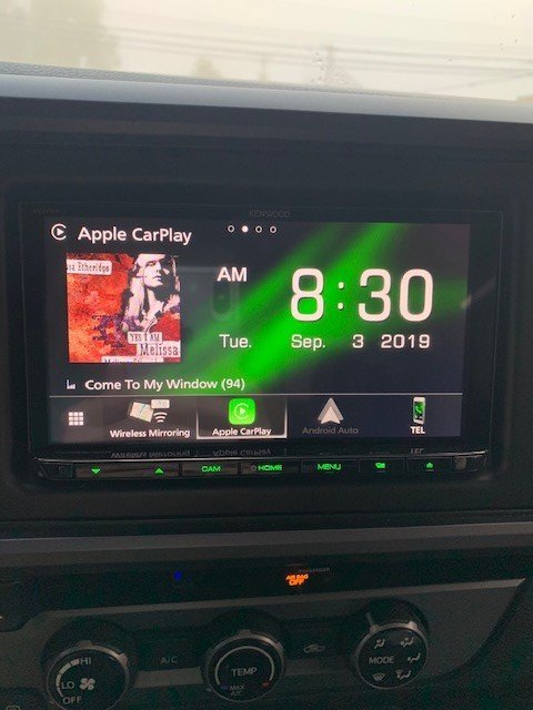

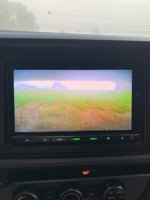

  19. Sep 3, 2019 at 7:41 AM
    #39
    MassAppeal16
    MassAppeal16 Well-Known Member
    Jan 18, 2013
    #95489
    424
    Carrollton, KY
    17 TRD MGM DCSB
    Oddly enough I was looking at reviews on Amazon and there was a guy commenting on there that he had the best prices. I thought I would text him and see what was up. Turns out he owns an audio store in Texas and is a Kenwood retailer. He answered a bunch of my questions and hooked me up. Just sent in my paperwork for the rebate this morning. Below is a pic of the screen with wireless carplay going... and the other is of the front camera I added. It looks fuzzy but it is from the fog and the lighting when I pulled into work. Crystal clear driving to work.
    auskip07 likes this.
  20. Sep 3, 2019 at 11:13 AM
    #40
    MassAppeal16
    Jan 18, 2013
    #95489
    424
    Carrollton, KY
    17 TRD MGM DCSB
    Has anyone figured out how to activate the backup camera on command? I cannot seem to find that function. And now that I think about it... can we take that text off the top of the screen in reverse? Takes up the whole top of the screen.
