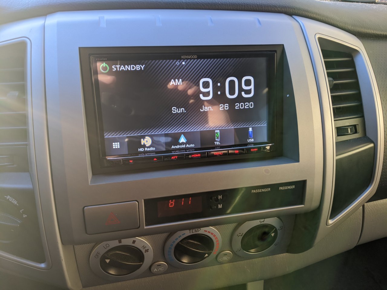

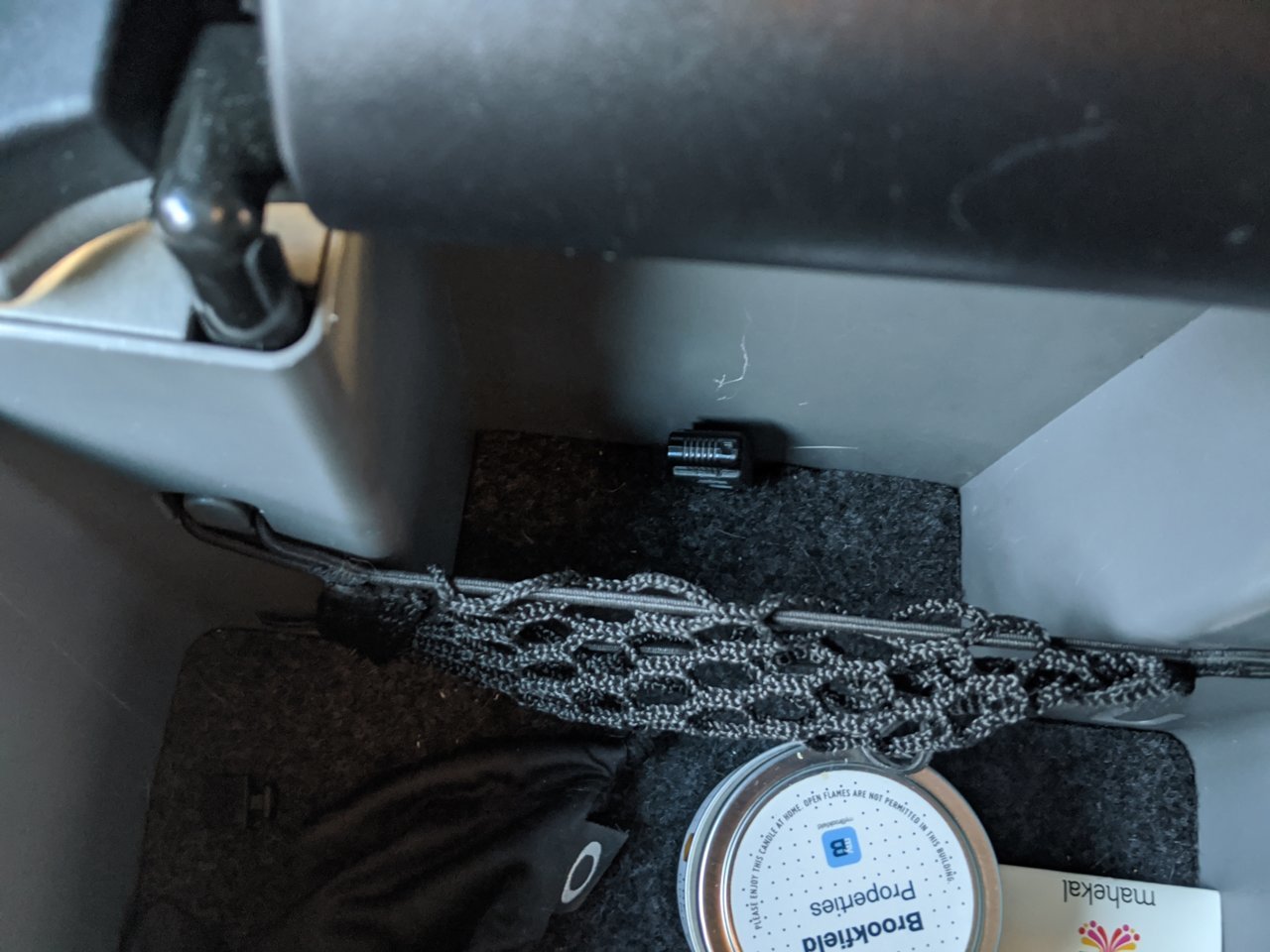

    Hard to get a shot without sun glare, but I hope that one works. It's with the Schoche TA2053B kit. The USB, I had a 5ft. male to female laying around, so I checked if it worked for pairing. It did. I ran it down, under the console, and up through a pre-existing hole under the armrest compartment. YMMV.

    that’s top notch sir!! How do u like it so far? I’m excited about it

    Looks like it fits nicely with the scosche kit too! It comes with a surround face frame piece on the unit too right ? I actually have the metra on my current aftermarket unit and bought a scoshe one to see if i liked it better for this next head unit. Pumped to get this vehicle into the next century lol.

    Works great. Still getting the hang of it, I'm used to single DIN units, the screen throws me a bit. The sound, the sound is miles above my old Alpine. I’m really happy
    Yup, comes with a trim ring, to finish it off nicely. Solid mounting, and the color match is great. You won't be disappointed by the Scosche one.

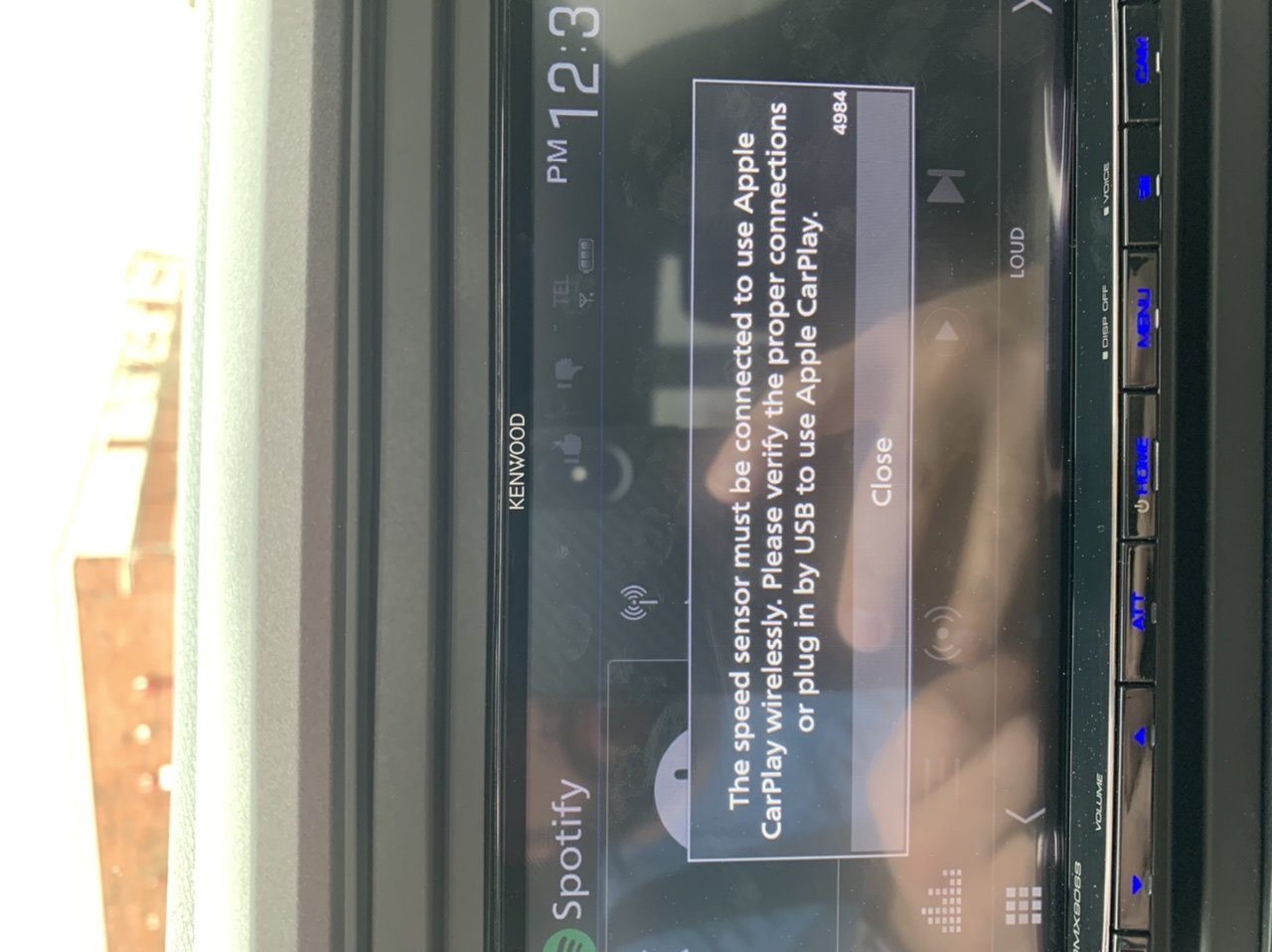

    Any have this issue after install? I have a 17 taco I installed a DMX906S. Did I forget to hook something up? Never saw a vss wire from the kenwood headunit to solder into from the toy2 harness.

    Your good bro, what you have to do is update the software that bypasses the speed sensor, you can find it on kenwood site under firmware update, just look for your model and you will be good after, did the same thing to me as I have the exact same radio.

    https://www2.jvckenwood.com/cs/ce/mm/firmware/2019/2019p/eng.html
    Here you go bro, interesting thing is that despite that message, kenwood doesn't have speed sensor wire so go figure.

    Thanks bro, your suggestion worked perfectly. I would of never guessed that, thanks again no more random camera turning on.

    Yes, this rattled my brain seeing that there was no wire coming from the kenwood harness. Anyways thanks for the help it fixed my problem!
