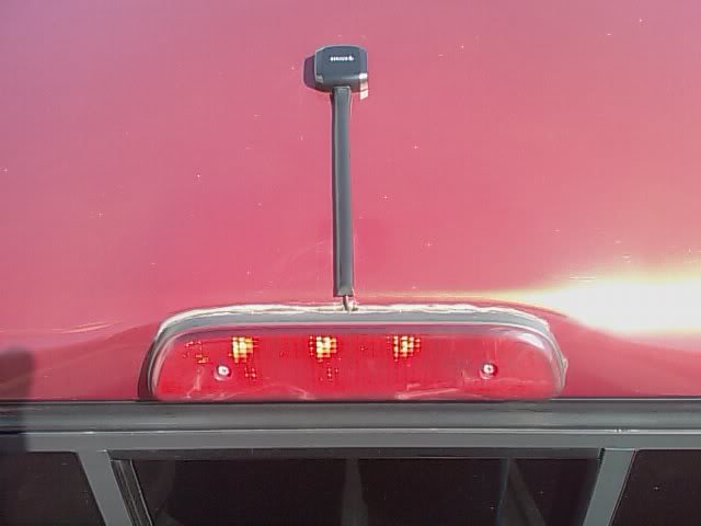

    Just installed through the brake light yesterday. There is enough space between the light assy and cab for the wire. The gasket is not sold alone, so be careful when prying the assy off. Once off you can just run a bead of sealant around the remainder of the gasket and screw the whole thing back in place. No drilling required.

    Sirius antenna routed through the 3rd brake light in my 02. Sealed w/ no leaks:

    Only thing I might do is get some black sealant someplace and run a bead around the light. The clear sealant I used looks kinda messy if you look through the small gap between the light assy and cab.
