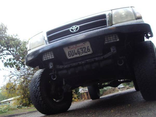

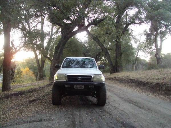

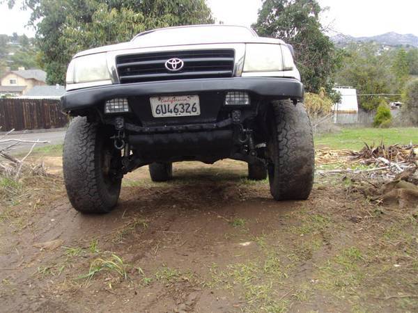

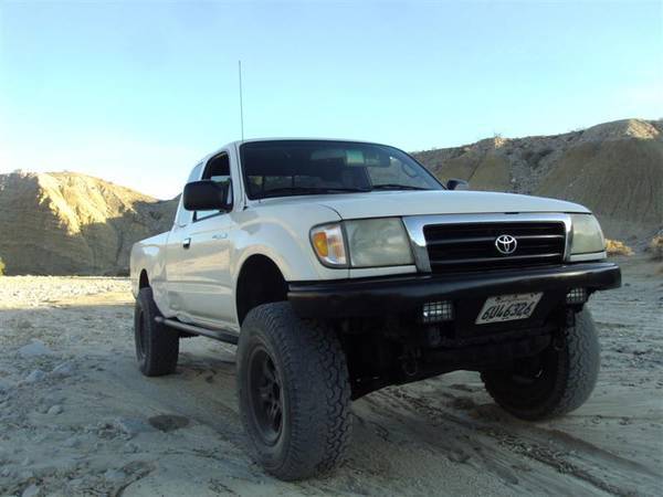

    I've got a 2000 with front bumper off of an '02 & its a straight up change out, nothing to cut,bens, or fab, bolts right up & the plastic valance un screws also, very easy...

    Is that a sheet of metal or what that is above your stock skidplate ? I'm wondering how to get my valence off do I have to snap any of those stupid clips? Or is it all just bolts. Also, did you remove the solid metal brace that attachs to the front of the frame? it's like two or so feet long.. I like how yours looks, since there's that extra piece of skid whatever it is it makes it look like a custom front bumper. but cheaper. I also have two shackles hanging from mine just like you do, going to buy some chain tomorrow :yay:

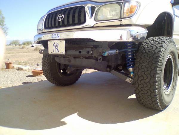

    Removed valence, crush cans and factory skid plate mount. made a new mount out of some c channel that gave readitor protection and a really solid skid mount. also added blinkers for a temp. use.

    What you see is a piece of steel mesh off of a giant server rack, super strong, & it passes alot of air to the radiator as well as protection & believe me I've landed from jumps with it, ran straight into banks with it too, so far has held up, I didn't have a piece of metal spanning the frame heads on mine..

    Yeah, theres about 8 screws i think, somewhere in my build thread theres some pics ... but its easy
